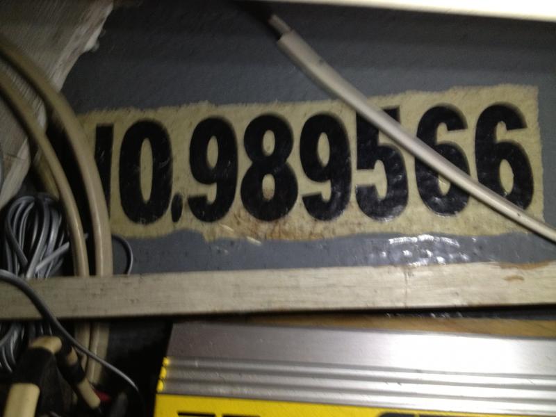

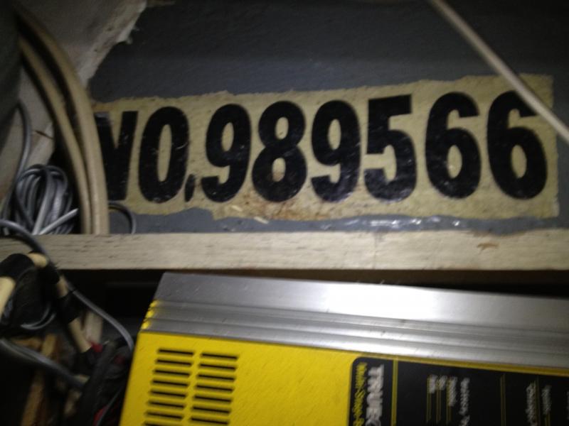

I found a # under the aft quarterberth, starboard side on the inside of the hull I didn't write it down, I will take a pic and post next week

Pominville....If you have big numbers like that (Starting with "No") use that link I previously posted. Those numbers would be mounted on wood or epoxied to the hull or encgraved somewhere on the boat if it was ever documented. Sometimes you'll find them in the storage area under the settee or under the quarterberth.

Thanks Jack;
Coriolis was indeed documented in Washington, she was on charter with Anacortes Yacht charters until 2006, when she was brought to Horseshoe bay and essentially stored there until I purchased her in 2011. The original charter ad is still online, you can find it when you google catalina 30 pics.
