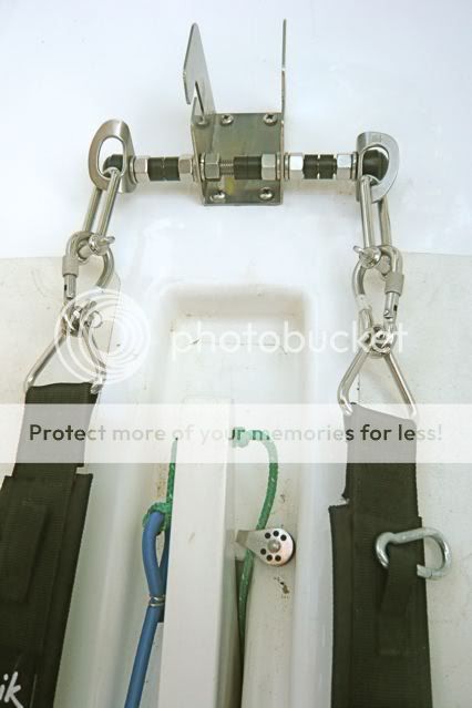

Re my hiking strap solution, the main challenge is to find anchor points fore and aft to attach them to. Up front I am using the mast step but for H146/H15 owners it is aft that presents the design challenge.
The H170, with its open transom offers access to the rudder support for rear anchor points but the H146/H15 only presents you with a hollow dam and minimal access to the inside of the hull. I saw the main design challenge as being able to spread the load of the weight of 2-3 adults over as wide an area as possible.
Removing the entire rear inspection hatch allowed me to fit one arm into the boat and touch the transom walls. See attached for what it looks like in there. What you are seeing is the underside of the cockpit drain and the forward wall of the transom. By using a webcam I was able to see what I was doing when working in there (got that idea after my knee op).

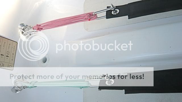

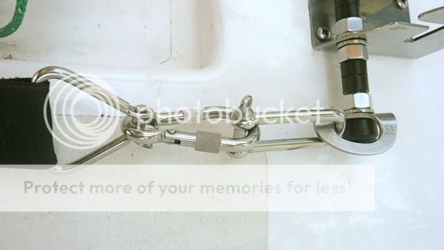

I constructed my aft anchor points from strap aluminium and a solid tube of teflon plastic cut into thick disks (see 2nd pic attached). The bolt that goes through the anchor, teflon disk, transom fibreglass wall, ali straps, etc never actually touches the fibreglass of the transom wall. The bolt is surrounded by a thick, long nylon spacer as it passes through the transom wall. This spacer is rebated into the white teflon disks to keep it in place always (see 3rd pic).

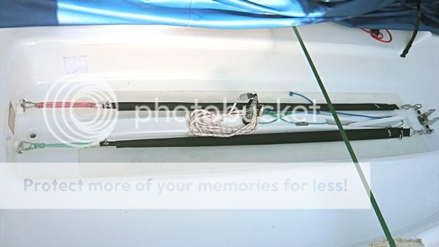

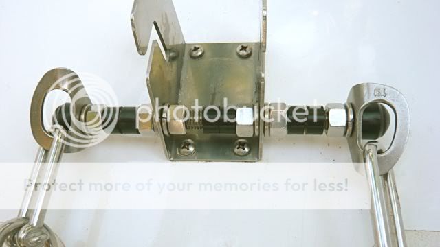

The 4th pic shows what it looks like inside now and the 5th pic is the view facing the stern from inside the cockpit. The aluminium things are mountain climbing thingo's.

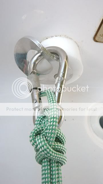

Also for straps I am using Zhik Hiking straps made for NS 14's which are about 6 feet long (6th pic). These straps have a special underside material that really grip sailing shoes and boots.

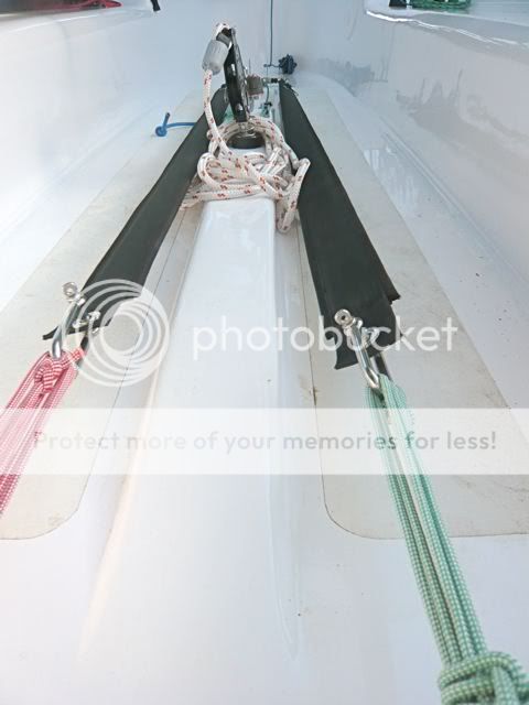

The initial photos are below in thumbnail form. Here are the shots of the final setup:
