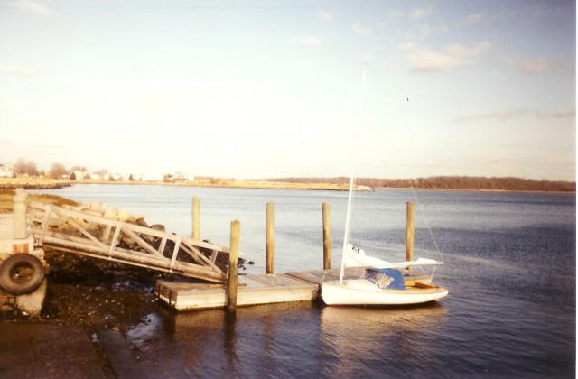

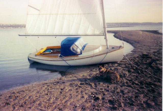

Here's some pictures of my old Sturdee Cat boat. I never had an engine on it and I would sail that boat for miles. If the wind died I would just paddle it. In my state, a boat without an engine under 16' didn't have to be registered and I also owned my O'Day 222 which was registered so I opted to sail engine less. Now, if I can only figure out a way to drive to the club in my truck without paying $4.00 a gallon for gas!:cussing:

I paid $2500 for that Catboat with the trailer and no outboard. The guy was asking $2700 for it back then. That convertable top came with it, plus a cockpit cover. It was a fun boat but it could be capsized if you weren't careful.
One winter about a week before Christmas, I put it in the lake next to my house and sailed it. There was a thin sheet of ice in some parts of the lake and I had my Origo Heat Pal stove placed in the bow of the boat and it was giving off enough heat to make it very warm and comfortable in that cockpit with the convertable top up. All I could hear was the hull crashing through the ice and I hoped that the wind would keep up so I could sail back to the ramp or I would have to use my paddle to get back.

PS: Joe, I like the dodger on the Sturdee Cat! I recognize that ramp too..... my Dad and I used it a few times while exploring the Taunton River with our 14' powerboat. Kind of a steep road to enter/exit though! Not to mention the road going by is one-way now.

PS: Joe, I like the dodger on the Sturdee Cat! I recognize that ramp too..... my Dad and I used it a few times while exploring the Taunton River with our 14' powerboat. Kind of a steep road to enter/exit though! Not to mention the road going by is one-way now. (Quote)
That dodger came with the boat, along with a back cover. It was a fun boat but it could never measure up to a sloop of that size.
That's the Somerset Waterfront Park ramp. My favorite cove on that river is right across from that park just to the right of the old railroad bridge abutments next to the golf course. If you see a sloop with polytarps and a green kayak anchored in that cove, that's me.
I trailered my O'Day 222 to that ramp for 8 years straight and years ago I sailed out of there to Cuttyhunk Island and Martha's Vineyard. I also sailed to Block Island from that ramp. I had my wife bring my car and trailer home each time. I always thought that they had the best ramp in the area. It could be used at any tide.
