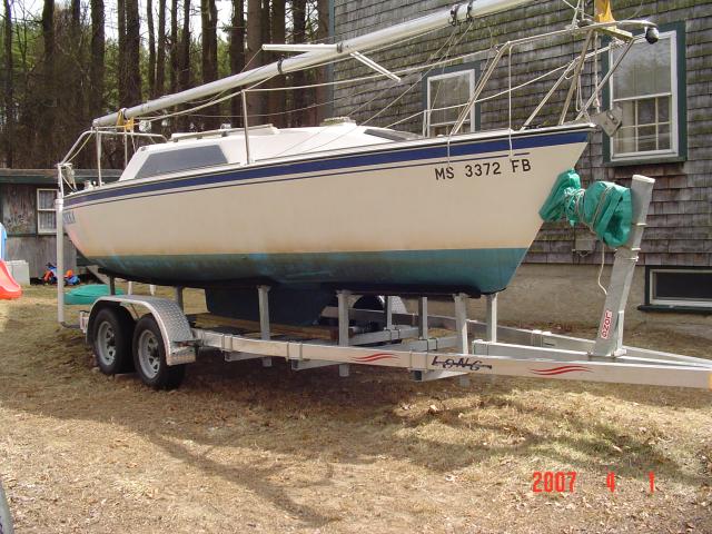

The O'Day 23 has a strong hull that can take a complete roller trailer but if you're only going to moor this boat, I would buy a tandem flat bunk trailer that will take a 24' boat which will take the weight of an O'Day 23. The trailer needs to have long bunk extension brackets to accommodate the keel depth. The reason I mention a trailer for a longer boat is because it may be easier to float the boat off it without having to buy an extension tongue for your trailer.

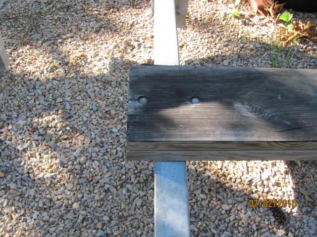

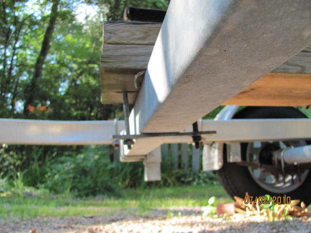

For instance, I was able to buy a new Long tandem Aluminum 23' powerboat Trailer for my 86 O'Day 222 at 4600 lbs and convert it to a sailboat trailer by using 24" extension brackets and two sandwiched pressure treated planks in the center of my galvanized trailer cross members. I used two power company electric hardware brackets to attach them and didn't need to drill holes in the cross members.

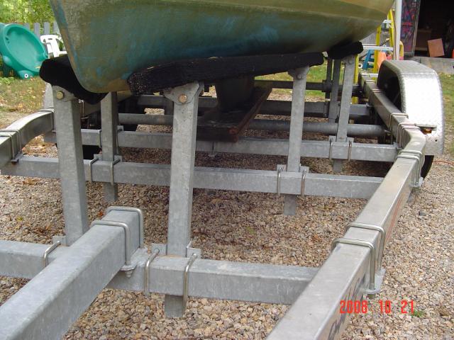

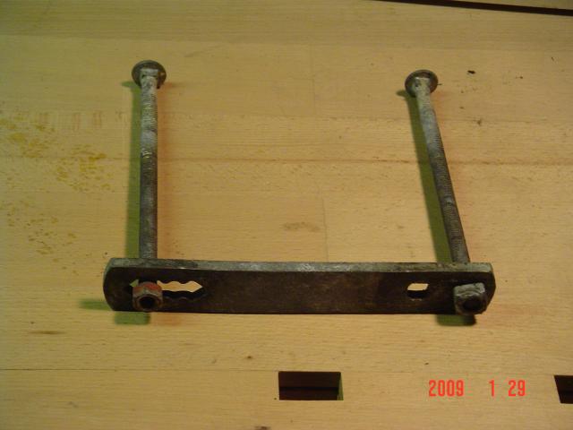

I'm able to float my boat on and off my trailer without having to swamp my pickup truck. Also, I'm able to loosen the carriage bolts that hold my keel boards and slide the boards to one side of the frame which comes in handy when I take my boat off the trailer and put it on my stands each year.
