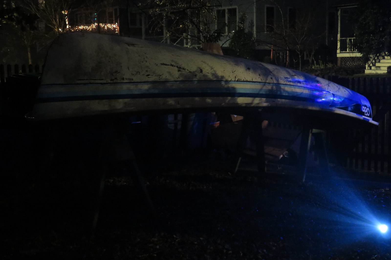

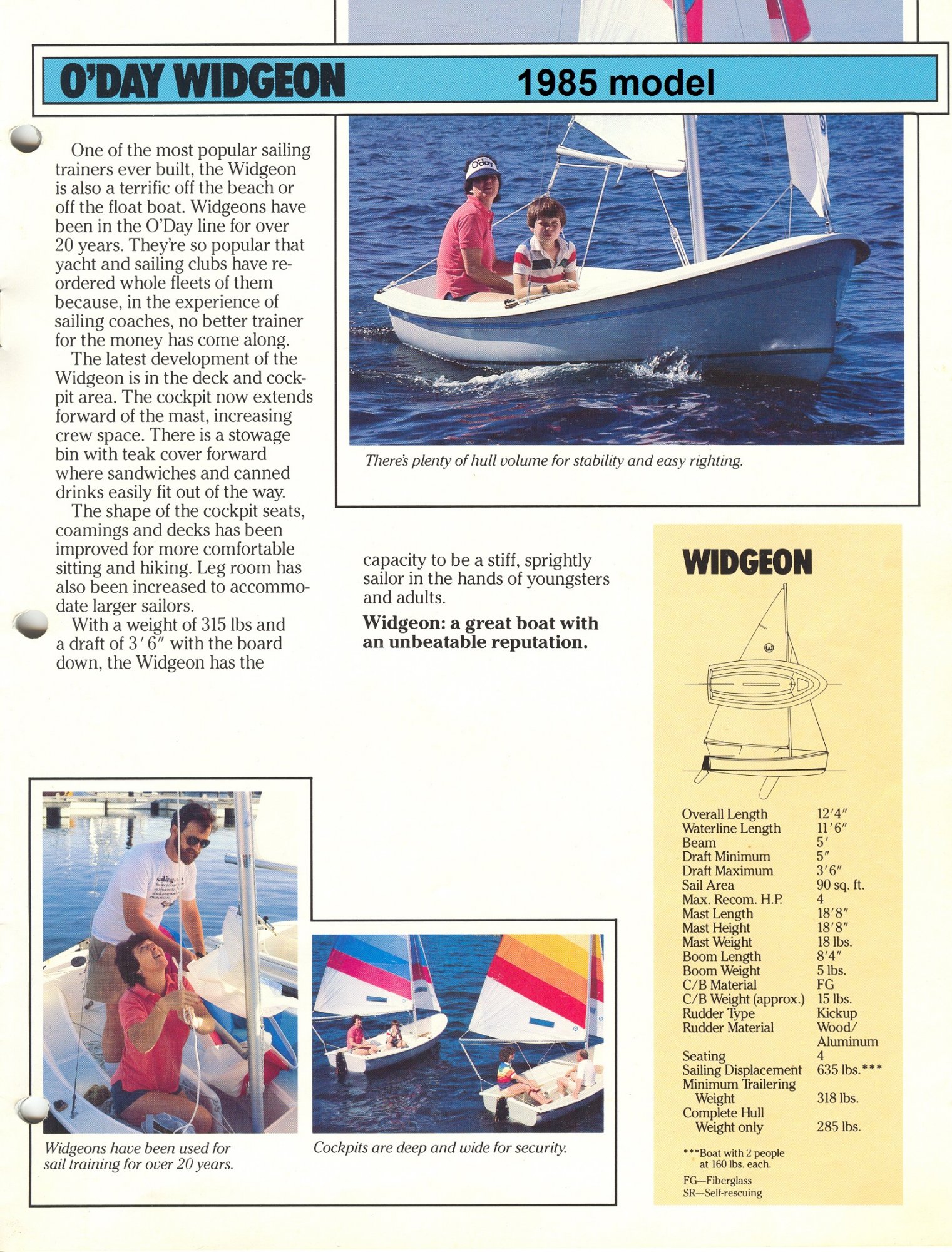

Thanks to both of you for the advice. Given that it is an 1985 model and it is approx the right length, I am right in thinking that it is a Widgeon - @Sunbird22358 - I think your previous posts, pictures, manuals, etc reinforce that it is a Widgeon, but mine has the very "1980s" striping too. I just have the attached night pic. I don't want to start getting parts until I am dead sure on the model.

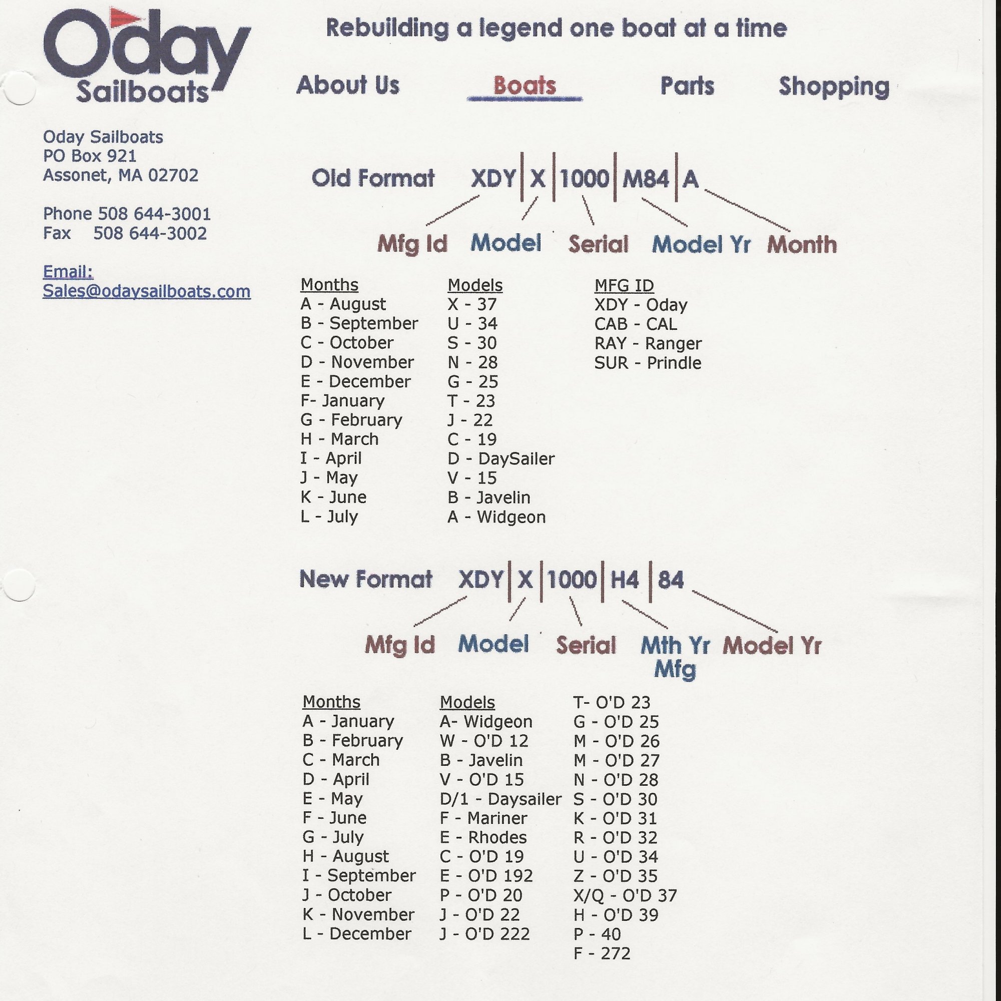

The "A" in the Hull ID number indicates that this is a Widgeon. Widgeon was a sloop (2-sails, also optional spinnaker), the O'Day 12 was cat-rigged (1-sail)
The O'DAY 12 was only built from 1976-78, so a 1985 model did not exist anyway, but that isn't widely known.
I have included a print of how to read the O'DAY HINs.
