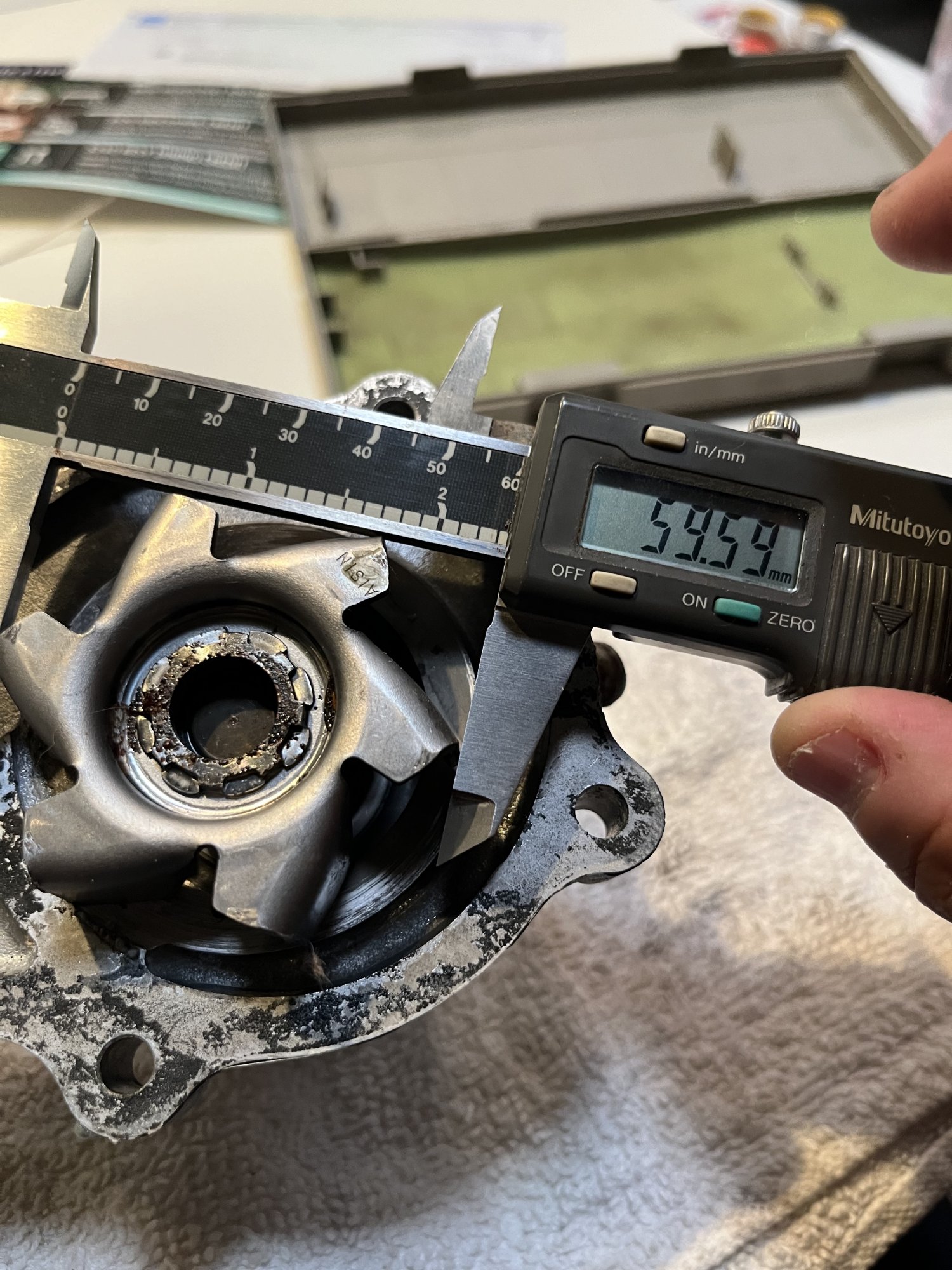

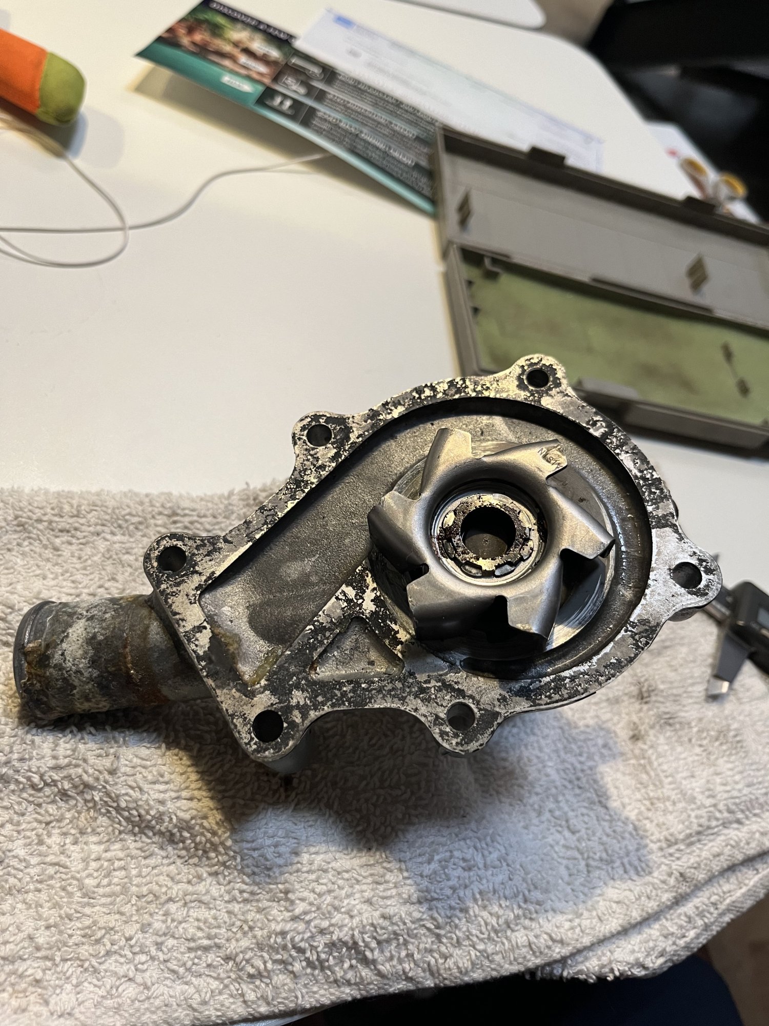

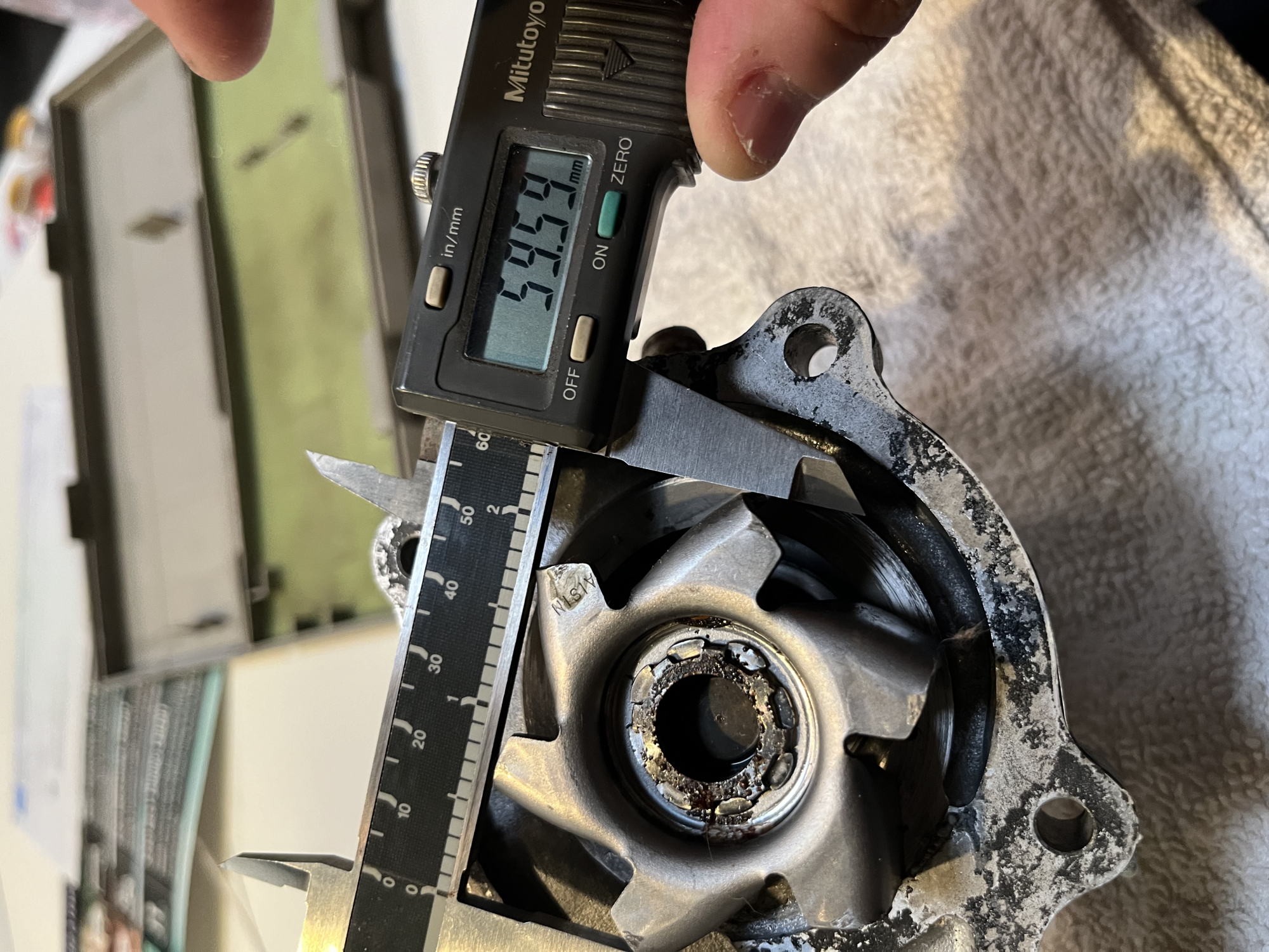

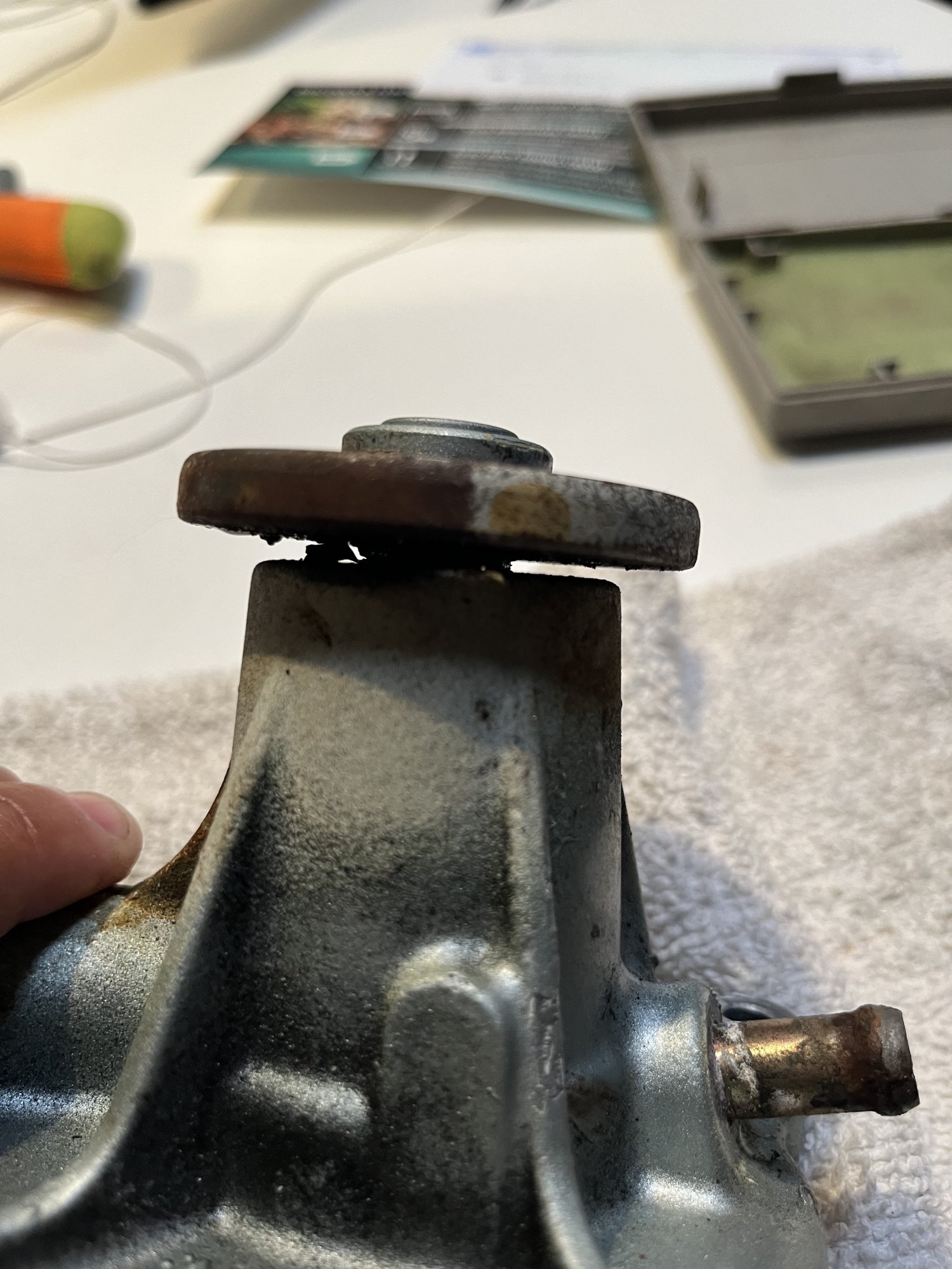

I'm attaching a few pics of the pump. I can't see well inside, but most likely the bearings failed. The impeller is out of center and stuck against the housing. I'm very glad this happened at low rpms. The pump is actually a 60mm impeller pump. Thanks again @jssailem for pointing that out. Part ordered already. I may end up replacing the alternator and a few hoses while I'm at it.

I see a little bit of wobbling on the fan blades when I spin it. I think it got hit by the belt when it started breaking. The wobbling is not much but visible when I spin it by hand. I'm thinking at 2000 rpm it might cause additional vibration... thoughts?

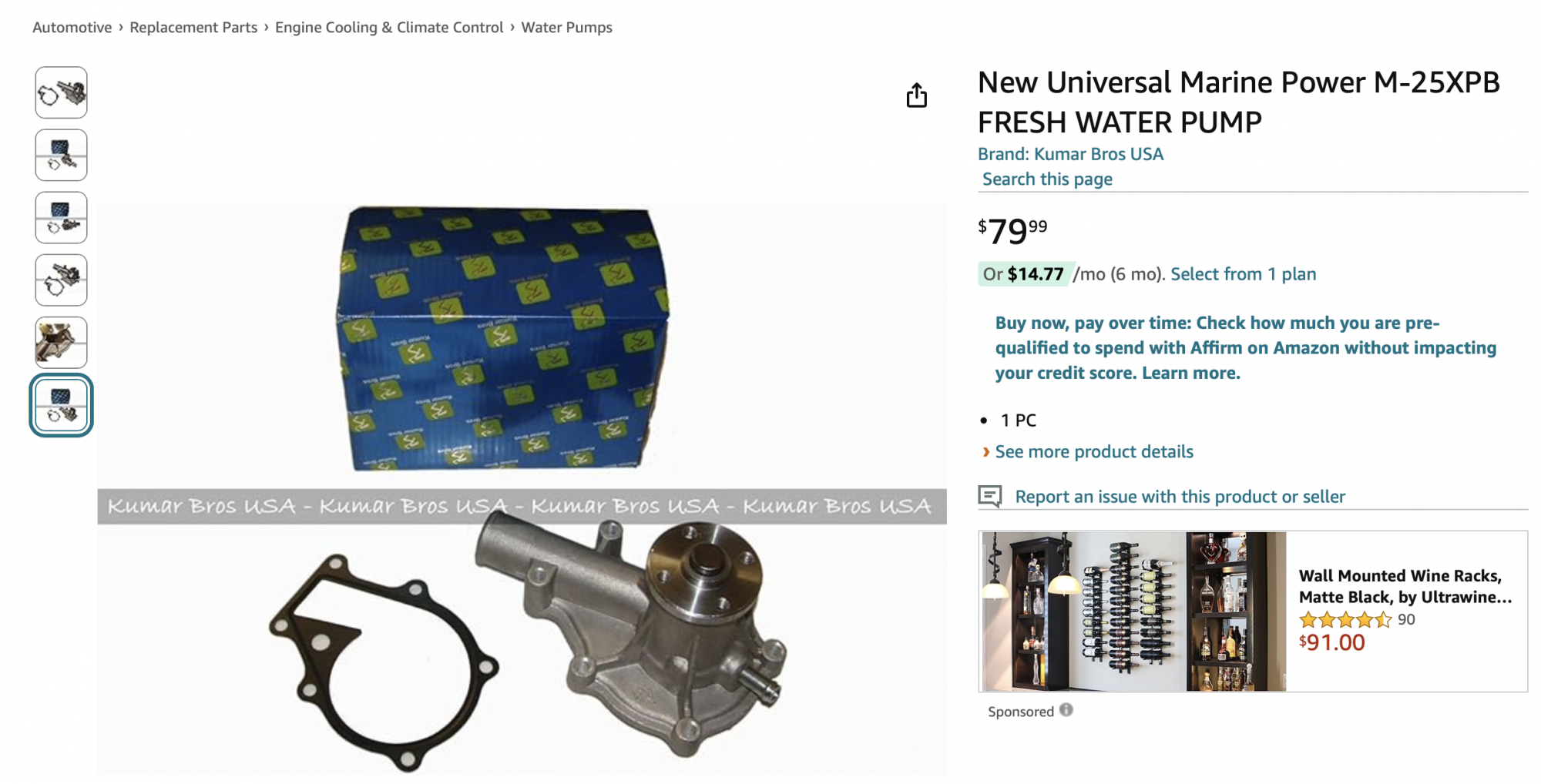

I found this one on Amazon and in a few sites for the Kubota D1005. It seems identical to the one from Catalinadirectdotcom. The price difference is huge. Am I missing something?
I replaced mine when the raw water pump seized, I just decided to do them both. The fresh water pump was on the shelf at a local Kubota dealer.

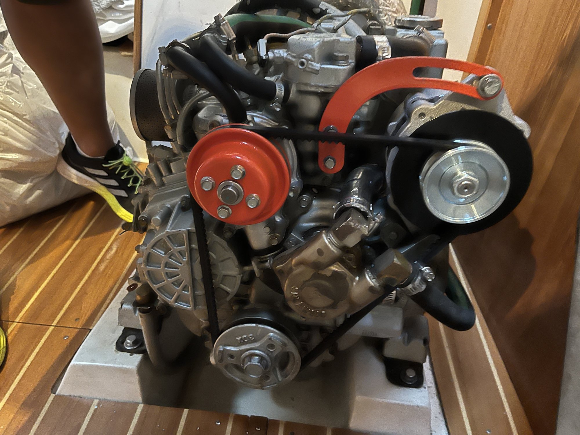

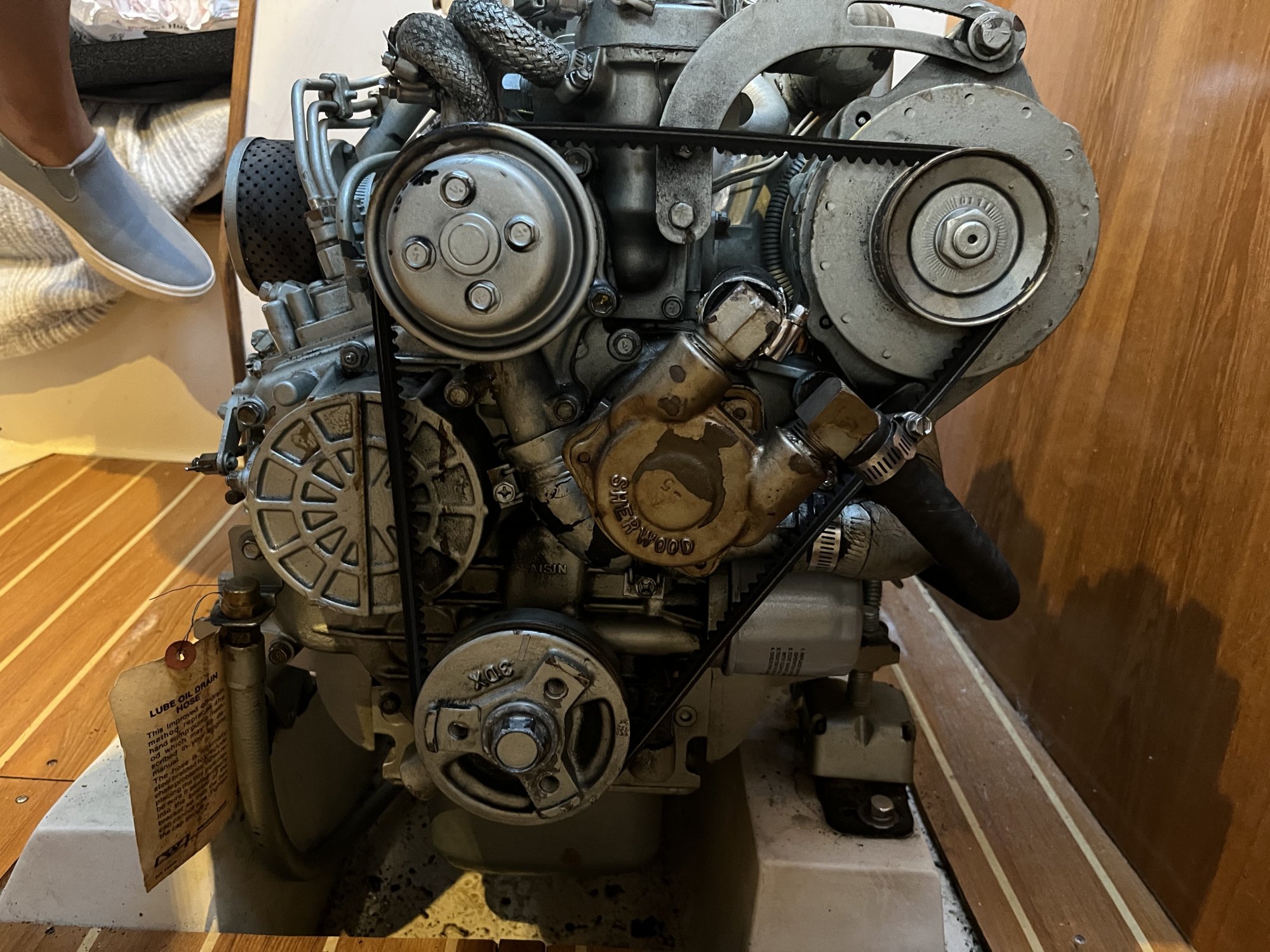

Thanks everyone for your help. I completed the work on my engine yesterday. Before and after pictures attached. I took the opportunity to complete a few more items I had on my list:
* Replace the zinc anode in the heat exchanger
* Sandblasted and painted the fresh water pump pulley and the alternator arm
* Replaced a few hoses
* Full flush of the engine coolant.
* New fresh water pump of course (60 mm impeller).
Friday Part Water Pump 16241-73034 16241-73033 16241-73030 compatible with Kubota V1505 V1305 D1105 D905 D1005 60mm impeller
* New belt
* And new alternator.
DB Electrical 400-46022 Alternator Compatible With/Replacement for MerCruiser Models and Certain Marine-Specific Motors, High-Output MerCruiser Alternator, Direct-Fit OEM MerCruiser Parts
I now have an issue with the belt tension. The alternator is at the end of the tension arm but I still have a bit of wobbling in the belt. The belt is a new Universal 40inches. I read a few threads here and must of them suggest to make your own arm so you can add more tension. Any thoughts?
