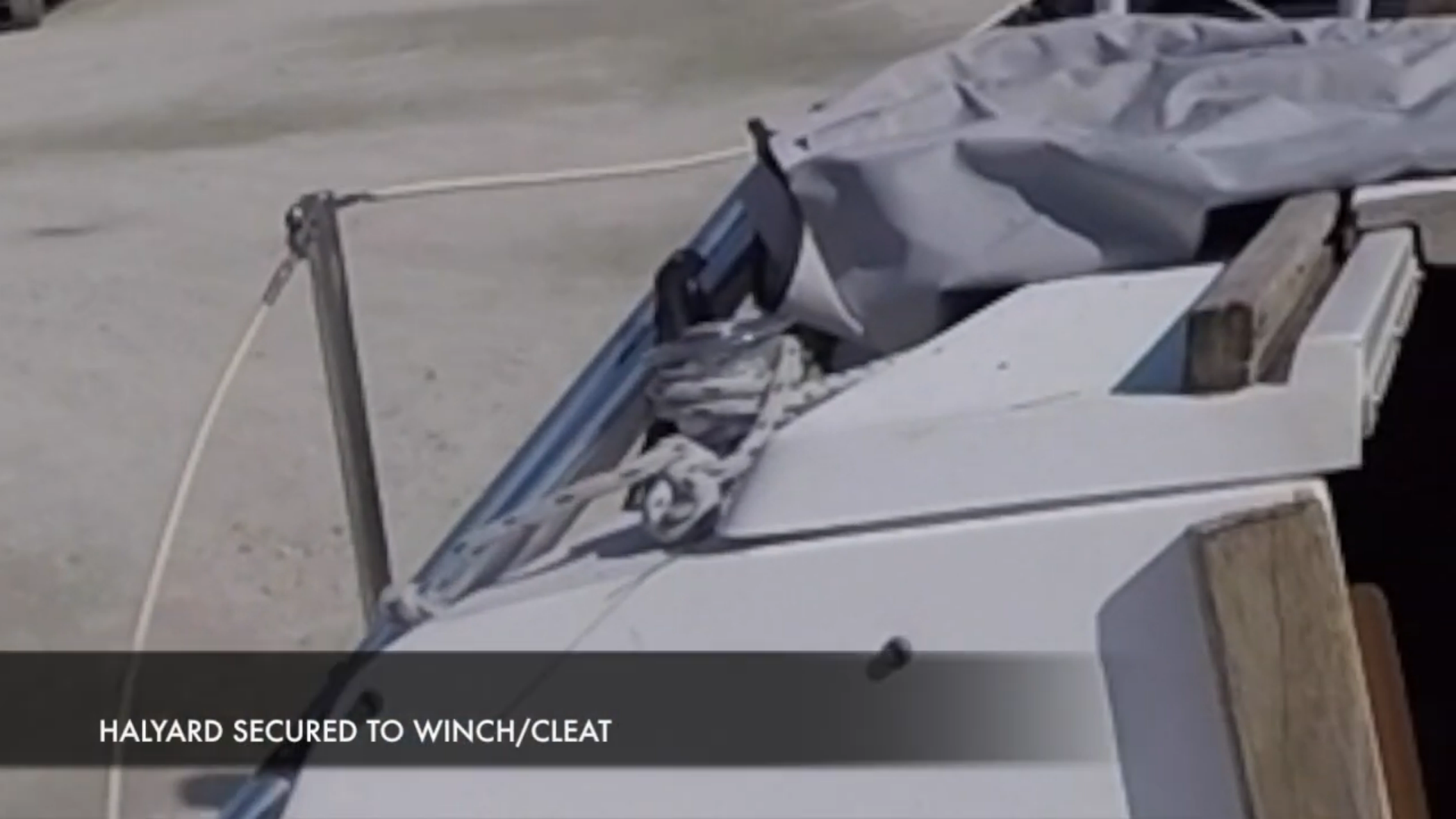

Last thing that's still bugging me...
Attached is a still I took from that video, when they mentioned tying off the jib halyard to the winch or cleat. This is what threw me. Does this seem wrong, to tie the jib halyard off at the winch on the side of the boat? I can understand tying the jib halyard off at the bottom of the mast on a mast cleat, but this image is what confused me?
Maybe someone can help me understand this part.

From the winch and cleat the halyard leads forward to the base of the mast, through a turning block, and up the mast. It doesn't matter where you tie off that end of the halyard, there are no forces pulling back on the mast.
