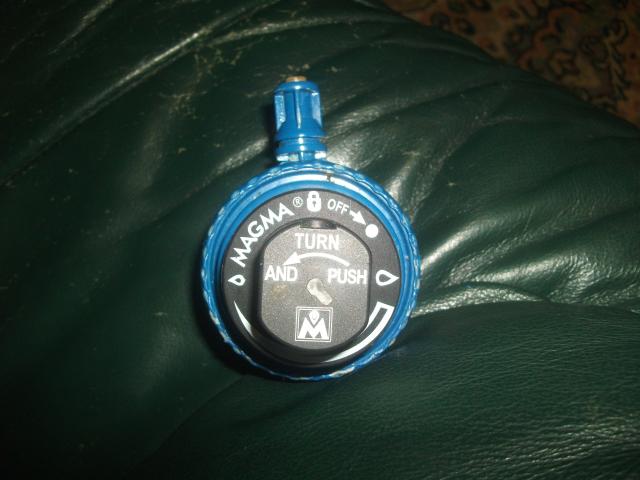

The valve I am using is in the attached picture.
Can anyone advise what the problem may be??

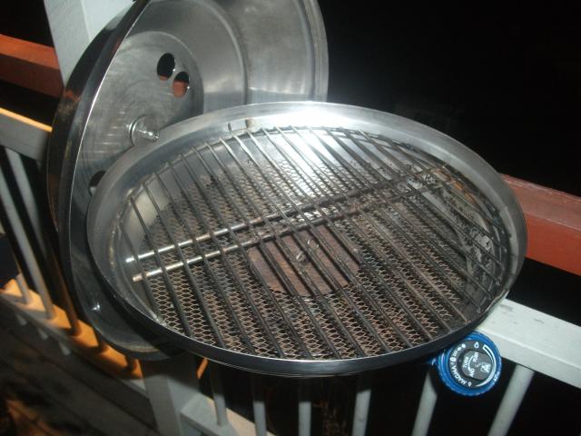

The Radiant Screen (as it is refered to in the Magma parts list) is made of fine expanded metal mesh and gets very, very hot around the edge of the 4" metal plate in the middle of the screen. I can't imagine it should be that hot otherwise the screen itself would burn through very soon. I have attached a photo showing the Radiant Screen with Cooking Grill above it - the ceramic briquettes have been left out of the photo in order to get a better view.

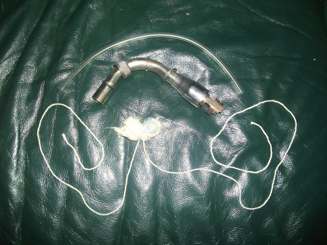

Thanks, your suggestion was right Frank - when I looked down the venturi it was like the Spanish Armada coming at me! Must have had spiders in there at some time and that explains why the Magma looked very unused.
Just for future reference of others the venturi lock nut screws off very easily from the bottom of the pan - I just used a pair of multigrips. I then poked a piece of plastic tube down the venturi and a piece of string down the plastic tube. After taking the plastic tube out I attached a piece of cloth to the string and pulled it back and through a few times. That didn't get all the cobwebs off the inside of the pipe so I soaked the cloth in acetone and pulled it back and through a few more times - then washed the venturi in soapy water. I have attached a picture of the bits I used. Will keep an eye open for a small venturi brush to put in my repair kit as it looks like I need to give the venturi a brush ever few months.
It was amazing the difference it made - Magma worked perfectly last night doing lamb chop, sausage, sweet onion (in foil wrap), sweet potato, potato.
