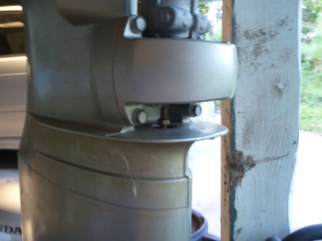

May 15, 2010
21
Hunter 25.5 Mandeville, LA
Thats pics I took when changing the impeller on my BF8D Honda 03 model. This is above the lower unit at the bottom on the shaft the motor turns left and right on. This takes 2 10mm wrenches. there is a small nut and a long sleeve nut. thread the sleeve onto the lower rod, then snug the nut to it. Check if it shifts properly as if you over or under thread the rod it may not synch. No need to remove any other parts if this is the problem.
