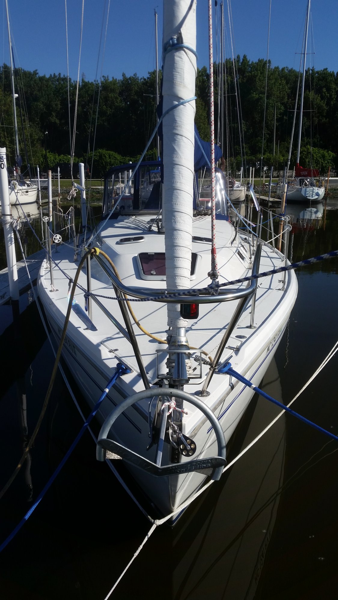

I have been having trouble with the halyard on the front side of my mast getting wrapped up in the genoa when furling/unfurling. Pictures posted show the red line in front, which I have been using as an uphaul for a whisker pole when poling out the genoa, and the blue line behind as the halyard for the genoa. When sailing and the red line is tied up against the mast, it often gets wrapped up along the forestay and causes inability to furl the genoa back in which has caused some sticky situations. Would love some advice on how to deal with this and still have a functioning uphaul for those occasions when I need to pole out the genoa.

Looks like the problem is that you are crossing the uphaul line to the mast, thus fouling it (duh, you know that). It seems that you should move that uphaul block to mount lower on the mast so it runs fully behind the line of the genoa furler, which you can do more easily after dropping the mast. Pole handling equipment is usually attached only high enough up as needed, not masthead.
For now, you could attach the deck level of both legs of that uphaul out to pulpit, and haul them tight so they do not foul the furler. This is how we clip on our Spinnaker halyard, so it does not foul most of the time, but we need to keep it tensioned as it is only 6 inches above the furler for the entire 50+ foot run..

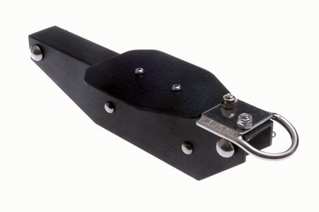

The red line was intended to be used as a halyard for a spinnaker, not an up-haul for your pole.
Even for that intends purpose, you need what is called a crane to move the Halyard further out forward on the mast head.
This is the "stingySailor" set up.
Ideally you want to get the spinnaker block out in front and away from the forestay. The spinnaker crane helps do this, especially on a mast head rig as you have.
A temporary idea might be to move the halyard from the mast to the front of the bow pulpit. When the line if pulled up snug it would place the halyard out ahead of the forestay and the furler.
Relocating your Up-Haul, to a location on the mast maybe 10feet beneath the mast head would keep your up-haul out and away from the forestay/furler yet put the line in a great place to manage your pole.

Thanks everyone for the tips! I think Parsons is right on, in that even when not used as an uphaul I just need a way to get this clear of the furler so will try running it to the pulpit to get it out of the way. While the mast is down I'll add a block for the uphaul lower down. The list of maintenance items is great, will get to work so I don't have to head back up this year!

i just flick the spinnaker halyard behind the spreaders and tie off to the shroud attachments when not in use
Never thought about backwards - does moving the spin halyard sharply back and to the side really keep it clear of the genoa roller furling? I guess it depends on the exact geometry up there.

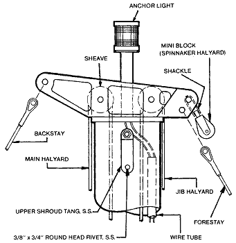

Upon further review the answer could be this: It appears the forward halyard with the red tracer is a spinnaker halyard. It should be on the bale that is forward of everything. But, it appears that the halyard block has been located to a pin that is normally used to provide down force on halyards.. That block can be disassembled at the swivel and properly located on the bale...
