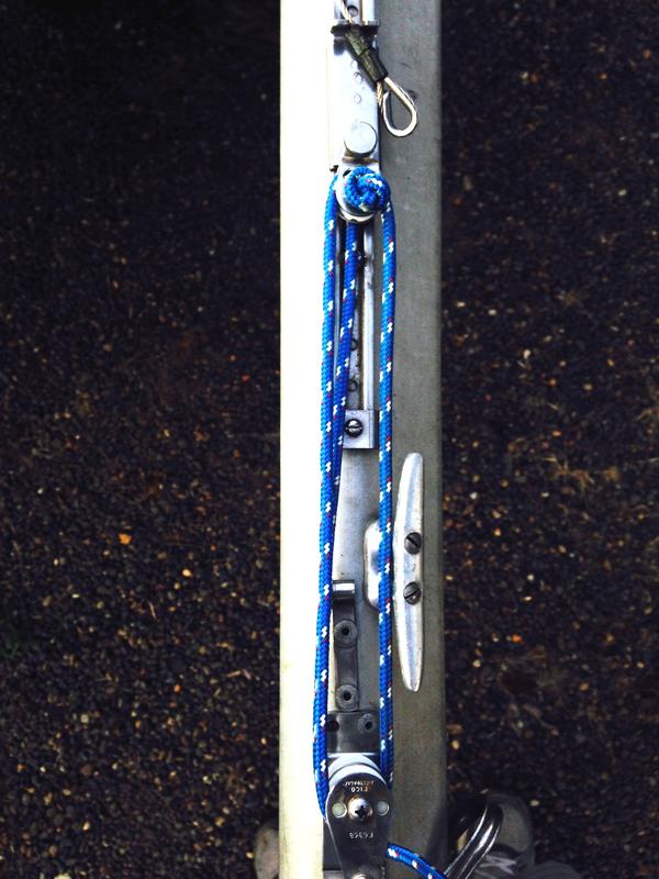

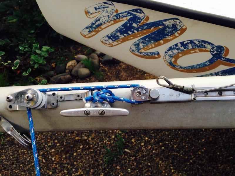

Jul 30, 2015
3
Catalina-27 C-Lark 14 saint helens
sorry for the long post, but maybe this will help other lurkers too
Moja is not rigged at the moment so i measured out of my bag…
Traveler 6mm x 48” double braid VPC long leaving 44” between eye straps which is close to what the wire length was color Black
Vang 5mm x 10’ double braid polyester which works fine for me color white/red
Mainsheet 9mm x 35’ long double braid poly overkill but soft and a has a better feel in my hand this requires larger blocks
Jib sheet 9mm x 25’ long ancient double braid, white i them cris cross so i can control jib from the high side when single handing
Main Halyard 5mm x 24’ vpc, along with the wire rope Green for starboard side of mast
Jib halyard 5mm x 15’ vpc along with the wire rope Red for port side of mast
Blocks the larger main sheet requires 40mm blocks, so
traveler block is Harken 40mm carbo
boom end block is 40mm carbo with swivel. should change to 40mm cargo with becket for ease of rigging
boom mid block is an ancient Fico that must be original stock
Finally the ratchet block is another ancient Fico 40mm that should be replaced
blocks on jib side of mast… assuming you mean the 3 at the bottom of the mast
they are used for adjusting jib luff tension
i slapped together 2 pictures, one has 1x1 mechanical advantage, leaving the outside bottom pulley for the spinnaker halyard
the other has a 2x1 MA which doesn’t leave a pulley for the spinnaker, but i don’t have one so no biggie
5mm is a tight squeeze into the hole in the 16mm block but a simple overhand knot in the end keeps it in place
