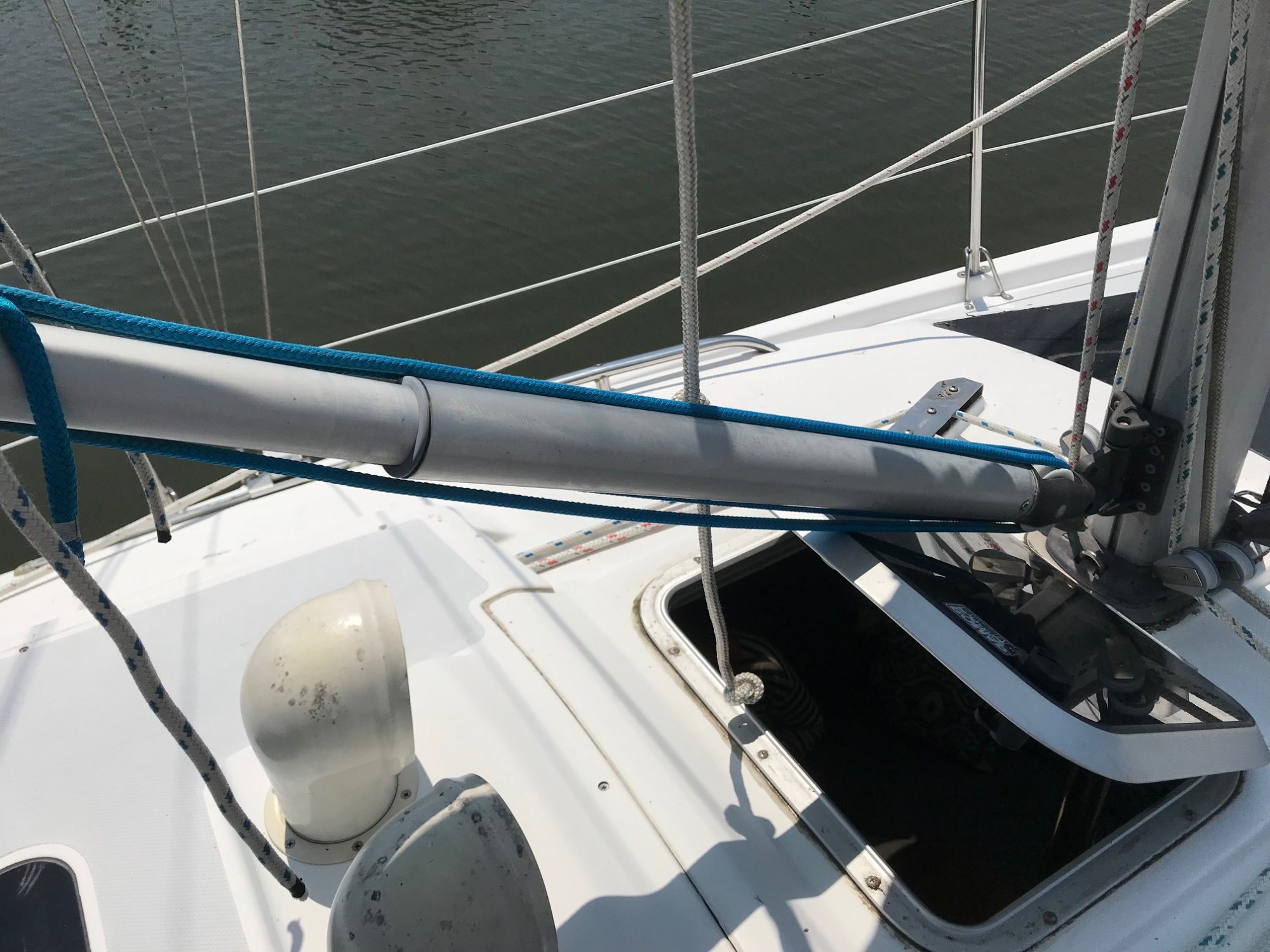

New-to-me 2000 Beneteau 361 - it has a rigid boom vang installed but it's not rigged - there is no boom vang line - and I'm trying to figure out how to rig it.
It appears to be a Sparcraft Ocean Range Rigid Vang - it's a rigid vang with a double block on each end, and that's it. There is no obvious place to terminate the vang line at either end of the vang or on the vang connectors on the mast and boom. There is a vang bale on the mast step.
Any advice on how to rig this would be massively appreciated!! Thanks so much.

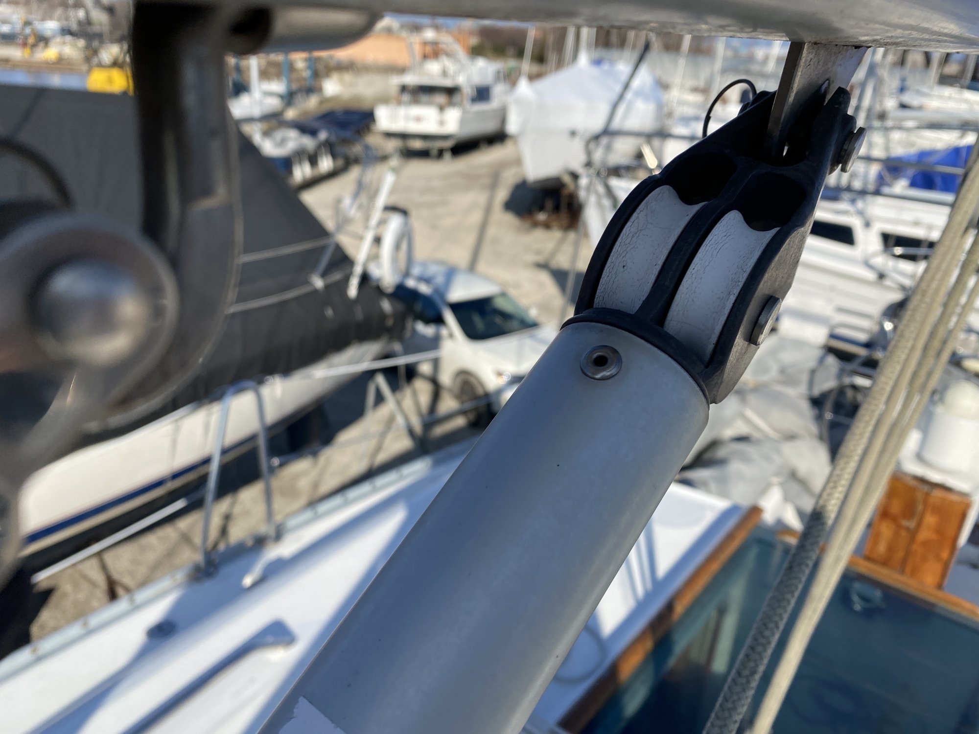

Thx - I had already researched online a ton - believe I have it figured out. There needs to be a line termination point at the upper end of the vang so the line can run through all four pulleys (two on both ends of vang) and then run through the pulley at the vang bale. Pics on the internet are not clear, but I believe a termination point is created by threading the line through the middle throat of the upper vang end, and then tying a figure eight stopper knot. This is the best I can come up with, anyway : )
I have the same vang. I don’t have any especially good pictures, but that’s exactly right - the line enters the throat and has a stopper to keep it from pulling back out.

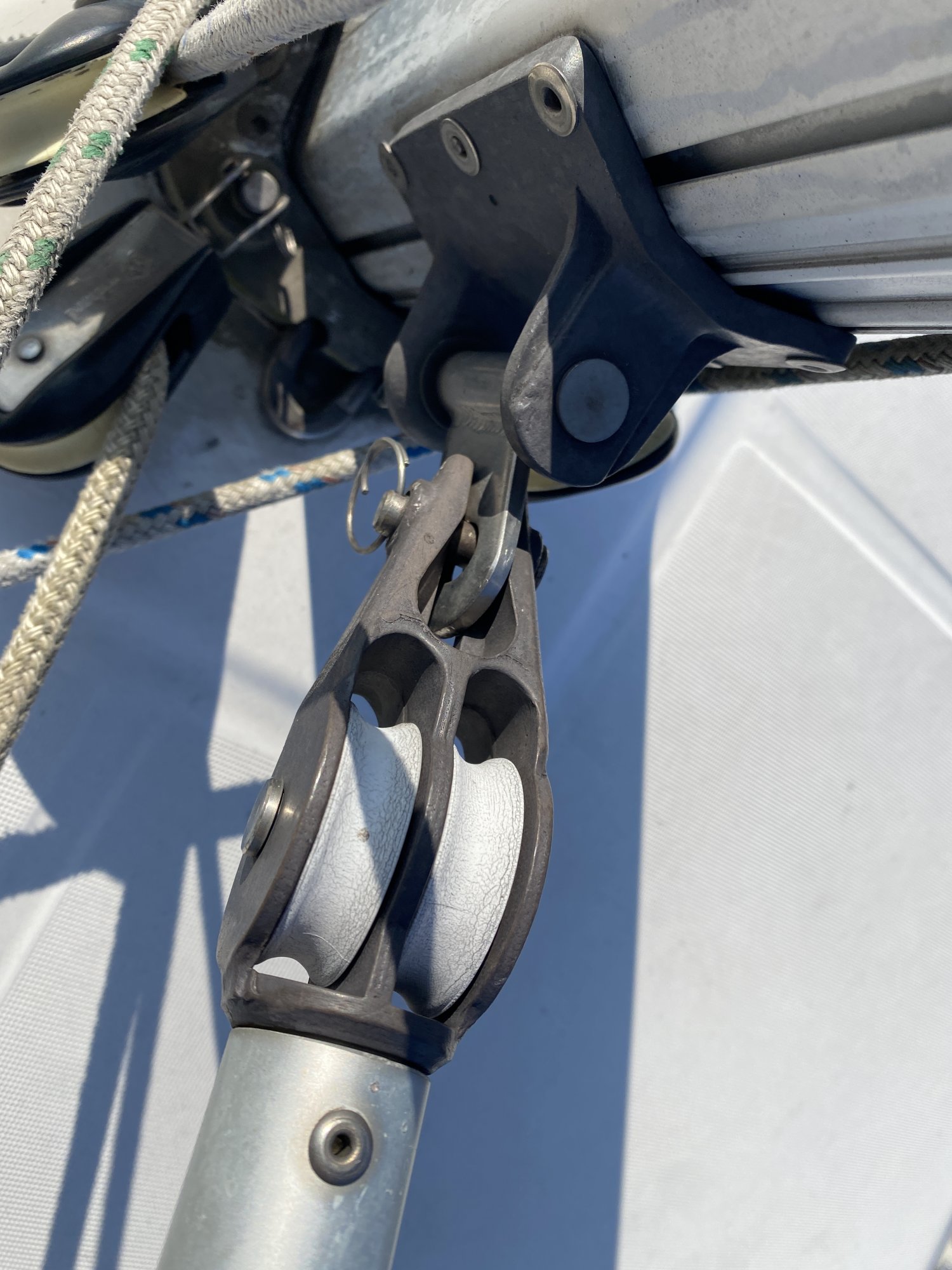

I have similar vang and my issue is the ropes have loosened on the vang, it was tied with no line back to the cockpit. My boom is sagging now and resting to much on the cockpit dodger when not sailing. When I had the ropes tight it was off the dodger just a bit. There is a 3 hole block that attaches to the base of the mast that looks to raise or lower that end of the vang. It is now set in the bottom hole, should I raise that and pin to a higher hole will that raise the boom. Any other info on how to use it would be greatly appreciated. Just got the sailboat a Hunter 29.5 and my knowledge as green as grass. Thanks

The outer cylinder of the vang attaches to the boom. There is a recessed hole between the boom attachment and the upper sheaves. Thread the vang line through that and tie a double stopper knot in it. Then thread the line through the sheaves, exiting at the mast base, through a block at the base and back to the cockpit.
