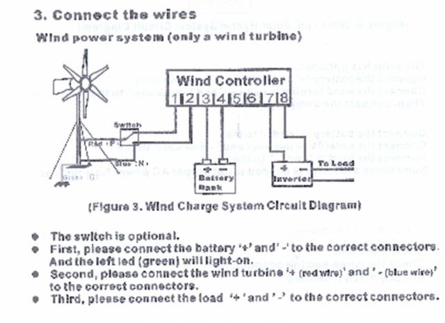

I am doing a dry run on my Wind Turbine installation before it comes down and gets painted and have a question regarding the electrical hookup. I need help deciding how to interpret this schematic for my wind turbine.
I shows terminal 1 & 2 to the turbine wires. Input 3 & 4 hooked to the batery in order to power the controler (red LED,s light up when 3&4 are hooked up).
My question is regarding terminal 7 & 8. I assume this is the output. It shows going to an inverter also labeled "to Load". I dont have an inverter therefore should I connect it to the battery in order to charge it.?? And if so, it looks funny to me to supply power to the controler from the battery and to wire 7 & 8 back to the same battery.
I have 1&2 and 3&4 hooked up now. This weekend, I could hear a selenoid in the controler unit cliking when the turbine showed the Charge LED on and the turbine comming to a halt, only to re start again. Obviously, it was generating power and cutting itself off by stopping the blades from turning. I have it secured now so it wont turn and self destroy.
