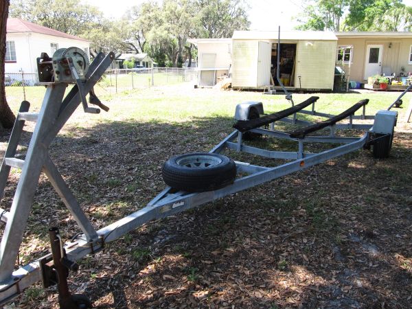

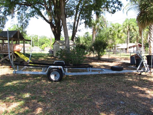

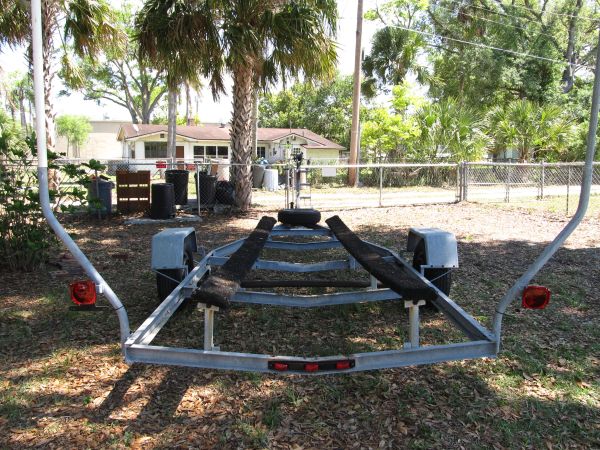

I went to pick up the H19 today. I couldnt find any up haul lines. I found out why... this girl has a fixed keel. What the heck?? None of my research has ever shown a 1994 with a fixed keel. Long story short, she wouldnt fit on my current trailer. I think I found a Hunter trailer. It has 10 inches clearance to boards and a 45" outside to outside board width. I couldnt measure the keel because the boat is in the water. is the narrow width of the boards enough to give me clearance of keel? It appears that the keel is maybe 24" max below hull. Help please, I am desperate!! Thanks I have enclose pics of trailer. I hope to get it in the morning and head back to the boat on the west coast of Fl.

It would appear that your trialer is one designed for either a 240 or 260. The hulls of the 19, 23.5.240 and 26/260 are different. The trailers for these boats were designed specifically for the particular boat as it is critical due to wieght carrying of the boat on the bunk boards. Otherwise, you could conceivably damage the hull/water tank ballast lid for a 19 on that trailer. I would tell you do not do it.
As for your desciption of the 1994 Hunter 19, it was only offered in a water ballast with the swing centerboard was not totally encapsulated into the hull when fully pulled up. I hope you listen to this advice.

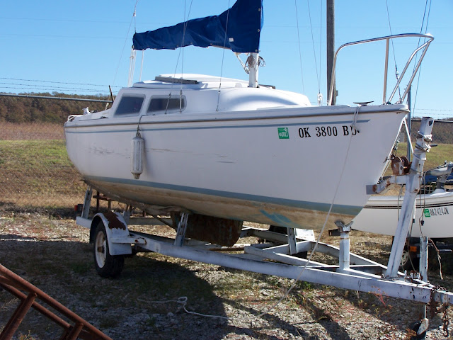

Thanks Dave, I do not have any other alternative at this point. The boat has to come out of the water today. The guy I bought it from needs it gone. It is defineatly a fixed keel though. When I tried to get her on my current trailer it started to roll as we pulled out of the water. I looked underneath e and there is a cast iron keel running from about the mast area to the center of the cock pit. It appears to be about 2 feet tall by maybe 6 feet long. I will try to find some specs some where and modify this trailer pictured above for the 100 mile journey. I have attached a pic of a simular keel. Not my boat but very similar keel shape and size.

The pic showing keel was just an example of what keel looks like. The h19 in the earlier post is my boat. Sorry for confusion. My boat is a custom built on a 19 hull. See my eRlier post called custom H 19. Thanks

"Buyer beware" Sorry your in trouble, either the owner lied or you didn't ask the right questions. I'd suggest you find a local welder unless you took tools and drills and what not with you. Get some lumber bolt or welld on a guide for the keel with a board under it. extend the braces that hold the runners . http://www.trailnsail.com/Galvanized Sail.htm has some examples and a how to measure section.
Basically your balancing an upside down rounded triangle. Hope you get it worked out!
I would take the trailer to a trailer shop (today before they close) and buy new, longer bunk supports (the vertical section in galvanized) and whatever mounting hardware you need. Also, a plank like Denise mentioned to take the weight of the keel and fasteners for that. You don't want the boat resting on a swing keel and you also don't want the boat supporting the weight of the keel going down the road. If it really is a fixed keel, the keel should take most of the weight.
Ask the trailer guys how to set it up for the first loading- when I did this, they told me to extend the supports on the ends of the bunks to full height and leave the center ones loose (u bolts on trailer frame); load the boat and pull it out of the water then tighten those u bolts. I did this and it worked fine.
You might have to do some adjusting to the end (most fore and aft) supports to lower the hull. Safest way would be to relaunch, reset the supports and reload the boat.

Thank you all for the great advice. I got the old girl loaded and home. I had to build up the bunks to 24". I will get some pics of the boat and keel up later today hopefully.
