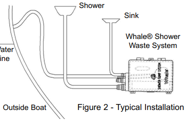

This is how my shower sump is currently plumbed by Beneteau. I don’t know if they use anything special in the line to keep the pump discharge going out the thru hull. I presume it’s just pushed down by gravity the same as the sink discharge.

Suggest making a list of all your below and above waterline thruhulls and hoses with a diagram, including diameter, valves and thru-hulls. Might check with these guys for an owner's manual. Some thoughts:
  • Remove the grey water bladder
  • Sinks drains.........route to a dedicated below waterline thru-hull valve............you already have one under the galley sink and it sounds like you also have an abandoned thru-hull valve for the head sink
  • Shower drain.......route to an electric hower sump pump box then out through an above waterline thru-hull
  • Toilet discharge.............route through a sanitation hose to the holding tank with hoses connected to a deck pumpout, above waterline vent and macerator pump then to a below waterline thru-hull valve, if you want that capability
Likes: Apex

  • The current unused "vent" is at the rub rail, I assume that would not be appropriate for the shower discharge ....I would drill a hole a few feet hole above the waterline, install a thru-hull and connect hose with a loop from the shower sump collection box & pump , located below the shower
  • Head sink.........suggest installing new below waterline thru-hull and valve under the sink (my preference), run a hose to the shower sump collection box & pump OR consider another option discussed in this thread Plumbing sink drain to head intake | SailNet Community
