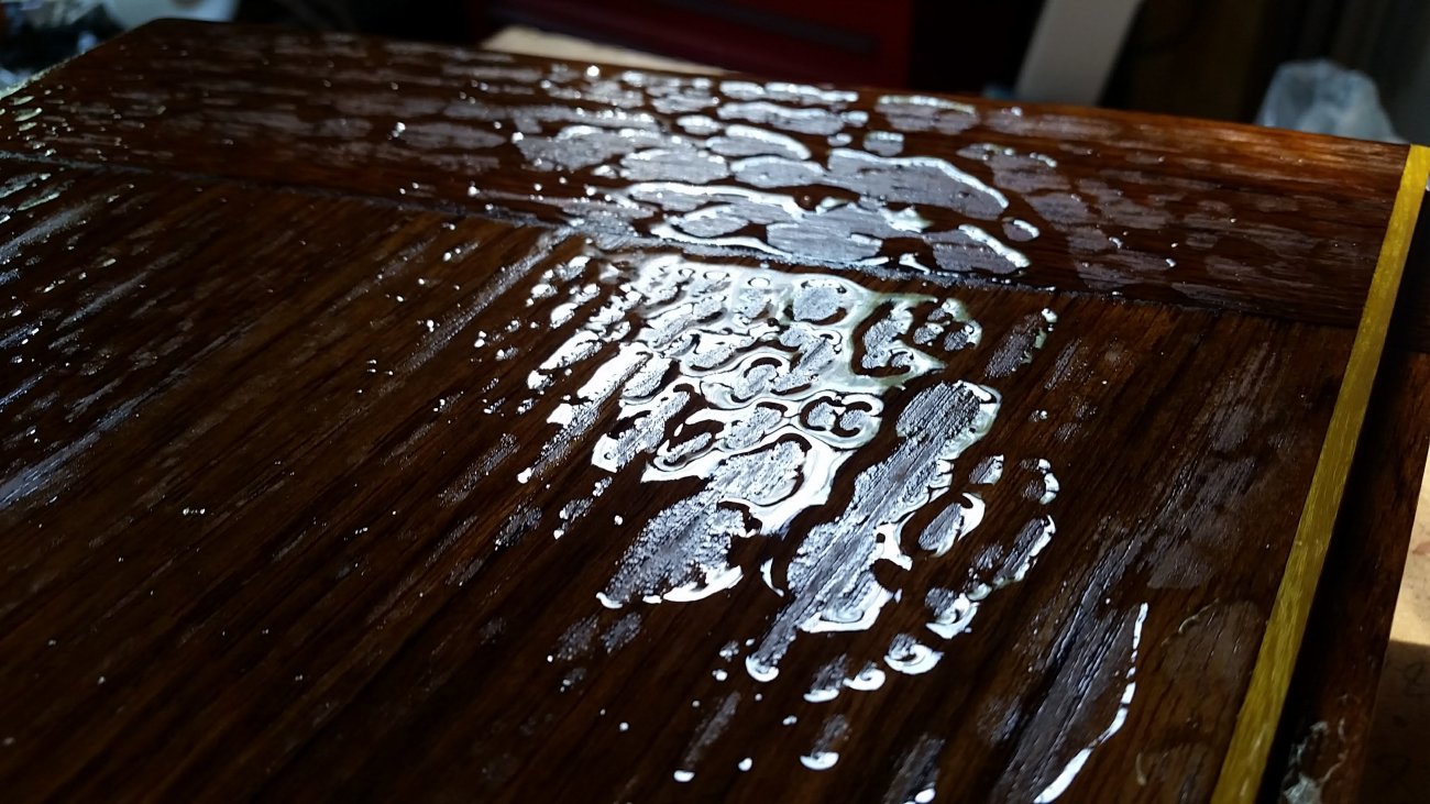

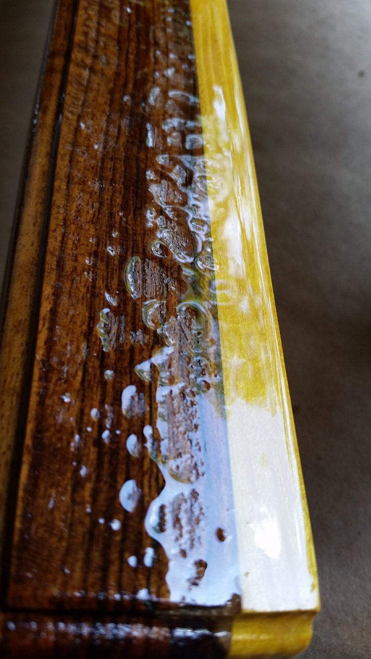

I am refinishing my Catalina 22's teak. I got it all sanded and beautiful, cleaned with denatured alcohol per Mas epoxy instructions. This isn't my first rodeo with epoxy and wood. I do a lot of epoxy work, always with excellent results until now. I brushed out the crib boards with the first coat. Looked fine for about 10 minutes, then it began to crawl back into huge fisheyes. It appears to be silicone contamination. All I can figure is that the idiot I bought the boat from was using silicone deck sealer on the wood!

Silicone contamination is nearly impossible to remove from wood. It's nearly impossible to remove from gelcoat too. I've already sanded these boards thoroughly and cleaned them, but the silicone apparently runs deep. From what I've been reading, maybe xylene will work. Some say just sand off to bare wood and coat with shellac (that can seal in the silicone), then epoxy. I'm going to call Mas tomorrow to get an answer from somebody who knows, whether I can epoxy over shellac. Anyway, it's really frustrating because I was finally ready to finish the wood, but no...

The horror... you'll notice the fish eyes don't form on the Osage Orange that I used to repair the edges of the companionway trims. That indicates to me that the teak was not contaminated in my shop.

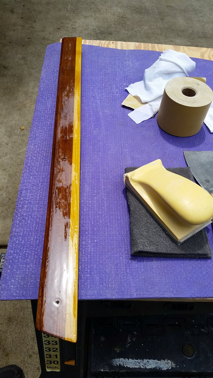

So the long and the short of it, after sanding all the finish back off, and trying a variety of solvents, test pieces were still curdling the epoxy. I spoke to Mas tech guys and they suggested sanding with 60 grit and slapping on the epoxy. This did work on everything but the crib boards, the weatherboard, and the hand hold. I ended up using totalboat teak sealer on those. The rest got 3 coats epoxy and 3 coats of varnish. (Photo is not of the final coat, just showing that it wasn't crawling back anymore)
