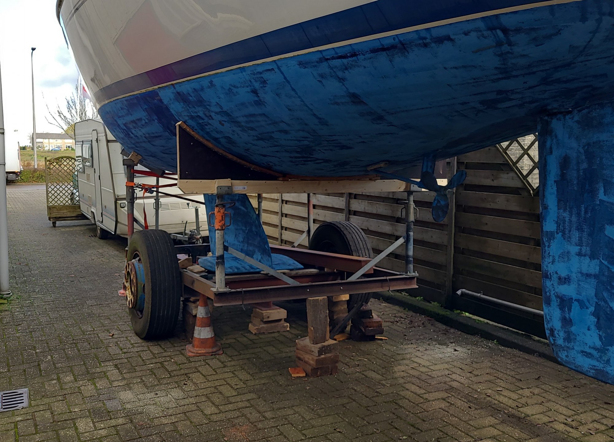

I recently bought my first sailboat, a Columbia 27 that has been sitting on cradle for 2 years. As a result, there’s some significant hull deflection where the cradle pads are (and some surface level crack in the anti fouling)
Based on what I’ve read, this means that too much weight is resting on the pads, and not enough on the keel. The pads are smaller than they should be, only about 6 inches.
How can I fix this issue?
I was thinking of building a wooden support to support and then jack the boat up to adjust the pads. Is there a better way to do this?

Make bigger pads ! best are in shape of the hull. The pads can only have little weight, just to keep the boat up right.
After 2 years on the hard maybe the hull did some flexing, If it's not to bad it will return to the old shape.
a lot of boats have "dents" in them.
I saw an old 20 ft sailboat on the hard this summer and there the pads went about 2inches in to the hull. Think it was there for over 5 years and had 2feet of water inside the boat.....
