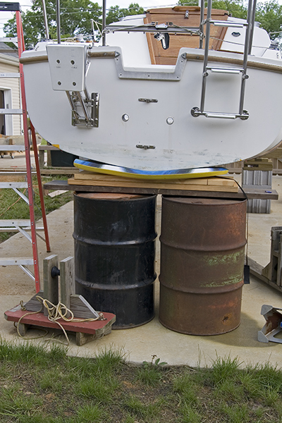

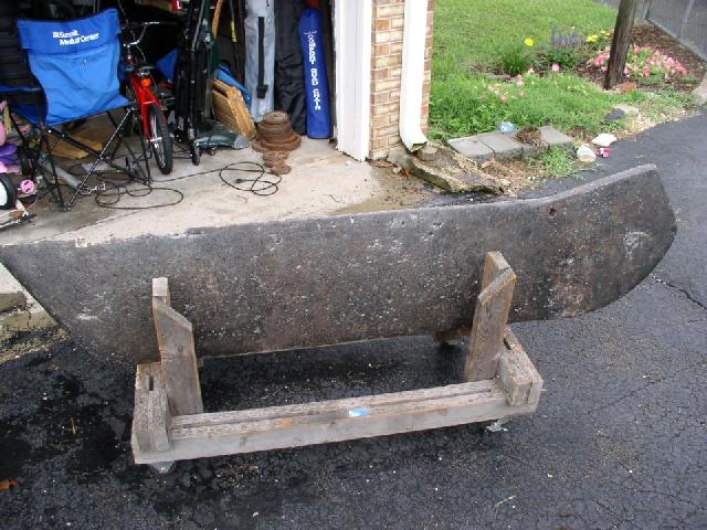

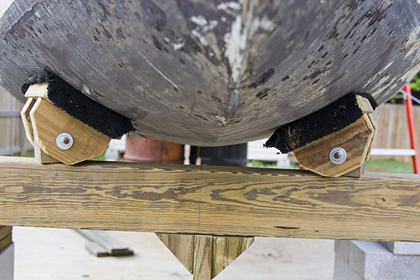

Here is a couple pictures of how we took and continue to take our boats off the trailer.
We use two 55gal drums a 2X8 and a old boogie board for the transom
The bow is supported using a 4X6X14 and concrete blocks stacked two side by side rotated each time until the height is gained so the trailer can be rolled forward.
You can use the trailer jack to lift the boat by letting it all the way down, place the barrels under the transom. Then by raising the trailer the transom lifts off the trailer, place the beam under the bow. You may have to repeat a couple of times to gain the height you need doing it this way. (This is where the high lift jack comes in handy).
The main thing is don't get in a hurry and make sure your working safe.
I included the sled photo, Now is also a great time to finish and fair your keel :D

Brilliant!
That is quite the engineering marvel. I especially like the carriage you made for the keel. Pure genius. I only wish I had a concrete pad on my property to get her up that high and feel safe about it.
