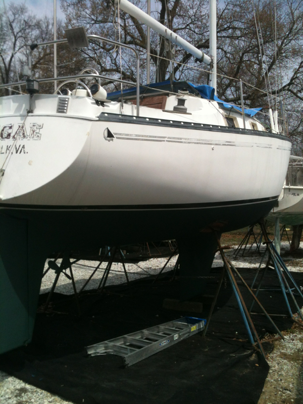

I have spent the last year preparing a 80 hunter 30 for launch.
Well while bottom painting this past weekend I noticed a compression ( for lack of a better term) the compression is aft the keel. There's is no keep crack, no dents on keel , just the compression has caused a spot on bottom and push floor up on starboard side just before steps( raised the floor wood and at first I thought it was separated because of moisture from water being on floor ..
History:
Boat has been on hard since 1999
Owner took very good care of her , she just got to old to sail
Owner bought her new in 1980 so I'm second owner
She had all records of anything done until she retired from sailing
Documented vessel
But I'm thinking and correct me if I'm wrong:
The keel bottom compression I see is from improper set up over years and boats weight is on keel. Ground and time may have caused jacks to shift /slip.
Will having yard re set up boat higher in the "stirrups" take weight off keel and weight of keel have enough memory to drop down and round of bottom of boat to normal and subsequently cabin sole drop back into place?
If so what should I look for to be unseen damage, will this old boat bounce back into shape.

Your diagnosis about the hull sounds correct. never heard of one being on the hard for that long though. Might "cure" itself once you put her in the water. I know it takes a few days after we launch for all the cabinets to "settLE into place"
10,257
I agree, the dent is most likely from bad load distribution while on the yard. You probably had about 5 tons of water on board which caused the problem. The dent will probably go away but it may take a few years. Meanwhile, check the glass in the inside and outside area of the dent to make sure you don't have any thru-hull cracks .. The water in the transmission may have ruined the bearings, requiring a tear-down and replacement.. but do the purge and Marvel treatment first to see if you can get it kinda free. Any rust in the water that you pump out of the transmission will tell ya that you probably have a good bit of work to do in there. Good Luck.
