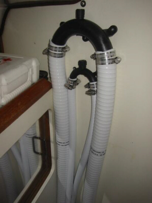

We're seriously simplifying your plumbing...but there's one thing we haven't discussed: the toilet's flush water intake plumbing. Unless you've rerouted the toilet intake line to tee into the head sink drain line, that's one place where a vented loop IS needed. It does NOT belong between the thru-hull and the pump 'cuz it'll interfere with the pump's ability to prime...it has be between the pump and the bowl, which requires replacing the short piece of hose the mfr used with two
pieces of hose long enough to put the loop where it belongs (photo shows both intake and discharge loops ). If that's how your toilet is plumbed, great...this info will be useful to others.
