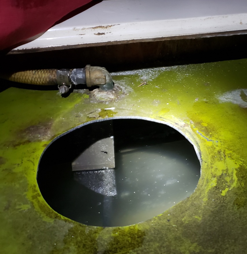

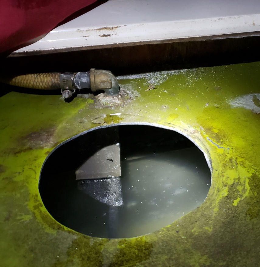

It was spitting air and not much water prior to the pump change. Changing the pump and tightening every fitting made no difference. Today I intend to cut an access hatch in the top of the tank. What else can it be but the pick up tube, right?

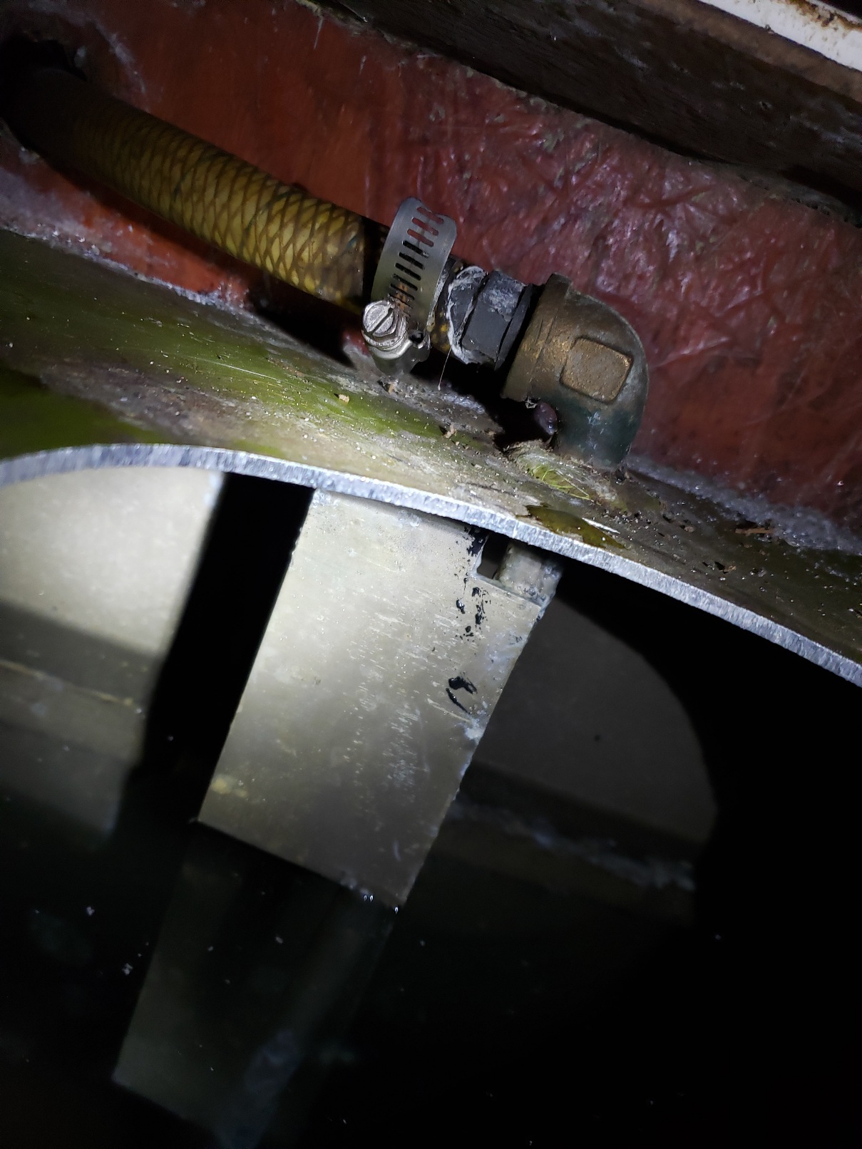

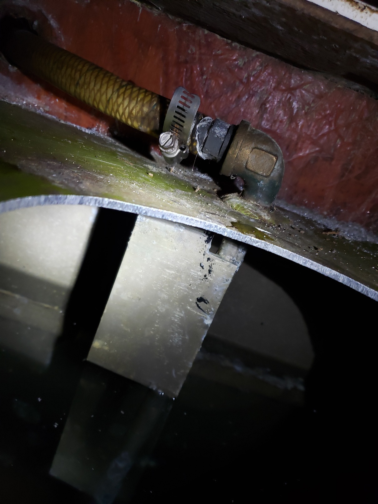

Thanks so much everyone for your help. I think I'm almost there! The pick up tube is corroded in a few spots and it seems to me smarter to just decommission it, plug it and drill a new hole for a new one. Make sense? My question: What should I make the new one out of? What would be easiest and best to use there? Rigid right? Pvc? Something better?

Cut the pickup tube off about two inches below the top of the tank. Sleeve with a vinyl hose that reaches the bottom and clamp. Did this to my 1980 H33 years ago. Most of the corrosion is low on the original tube.
The corrosion on mine is within 5" of the top. There is a metal plate attached to the top five inches of the tube from the top of the tank , so it would be difficult to attach anything.

Thank you all for your help! I fashioned a new pickup tube out of CPVC and it works like a charm. I'd send a picture if the job didn't look so sloppy!
