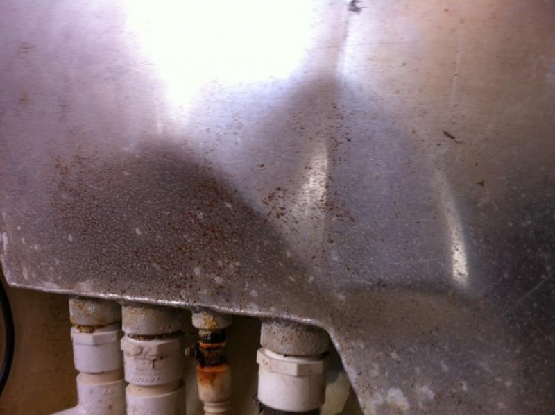

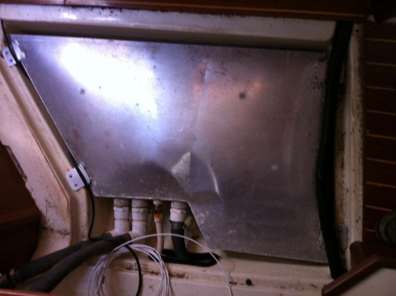

The holding tank
So this is my holding tank
Looks like its been under pressure to bulge like it does in the photos.
Its going to be taken out and properly inspected today so I will know more.
Peggie, I initially thought the vent line might have been blocked up at some point - could this have caused that much pressure buildup to bulge the tank like it shows in the photos?

So this is my holding tank...Looks like its been under pressure to bulge like it does in the photos.
I'd say it's been quite seriously pressurized!
Absolutely! A blocked vent can create enough pressure in a tank to rupture even the thickest wall plastic or stainless tank. Aluminum tanks typically have relatively thin walls, so it doesn't take a lot of pressure to distort them. Apparently the pressure has been able to escape through the toilet...otherwise you or someone would have gotten a sewage bath when the pumpout cap was loosened.

Should I have my tank pressure tested when it gets taken out? I wouldnt even know what pressure to test it at but I would love to be able to keep it and save some money.
I'll report back with some more pictures when its pulled out and it can be looked at properly :)
I guess thats why my old crappy jabsco was bubbling and flowing back in there - so glad I had it in there rather than a decent head!
May 13, 2011
420
Hunter 40.5 Legend Jupiter
Mind you,
As long as its not corroded / leaking and I install a tank monitor on it whilst i have the opportunity I guess I should be ok.

Mind you, As long as its not corroded / leaking and I install a tank monitor on it whilst i have the opportunity I guess I should be ok.
There are only two kinds of metal holding tanks---those that leak and those that will leak. Labor is the majority of the cost of replacing a tank...if it's coming out anyway, now is the time to replace it with a good quality plastic tank, especially since the hoses are already being replaced it. Do it ALL at once...unless you want to just continually have problems.
