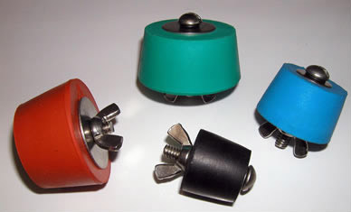

For openers, you can go cheap and buy tapered wooden thru hull plugs and pound these into the open ends of the hose as it now stands. Finish off with duct tape as a final prayer. This should make the work a little cleaner. Perhaps cut the hose into shorter lengths to work with in the removal. Lots of plugs now. Considering the material you're working with, a better choice would be expandable pipe plugs from a big box hardware store to ensure no leakage. I'd much prefer working with pipes in the damaged Fukushima nuclear reactor to dealing with plugged sewage hose in my boat.
