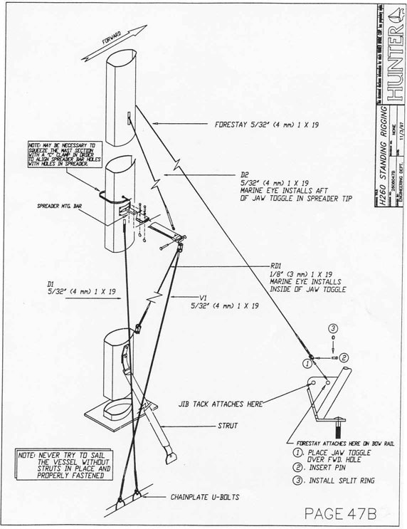

Sorry Tom & Ray but I seem to be confusing everyone so I might try to get it straight. Now the lower shrouds are connected to the mast just below the spreader and run down to the U bolt on port and starboard sides. Correct? The upper shrouds are connected to the mast above the spreader and of course run to the end of the spreader and then down to the chainplate for want of terms or to be more precise the U bolts on port and starboard sides. Correct? Where the upper shrouds attach to the spreader there is also another cable (on both sides) that extends down to the mast and terminates with a T ball in the mast about 5' up from the bottom. Correct? Now it is this cable that I have wound up (on each side)to achieve mast bend or pre bend. If I loosen these off whilst the mast is lying down the mast will naturally straighten. As I wind up the turnbuckles and put tension on these cables the mast begins to bend. Too much tension and you end up with a banana. So if I have explained that correctly what I would like to know is prior to stepping the mast how much pre-bend should be in the mast. As you all know you can add further bend when adjusting the upper and lower shrouds however I need to have the pre-bend set correctly. Few! That was hard work Ray I don't think there will be any beers left by the time you get here (just joking)

Picture Hope this helps
Here is the picture of the rigging from the H260 manual hope this helps. I also wonder what the tension should be on the RD1 wire? Its alittle tough standing on the latter with a loos guage to check the tension and what value it should be. Ray, I thought you were already on the way? Jim S/V Java

Here is a URL for B&R Rig tunning, including the diagonals -- the stays from spreader tips to mast... http://www.hunterowners.com/ref/br.html

Now I understand...
Sorry for the confusion. My 1995 H26 doesn't have the "RD1" as shown in Jim's post. I knew the shrouds were lighter wire on the 260, but I didn't know the rigging configuration had changed. Dave, does this change any of the advice you gave me on the phone?

Me too. Indeed, the 260 mast has extra items not
included on the 26 mast. Mark, I think that the ability to set the bend with these wires could be alot of fun. Many more possibilities. Jim, we will leave Washington State no later than Aug. 9 and head east. The house will have closed out and "Speedy" will hopefully have been sold. If she doesn't sell then we'll keep her for our return and let the kids use her until then. I kind'a like the lady and we have the ability to store her in one of the barns thru the winters. Ray S/V Speedy

Thankyou all for staying with this one. So we now have a picture of the RD1. This is the one I have tightened up conciderably to put bend in the mast prior to standing the mast up. "BUT" I would like to know just how much bend. The link states 1% of height of mast above boom so unless anyone can advise otherwise I'll try that. I guess if I could get the sail maker to inspect it would help! This is a fantastic forum and discussion about topics like this are not only interesting but I hope will form long term friendships. Cheers and beers to you all. Mark
