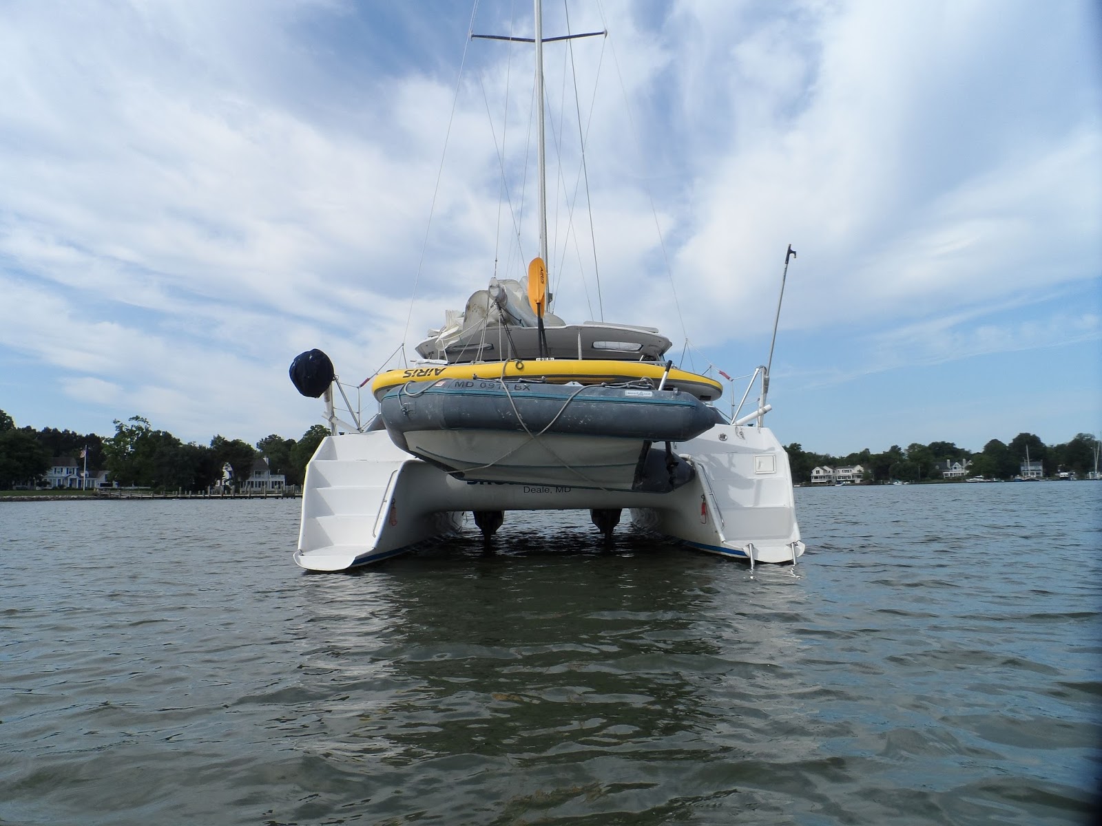

You might be able to carry it for limited periods without trouble. I carried a removable floor dinghy. The key is that you MUST trice it up with lines under it EVERY TIME you intend to sail. You can lift it overnight without this, but the stres of moving through waves will be too much. Triced up, no problem, just keep the pressure up.
You will also want a spreader at the front instead of a bridle. Less force on the eyes, and in sheer instead of pulling out.
The dinghy is on davits, with the tricing lines criss-crossed to reinforce. They also eliminate sway, which is good for any dinghy. The inflatable kayak is actually lieing on top of the davits. The dinghy is intentionally tilted to one side so that rainwater drains, and the plug is left out.

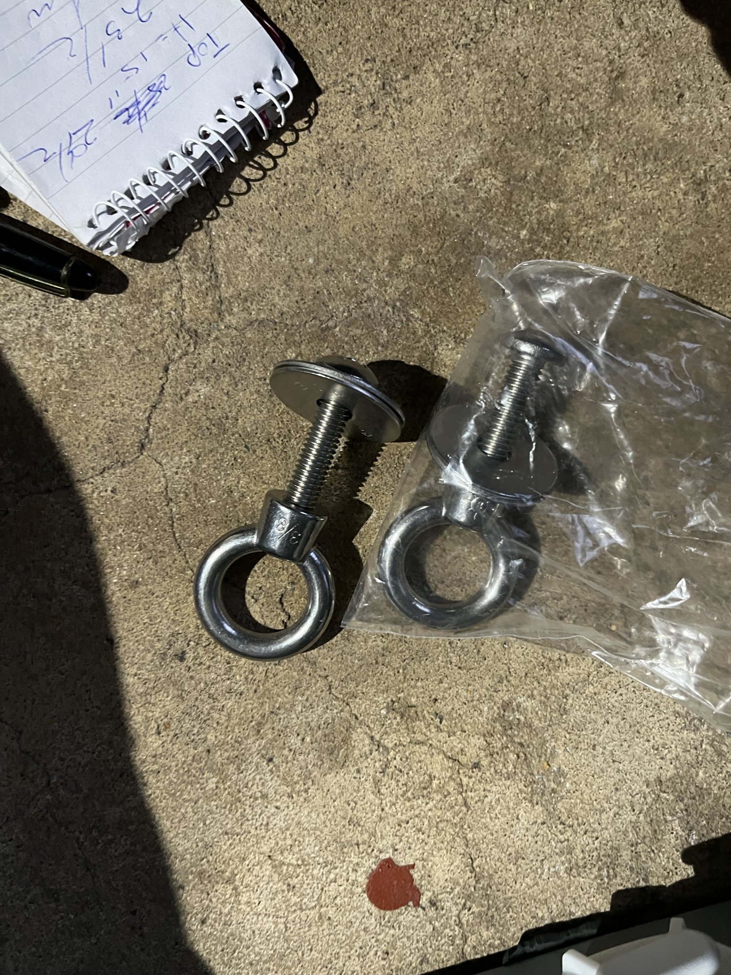

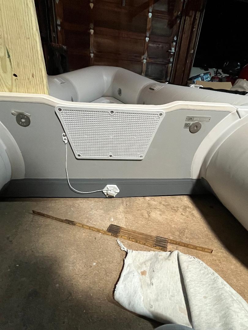

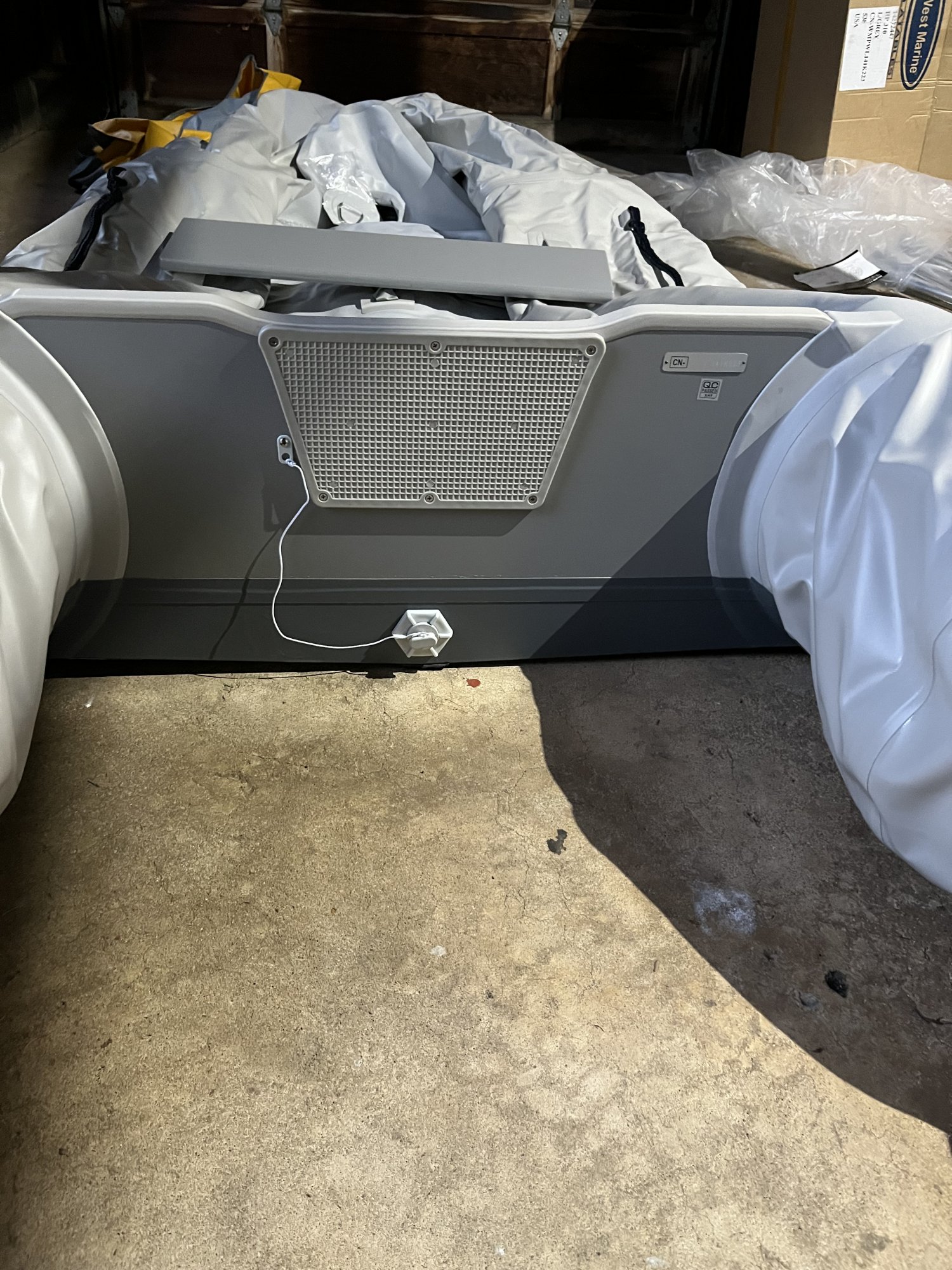

Hi - took a while - but advice appreciated Thee are views of the transom and eye bolts I'm planning on. I'm alitte worried when I fold the boat up the bolts will be a problem. Anyway the transom is 1 inch think marine plywood covered with plastic - for sure any holes will need to be well bedded (suggestions on bedding that won;t be super-permanent ? Dimensions of the transom are 29 1/2 wide at the top, 15 inches high, 23 1/2 inch at the most narrow point (where the tubes are) It will be holding at worst a 60 lb engine (6 hp yamaha) Any thoughts and suggestions appreciated Am I mad drilling holes in this brand new boat ?

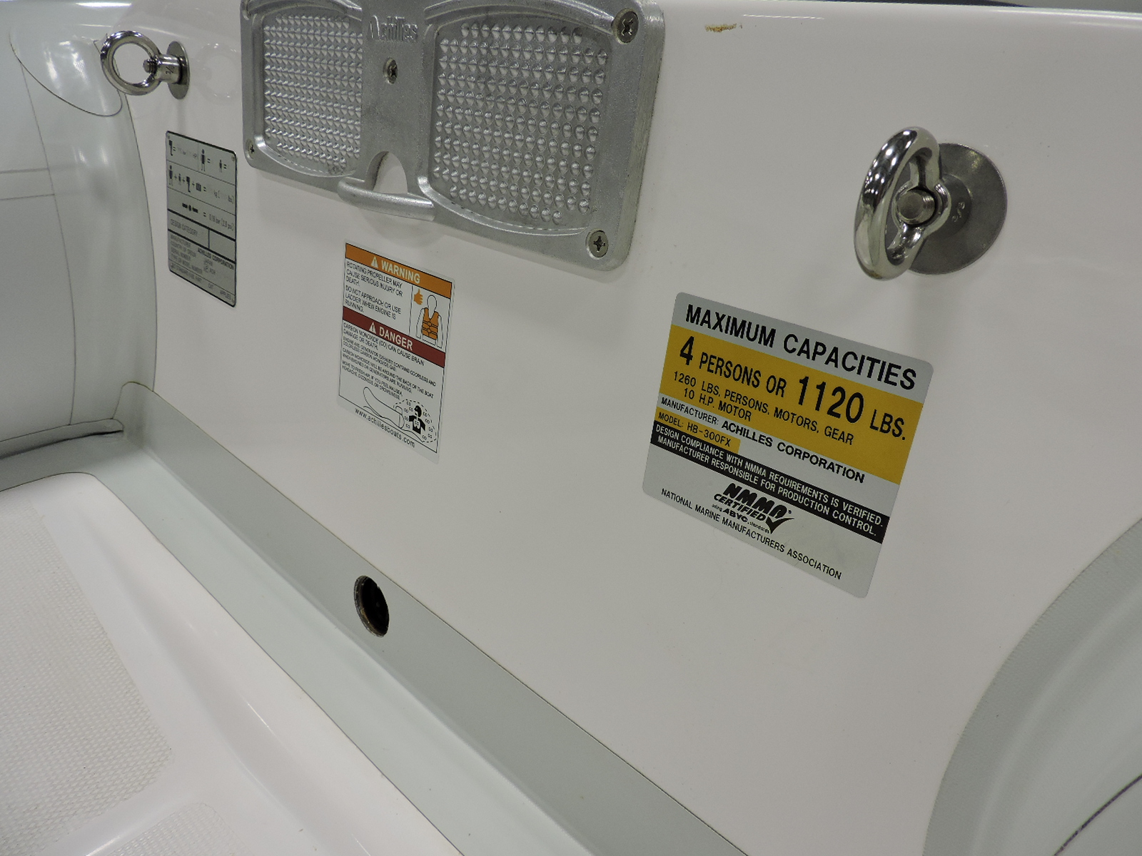

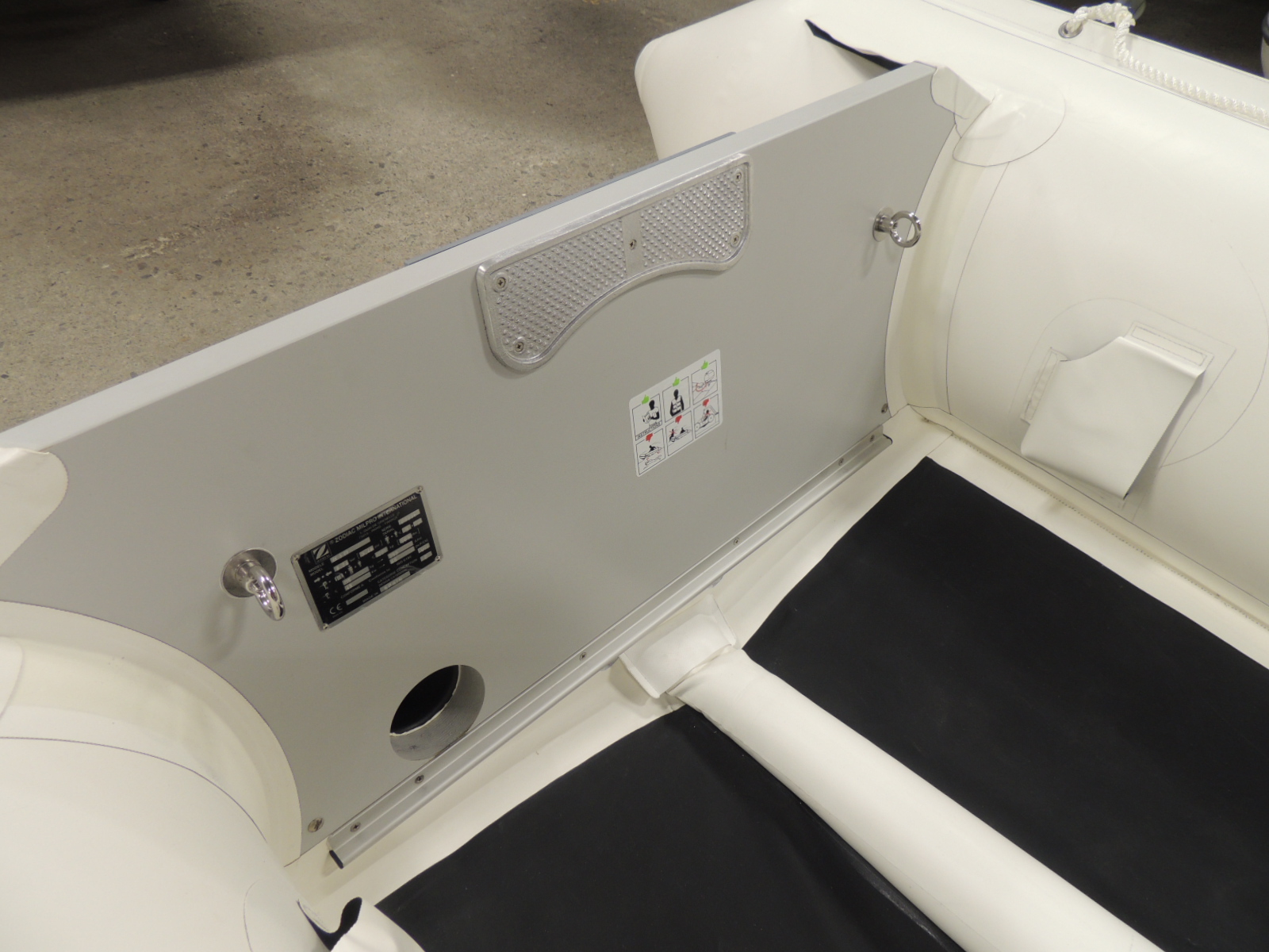

dLj
Mar 23, 2017
4,495
Anyway the transom is 1 inch think marine plywood covered with plastic - for sure any holes will need to be well bedded (suggestions on bedding that won;t be super-permanent ? Any thoughts and suggestions appreciated Am I mad drilling holes in this brand new boat ?
I would over-size the holes by a good half inch, fill with epoxy and when set, then drill through the epoxy - you even could drill and then tap those holes for those bolts. Then use butyl as suggested above.
I've also cast the epoxy around the bolts, but if you want removable then coat the bolts with microcrystalline wax. The advantage doing it this way is you can be certain to have the bolts with the correct orientation and fully threaded in

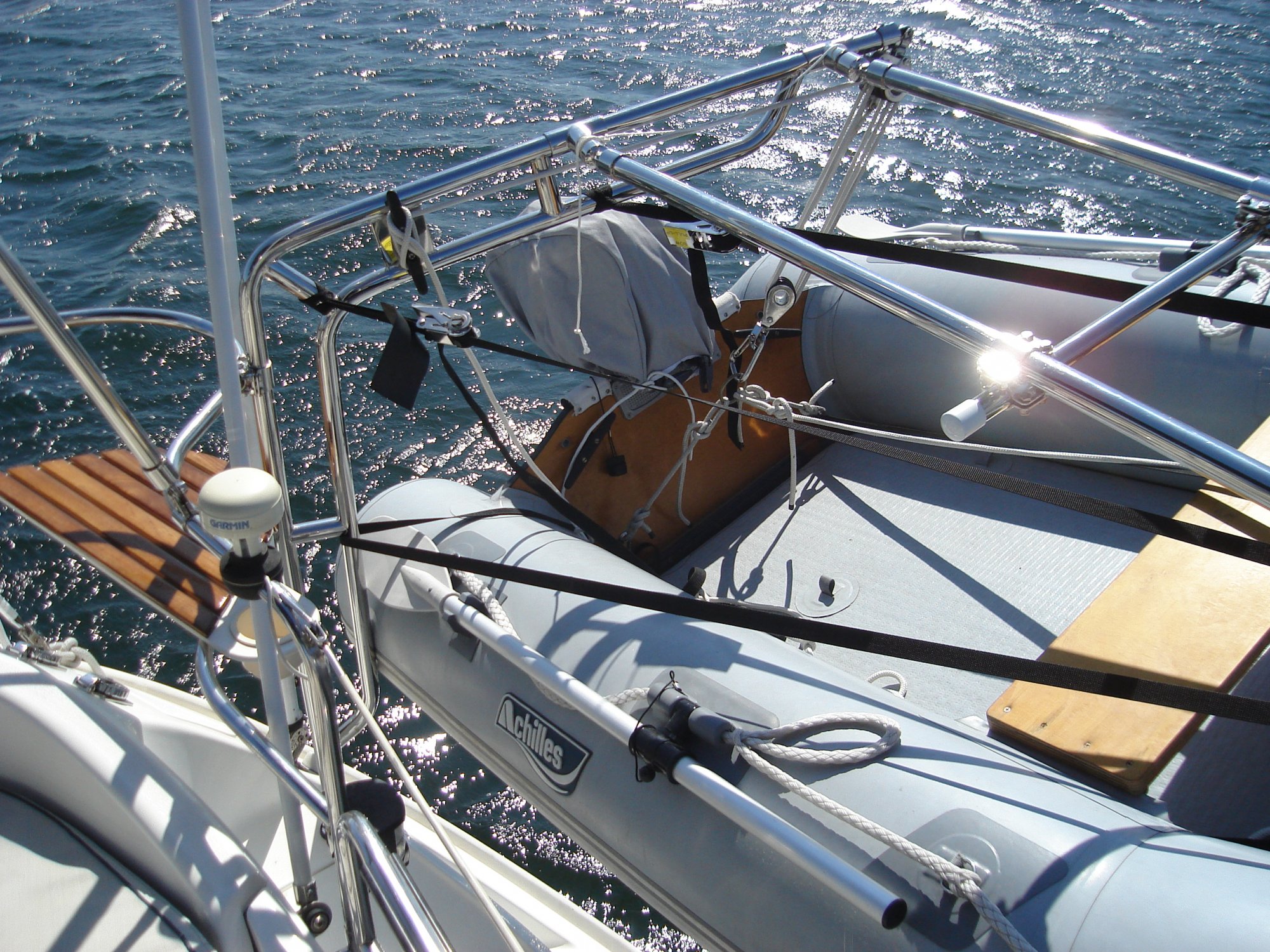

I have an Achilles air floor dinghy that I hang from my davits exactly like you are planning. I put two D-rings on the inside tube at the bow and two eye bolts through the transom. I use a bridle on both ends with a center line tied between them. I don't use a spreader at all and I don't use lines under the dinghy. The bridle is adjusted so that the dinghy is tipped toward the drain hole.
But most importantly, the davits are tipped toward each other, so that the hoist ends are a shorter distance apart than the D-ring to eye bolt distance. If you were to draw a line connecting the davit ends, then to the D-rings, then to the eye bolts, and back to the davit end, the shape would be a trapezoid. You don't want a rectangle because that will allow the dinghy to swing port-stbd in a seaway. With the hoist in a trapezoid configuration, the dinghy will not swing. I have pictures and sketches that show the setup, but I don't have them on my phone to send now. PM me for more info.
Likes: LloydB
Feb 10, 2004
4,154
Hunter 40.5 Warwick, RI
Thanks - this sounds good if you have some photos it woudl be great

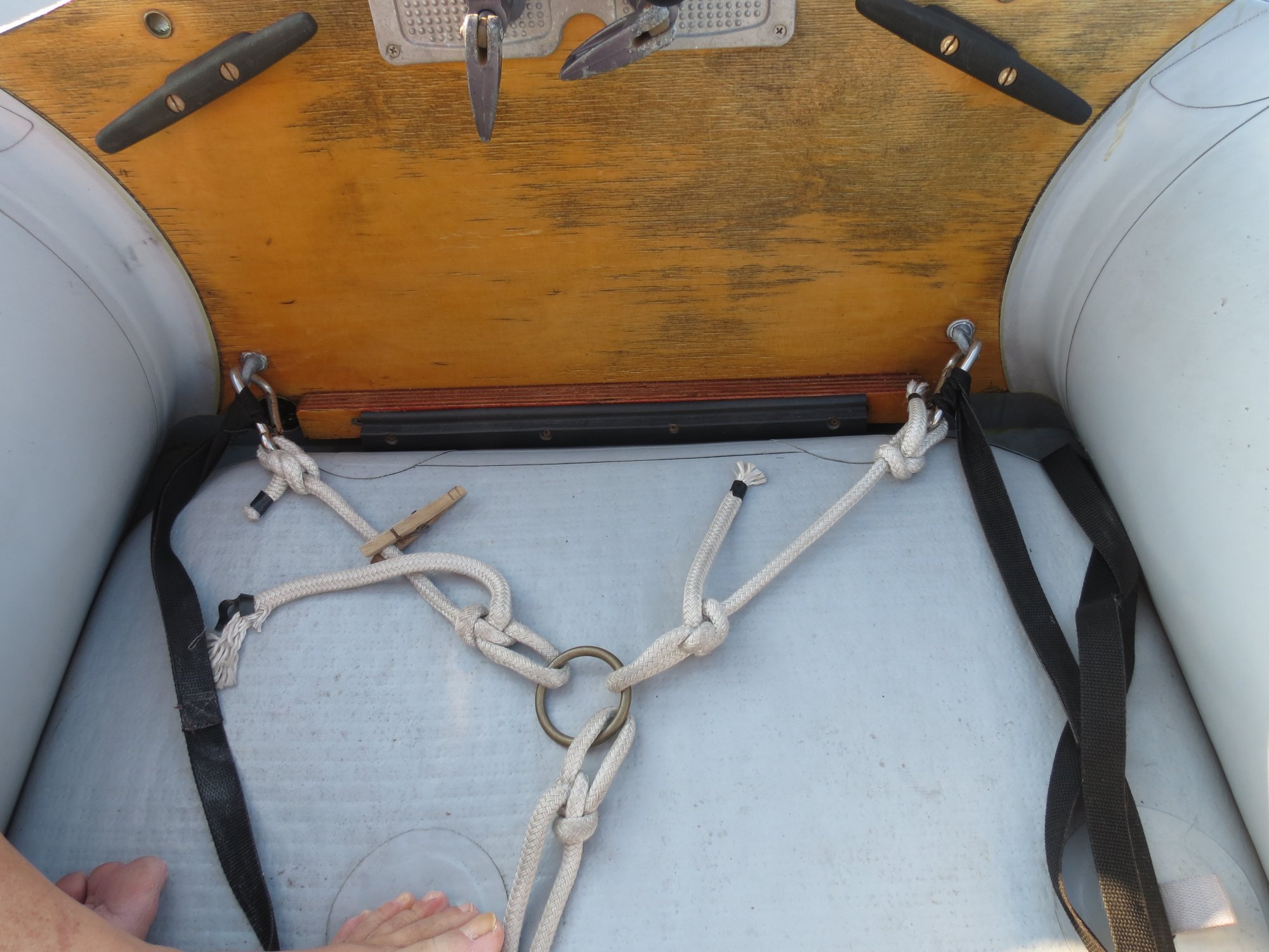

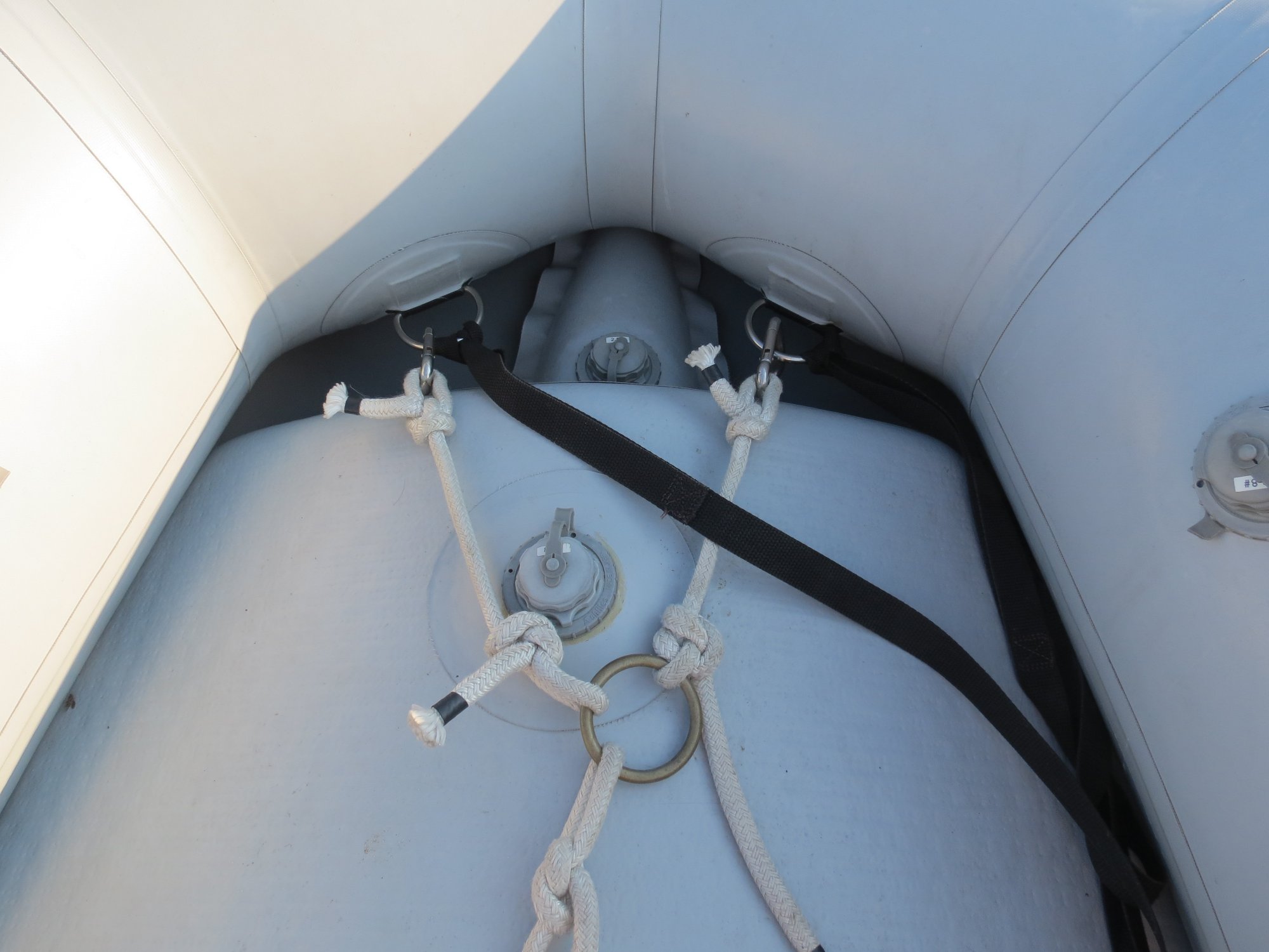

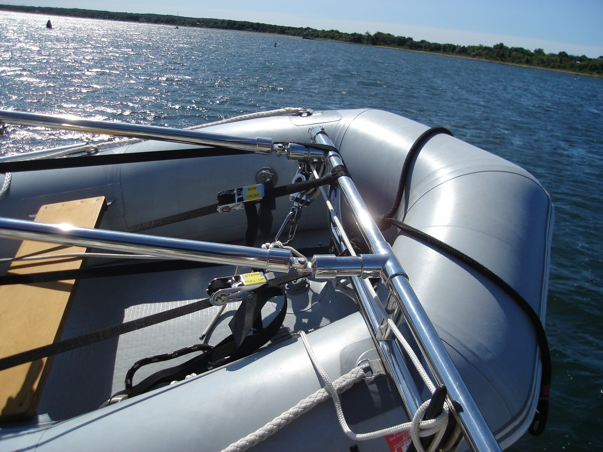

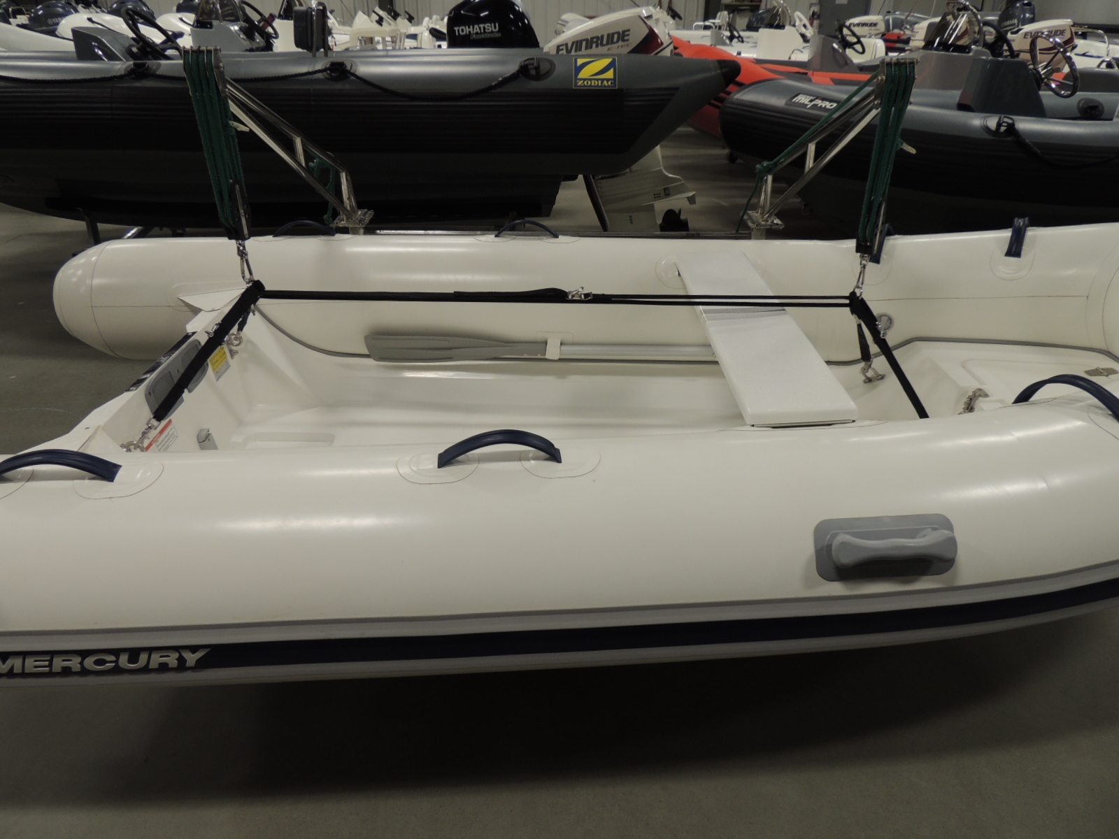

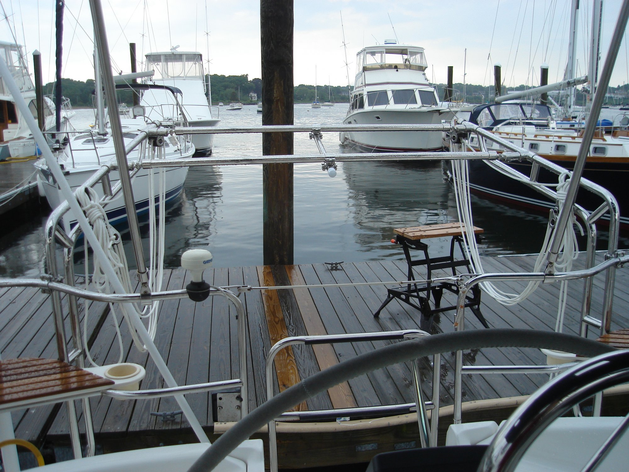

Here are pictures of my dinghy attachment points-
Note how I tipped the hoist ends of the davits in toward each other. This was done so that the hoist lines bend outward to the dinghy attachment points. This forms the trapezoidal shape of the hoist system. And additionally at the stern, it moves the hoist line away from the outboard to avoid chafe.
The bridal attaches to the eye bolts and to the D-rings with a connecting line. The hoist lines clip to the large round rings.
I thought I had a sketch of the hoist lines and the dinghy points that showed the trapezoidal shape but I can't find it. A study of the pictures should show the shape. The trapezoidal line configuration resists the swinging action of the dinghy athwart-ships.
Finally, I use four 1" webbing straps with ratchets to secure the dinghy to the davits.
They run:
Stern port eye to bow stbd on the davit
Stern stbd eye to bow port on the davit
Bow port D-ring to stern stbd on the davit
Bow stbd D-ring to stern port on the davit
I hope this helps.

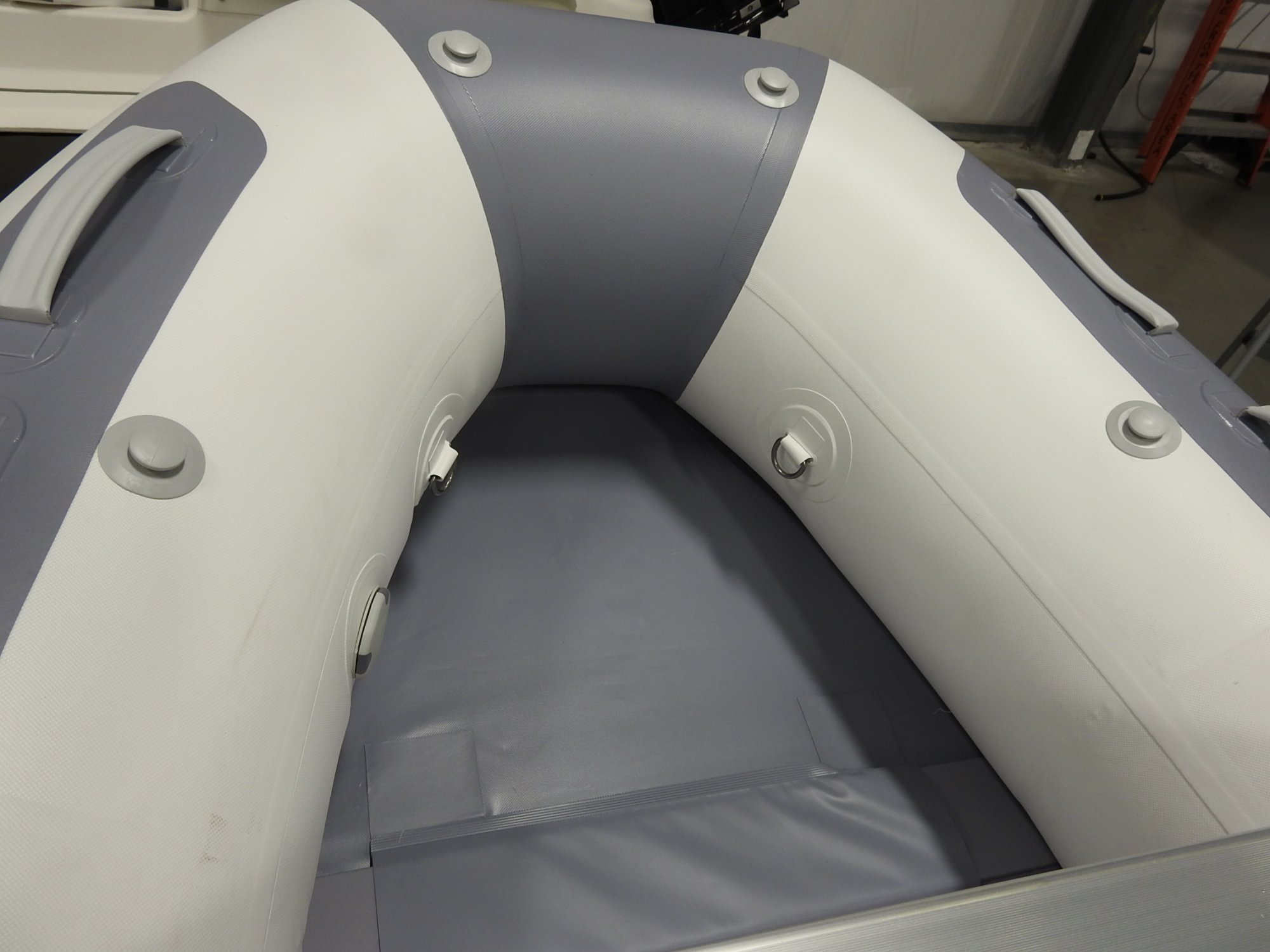

don;t know if I responded or not - washer in the proposed position - too high ? Washers taped onto positions I'm thinking about Too low To fa
r apart - any advice appreciated

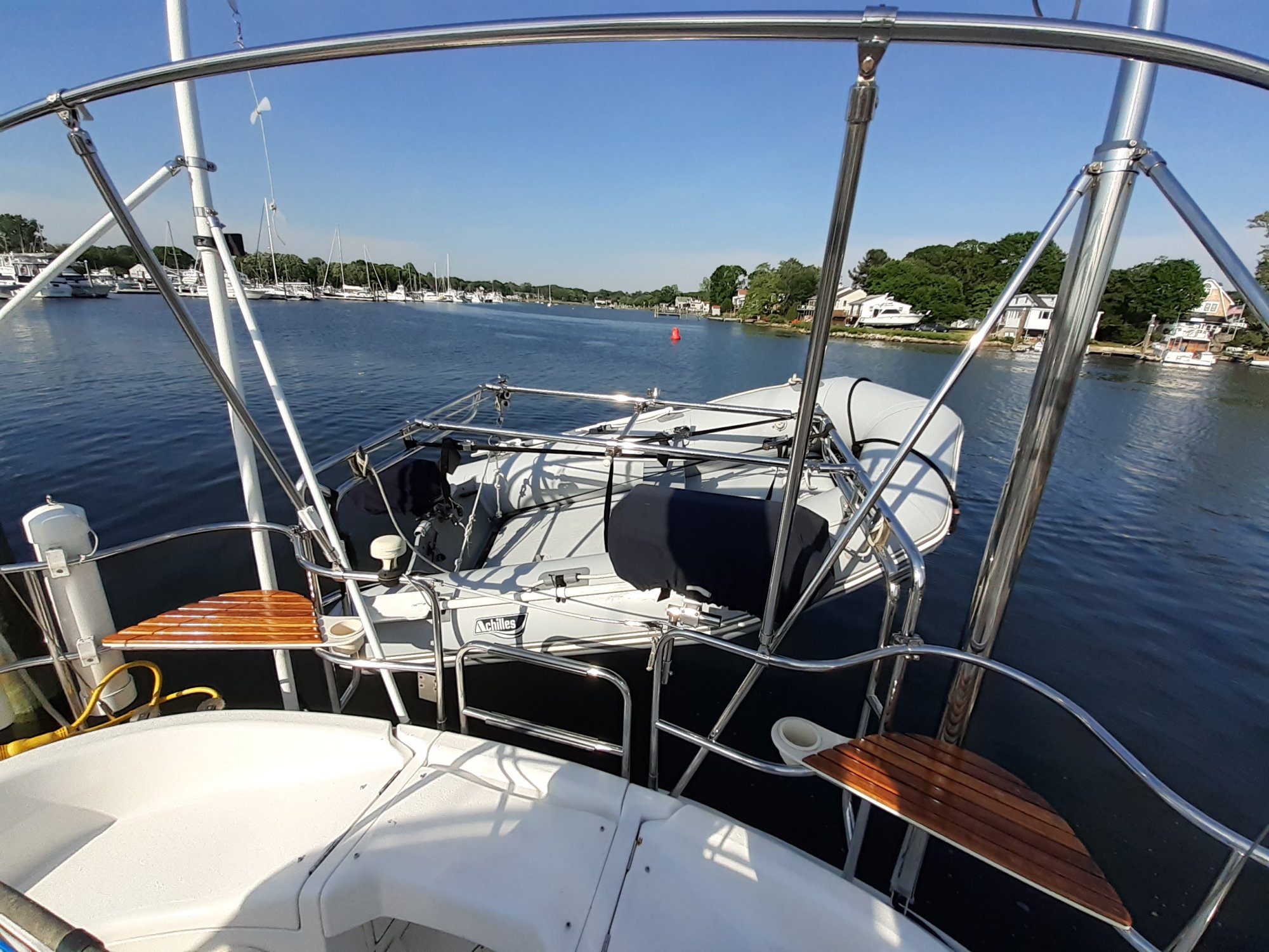

thanks guys - decided to try the patches first so I can roll it up - understanding it won;t hold the engine like is - will need the eye bolts Currently being tested in a very messy garage Glue set so fast I could not get the patches perfect - but seems like they will hold - and yes - the drain plug MUST come out !
Sep 27, 2008
225
Hunter 41 Longport,NJ

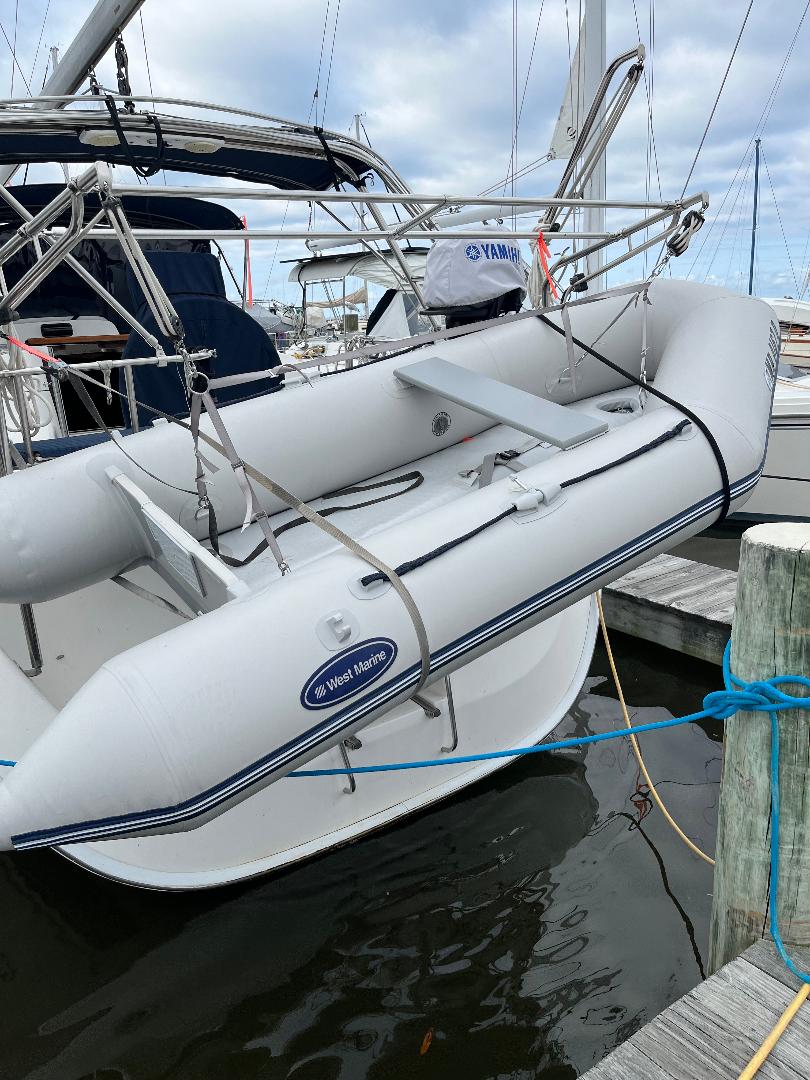

Update - works just fine. Four pvc patches and the air floor more than holds its shape. I did not put the lift eyes on the transom - thought they might interfere with folding the boat up. If I want to lift it with the engine on I'll put them on Photo shows the dingy tilted so you can see the setup - normally I have it flat with the bow up and drain plug out. As always - thanks to all for your responses - and, air floor on davits works just fine
