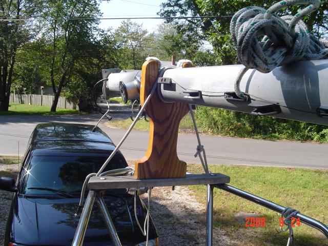

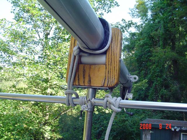

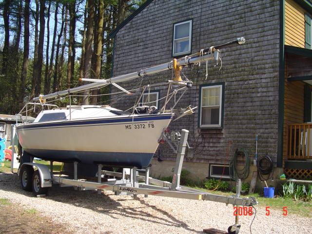

A picture is worth a 1000 words so I'll show you my boat ready for the road. If you plan on trailering all those miles, I would suggest an additional mast holder on the Tabernacle. I use Bungee cords and leave all my stays connected save the fore stay.
