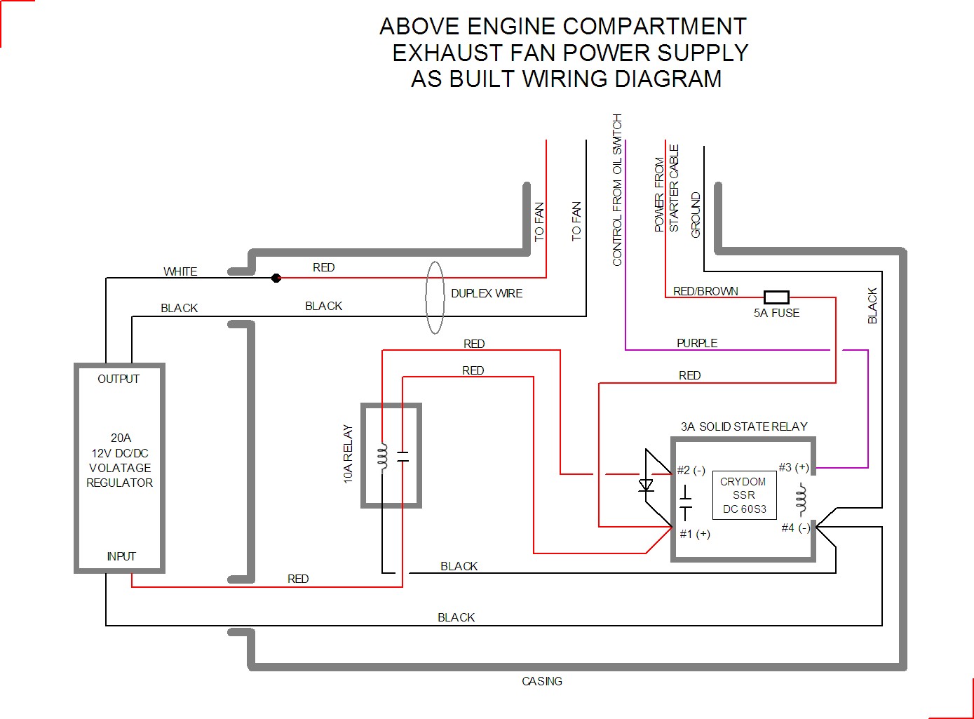

I would think a take-off from either either the oil pressure line or ignition switch would be more "automatic" and one less thing to think about when leaving the dock. Attached is a wiring diagram for the fan I installed in mine a few years ago. I chose to take the signal off the oil pressure switch just to reduce the electrical load (all of 4 amps) on the battery at start up. Never can tell when you might need it. The electronic relay is necessary or otherwise the low oil pressure alarm will always be sounding. The voltage regulator is required to keep the fan from launching itself out the window when the alternator output hits 14.7V.

Good day Ralph.
What program are you using to create the schematic above and can you attach meters, etc. to see loads, etc?

Absolutely nothing so sophisticated. It's a program called SmartDraw. What I like about it is that it has a huge library of parts for the artistically impaired. All electrical measurements come off the back of a dirty dinner napkin.
It's about as high tech as I want to (need to) go after retiring.

Thanks to everyone for the information. I am probably going with just the plain rubber booted toggle switch as Capta agreed and Semperavanti suggested. I don't want to attach it to the oil or ignition because I usually run the blower for about 10 minutes after shutting down the engine , as suggested years ago by Mack Boring and I could not even begin to figure out the schematic from Ralph. LOL. Now I can''t wait for a cool rainy day.

I usually run the blower for about 10 minutes after shutting down the engine. I could not even begin to figure out the schematic from Ralph. LOL.
No wait, WAIT ! ! !
You could install a delayed OFF switch in that whole mess to really make things really interesting. I had thought about a delayed OFF switch in the circuitry but was concerned that there was always the possibility of the switch not functioning (for some unknown reason and unbeknown to me) and I stood the chance of running the batteries down when I was away from the boat for an extended period and not plugged in to shore power.
