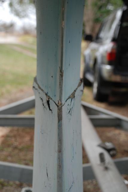

Recently, I have started to think about sailing again and have been plotting to restore the boat and get it back in the water. A couple weeks ago, I went to check on the boat and make plans to bring it to my house (about a two hour trip). When I got to the boat, I was immediately confronted with a keel issue that was not evident the last time I inspected the boat (late summer/early fall of 2009). Two things have happened. First, there is now a gap between the fiberglass stub and the top of the keel. It measures 1/8" at the leading edge and 1/16" and the trailing edge. There does not appear to be any damage to the bottom of the stub, and neither does anything appear amiss in the bilge with the keel bolts (they look to be SS, with double washers, bedded in 5200). The trailer keel pad has deflected under the weight of the keel, but the hull is well supported by the trailer bunks.
More alarmingly, the keel immediately below the stub has the appearance of particle board that has gotten wet and expanded out. This is mostly just below the keel/stub joint.

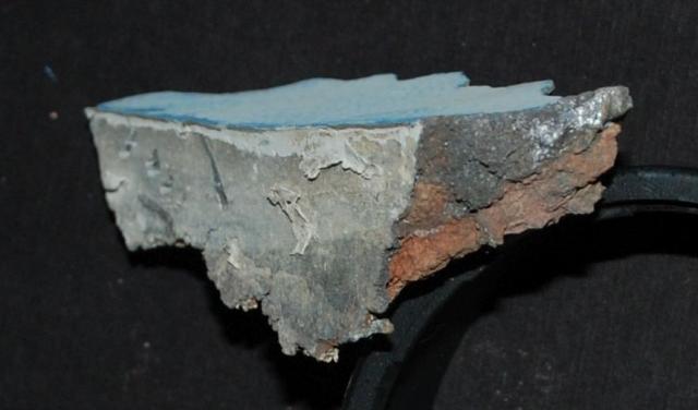

I was of the understanding that my keel was entirely made of lead, but there seems to be some other material under a thin layer of lead, at least at the top of the cast keel. It looks, and feels, like very hard clay. This brick red material appears to be what has expanded and pushed the lead out. I recently have read about Catalina using a lead saturated brick for their keels, is this something Oday has done as well?
My first thought was that somehow water had gotten in the boat and had leaked down through the stub, and then had frozen during the recent cold snap (the boat is near Charlotte, NC). However, the bilge is bone dry and does not show any signs of moisture.
The missing chunk on the keel is from where I pried a flaked out piece loose, that is the piece shown in against the black background in the attached photos.
I'd love to hear some thoughts on what's going on here and what the best approach to dealing with it is. I have searched this forum and other, but have not found anything describing a similar situation. I'm at a lost to explain how the keel would have separated more or less uniformly from the stub. The keel bolts look to be in good shape, as does the bottom of the fiberglass stub (from top an bottom).
The damage really does look to have been caused by expansion due to freezing, but this does not make any sense to me as the boat couldn't possibly be any drier that it is after five years out of the water. I also can't figure out how the gap in the keel/stub joint relates to the flaking. Is this something that has occurred because the boat has been on the trailer for so long, or is it just the age of the boat and this would have occurred (just with more dramatic consequences) if it were still in the water?
