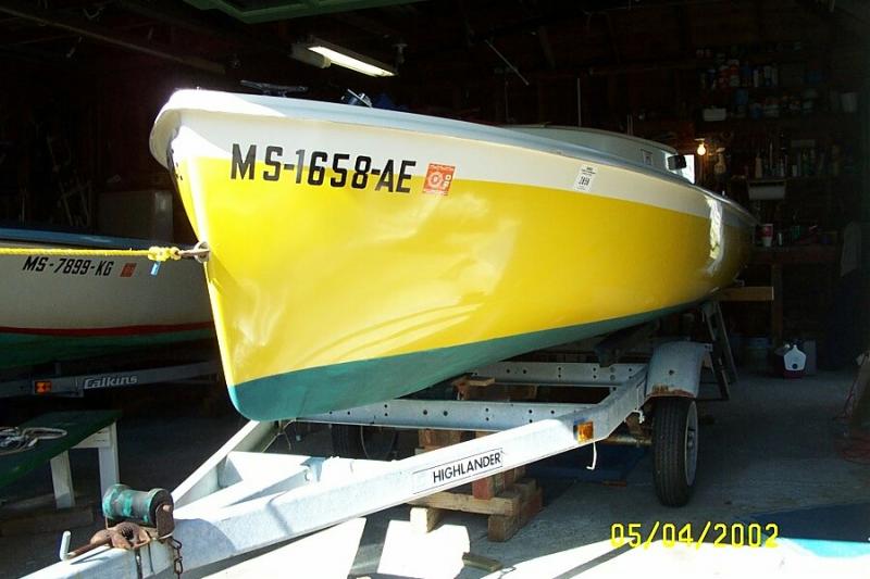

I restored my boat's topsides gloss with fiberglass rubbing compound and a good buffer the first Fall. Now a once over with a oxidation remover (a very mild liquid rubbing compound, Meguiers?) each Spring and a few coats of a good marine paste wax keeps the shine.

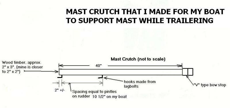

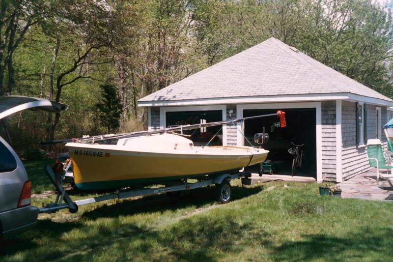

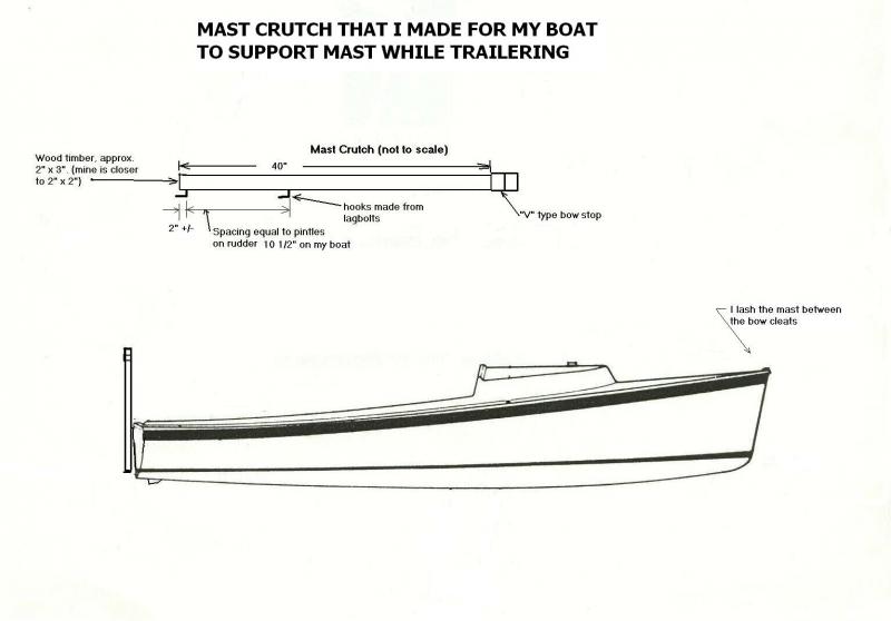

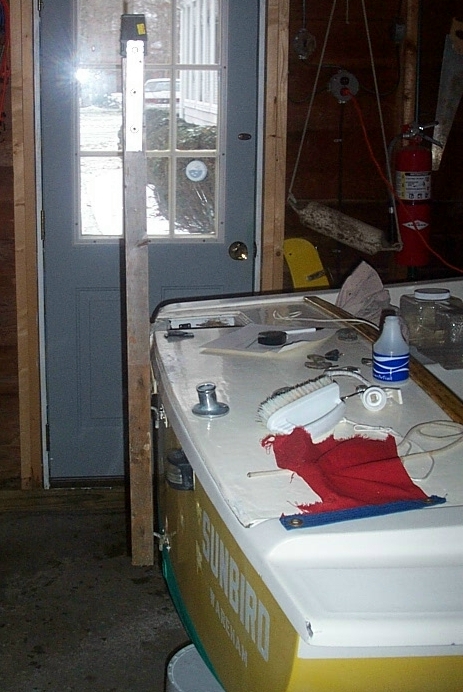

I've added pics of my mast crutch used when trailering (well, back and forth to the ramp). I also added a pic that shows my boom crutch (O'Day original) It works good for the boom but won't really work for supporting the mast.
