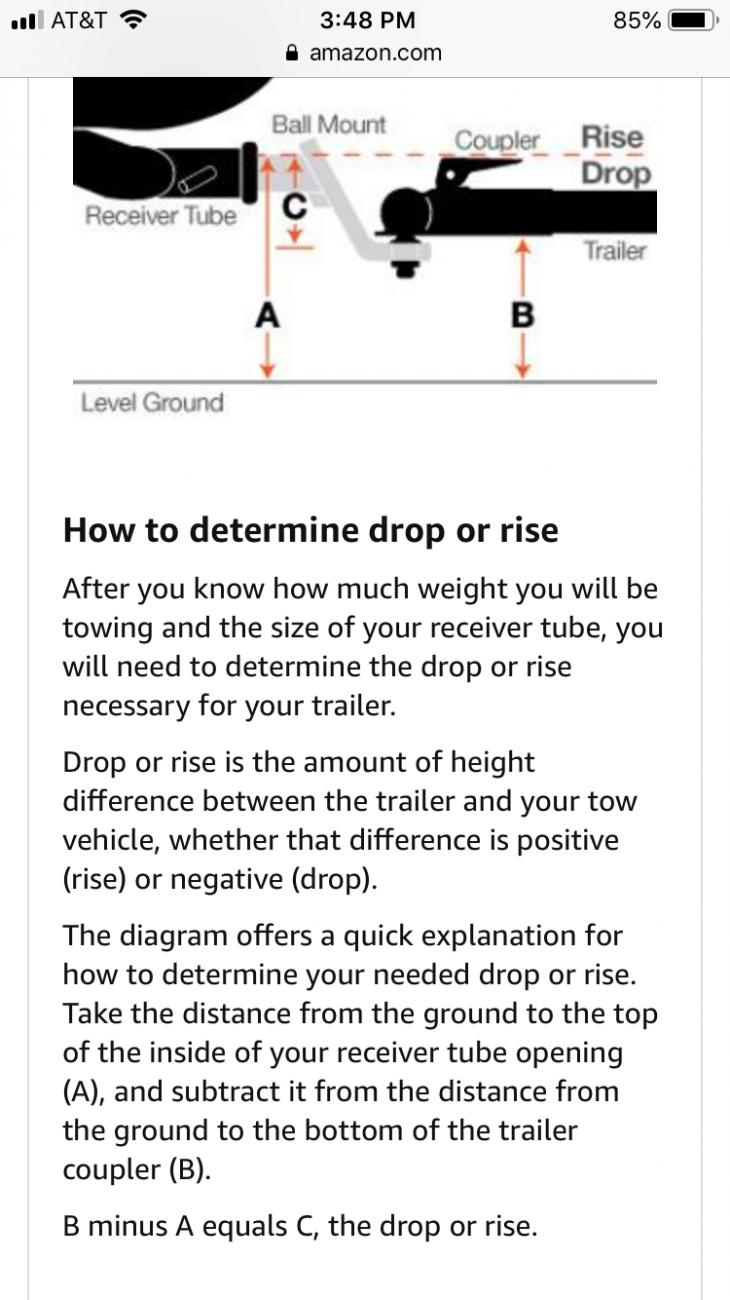

kenr74
May 3, 2019
46
Magregor 26S Oregon
For my 26S to sit level on the factory trailer I have the top of the ball at 17".
Jun 3, 2004
1,863
Macgregor 25 So. Cal.
Can you not just level your trailer(or a little lower) and measure and then measure your tow vehicle and go to the nearest auto parts store and get what you need? No need to go all the way home.;)
May 24, 2004
7,202
CC 30 South Florida
The ideal height of the hitch and tongue connector is to have the rails of the trailer parallel to the ground with the correct tongue weight on the ball. Since the trailer is not available I would suggest you purchase an adjustable hitch for the receiver. You can adjust height and tongue weight with it. Get one rated for the load and tongue weight of your trailer.
