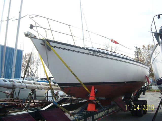

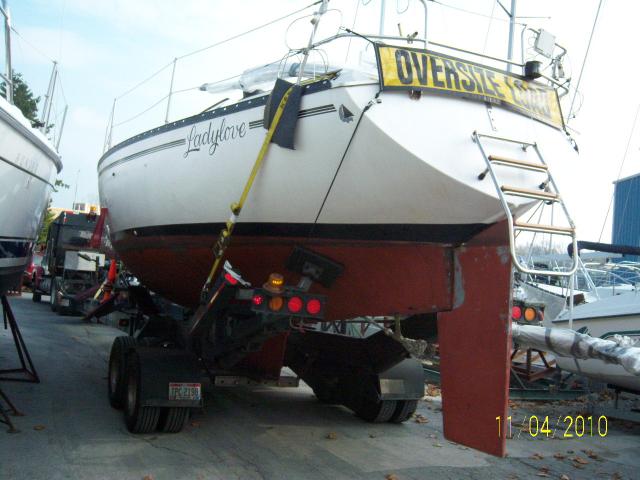

Jun 2, 2004
5,802
Very similar to my own that just shipped from Florida to Ohio. As you can see the keel was less than 12" from the road so height was not a problem.
