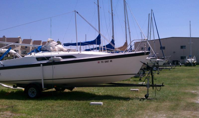

I went to the boat today and took some measurements.
From waterline to the base of the mast is about 4.5 feet. My stock gin pole is shorter than yours, TB, only about 6.5 feet. So with the mast lowered to no higher than the gin pole, the height is about 11 feet above the waterline. I took the picture some time ago. I wish I'd taken the measurements then.
With the mast no higher than it would be for trailering, the stock mast support on the stern, supporting the end of the mast, is about 7 feet above the waterline. That's the lowest height my boat can fit under, on the water, without going to a lot more trouble fiddling with the mast.
