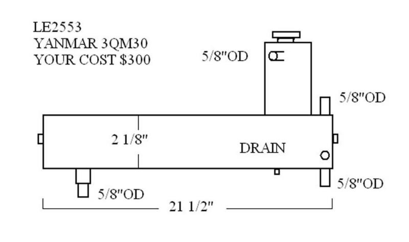

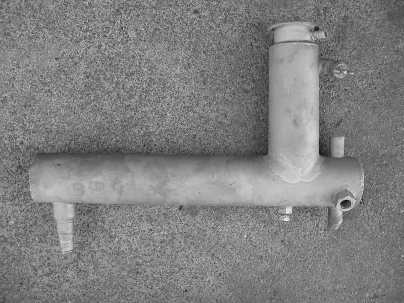

Hello RythmS:
I'll be at my boat tomorrow and will take a picture of the heat exchanger mounting on my 1980 H36 -- also in the port lazarette. It's a Send-ure 2550. Until then, a picture and a drawing of it, done five years ago are attached. (These from my archives done at the time that I brought the exchanger to a radiator shop that also specialized in marine heat exchangers. Mine had pinhole leakage between the salt and contained circuits. Fixed successfully -- so far -- for about 40% cost of a new one.)

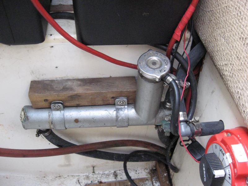

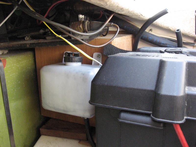

Dear RythmSurfr:
Took a couple of pic's. Not the prettiest part of my boat. Wires and tubes aren't aligned in any consistent direction. Shows my heat exchanger location in the port lazerette. My guess this was the original Hunter location. Picture was taken from the aft side looking forward, so the engine compartment is to the right. When I bought my boat, one of the batteries was under the exchanger strapped onto to the interior liner floor.. I didn't like it there so I moved it next to the other one on the battery shelf. But the space was occupied by the refrigerator compressor. It wasn't working so I tucked the compressor out of sight. You can see it behind the over-flow tank. Eventually, if I ever do decide to start using my boat for a living space for more than a a couple/three nights, I will disconnect the compressor and ask an expert to determine if worth repairing. But I expect I will instead find a way to tuck a more modern Dometic type refrigerator/freezer somewhere in the galley area rather than restore the original cold locker.
I have thought about moving the heat exchanger into the engine compartment. But that makes removing the pressure cap to check the coolant level and also adding new coolant much more of a task.

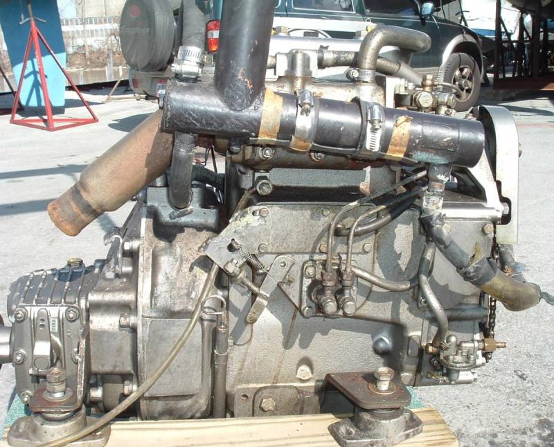

I am really surprised at how these installations were done. I no longer have the 2QM20 but kept the pictures. As you can see the heat exchanger was mounted on the engine.

Well I am still unsure of what to do. I would think that you wouldn't need to inspect it. If you were loosing coolant I would think it would show up in the bilge. After looking more closely at the system yesterday I noticed one of the coolant hoses had a nick in it where the "big round disc" (unsure of the name) attached to the drive shaft rubbed it. I don't think that would have happened if the heat exchanger was attached to the engine. The hoses are just too long and don't give a neat look. Not to mention I don't have any compartment/walls around the engine. I will let you guys know. I have to think about it some more.
