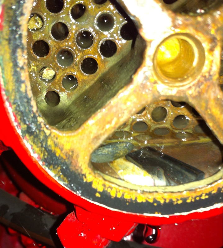

I am still getting some smoke/steam out of my exhaust after replacing the impeller over the winter and am afraid the two fins that broke off the old impeller are in the heat exchanger and restricting flow/cooling. Not sure if the water flow out of the exhaust is good since I may have never seen what normal looks like. Anybody pulled the heat exchanger apart or have any advice?
I also noticed that, in 2004, Westerbeke replaced the raw water pump on the 30B. Should I just replace the raw water pump to avoid future problems (asumming they did it for a reason)?

Not very hard to do. Simply pull the end cap and you should find the pieces. You should also replace the gaskets for the caps at the same time.
You will want to pull the other end as well, since it probably has zinc debris there from the pencil zinc at that end.

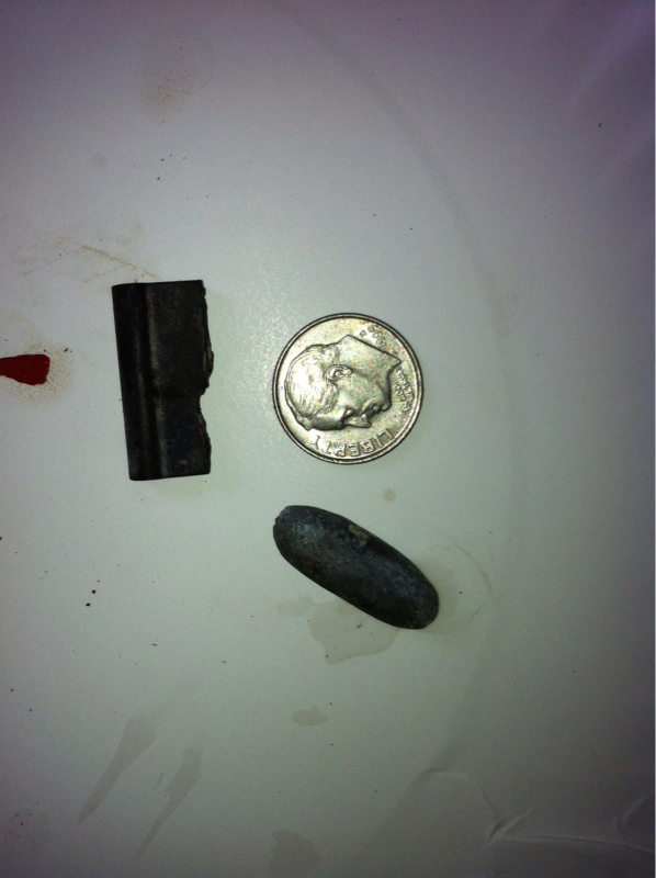

Thanks I did that today and see the picture for results. I am assuming the other fin broke up because it wasn't in the exchanger or the hose between the pump and exchanger. The other item is a small stone. Might have been a sinker at one point but appeared to be pretty smooth from years of rattling around in the exchanger! The dime is just for size and was not actually in the exchanger. Got everything replaced and ran engine for close to 1/2 an hour with no smoke. Hopefully that got it. Thanks again!

That's not a stone, it's a piece of the old zinc.
Instead of just looking in the ends of the HX whenever I suspect anything wrong, I take the whole thing off. In many cases one of the inlet ports gets fouled with salt precipitation, which you wouldn't know about unless you removed the HX.

Have not replaced the zinc yet - that makes since - it's a freshwater boat so hopefully there will not be a lot of salt deposits.
