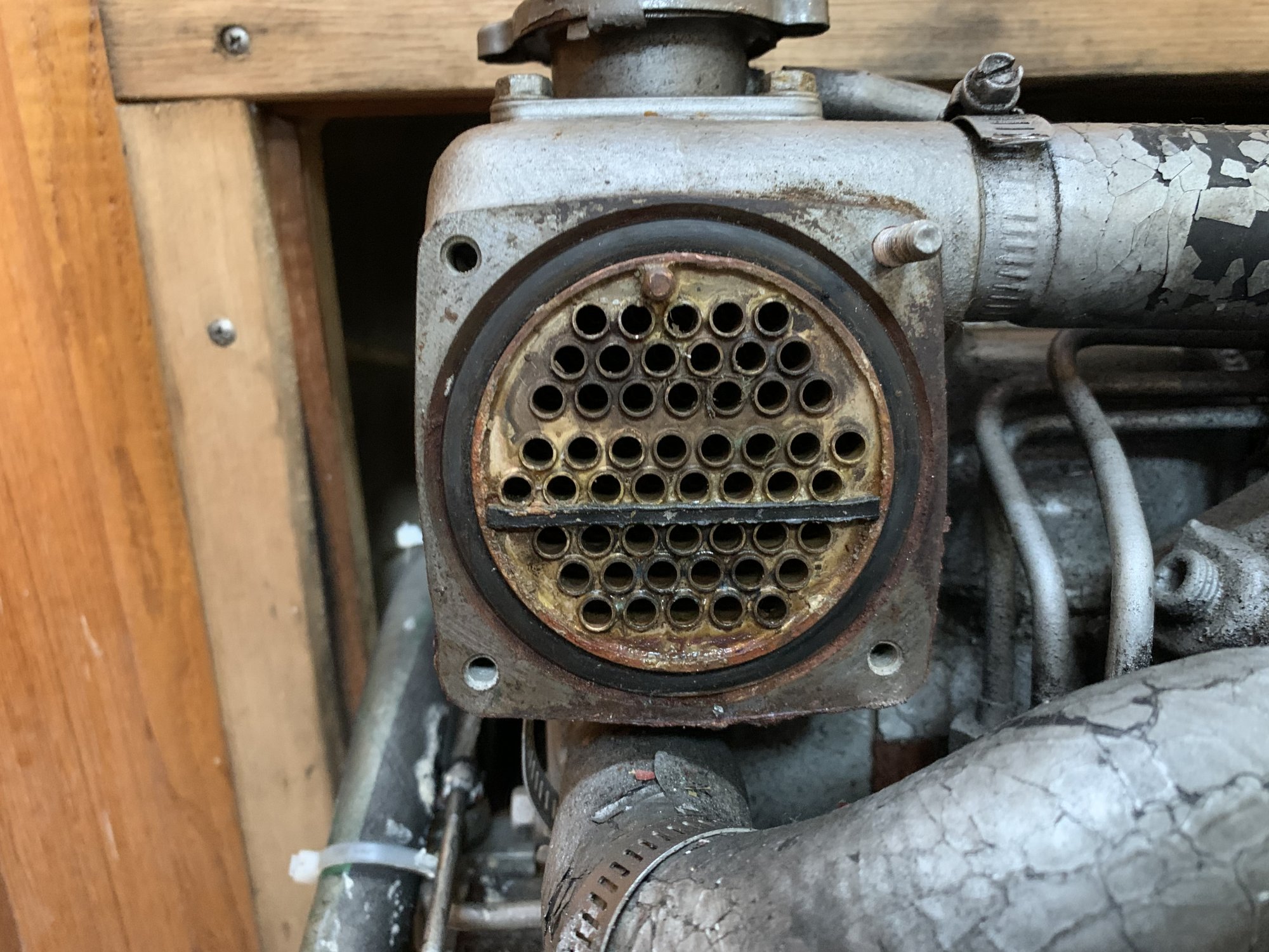

I pulled the cover off my heat exchanger yesterday and this is what I found. I penetrated the holes with an awl that would only go in about an inch before the awl was too thick to pass further. Finding no resistance, I left well enough alone. This morning, I found a great topic about this from a thread in 2015 titled "3GM30F heat exchanger stuck!" but I find that I still have questions.
I could not extract the cylinder. I tapped lightly with a screw driver and hammer around the perimeter of the cylinder but did not want to cause any damage. I also tapped on the pin. Nothing seemed to even want to break free. That black ring that looks like a rubber O ring felt metallic to me and that also would not budge. I couldn't tell if that was supposed to come off or not. The groove around the outer perimeter looked like the location where an O-ring should be placed, but I did not have one in that size (there wasn't one there when I opened it).
The diagram that @Allan12210 helpfully posted shows a gasket & an O-ring behind the cover. I couldn't tell from looking at the pin that it is actually a separate component. It seems fused to the cylinder to me. How would you approach removing the cylinder, and would you?

The black ring is in fact an O ring. It is likely baked hard and removing it will destroy it. The black strip separates flow of water to make it go through the cylinder, it appears like twice. (On my 2gm this feature is a little different, but similar). The pin is fixed and it fits in a recess in the end cap to orient the cylinder to keep the flow of raw water flowing through the tubes in correct orientation. There is an O ring on the other end cap that is also likely baked into place. With the back cover off, it should be easy to tap the cylinder out. You will want to have all O rings and gaskets on had before you disassemble. Sorry you didn't get down to AC.

Ah!! I didn't think to look at the other end. I'll take another look. Is it appropriate to replace that cylinder after 20 years of service?

Shouldn’t have to replace it if you don’t poke holes in it while cleaning. A piece of wooden dowel is best but I use an old .22 cal. Rifle cleaning rod. ( different engine so maybe different size)

Remove cylinder, Drop in a bucket of vinegar or brick cleaner and you have a new unit.
(Commercial descaling chemicals are usually made of either of these.)
Soaking cleans the interior and exterior of the tubes which also retuns the sytem to full efficiency.
Never poke anything stronger that a bamboo stick into the tubes.
The tube walls are thin to allow effective heat transfer, so chemical removal of built up is the only way that the should be cleaned.

and when you open the ends have all gaskets ready to replace. The rubber gaskets are part of the reason Yanmars mostly do not have engine zincs.

Yanmar's recommendation a couple of years ago was to take the heat exchanger out as described above and take it to a
radiator repair shop and have them clean it. Supposed to come back looking like new.

Wow! I looked at the price for a replacement core … $1050. Better take care of that baby!

A shop that specializes in heat exchanger work may be able to rebuild he old one (replace tubs) for less than new cost..

You can buy a lot of Vinegar and small diameter long knitting needles for $1050... i did this ht exc clean on my 2 gm20 f . found the yanmar price for the special order weird end gaskets of the ht exch would buy a whole lot of auto store formagasket . Which held up just Fine and is easy to carry in the proverbial on board tool kit..

:plus:With Michael. The 22 cal rod fit my HE. After playing with it I took it to a radiator shop. For $65 they cleans it out. Pressure tested the unit and painted the case.
Works perfectly now.
