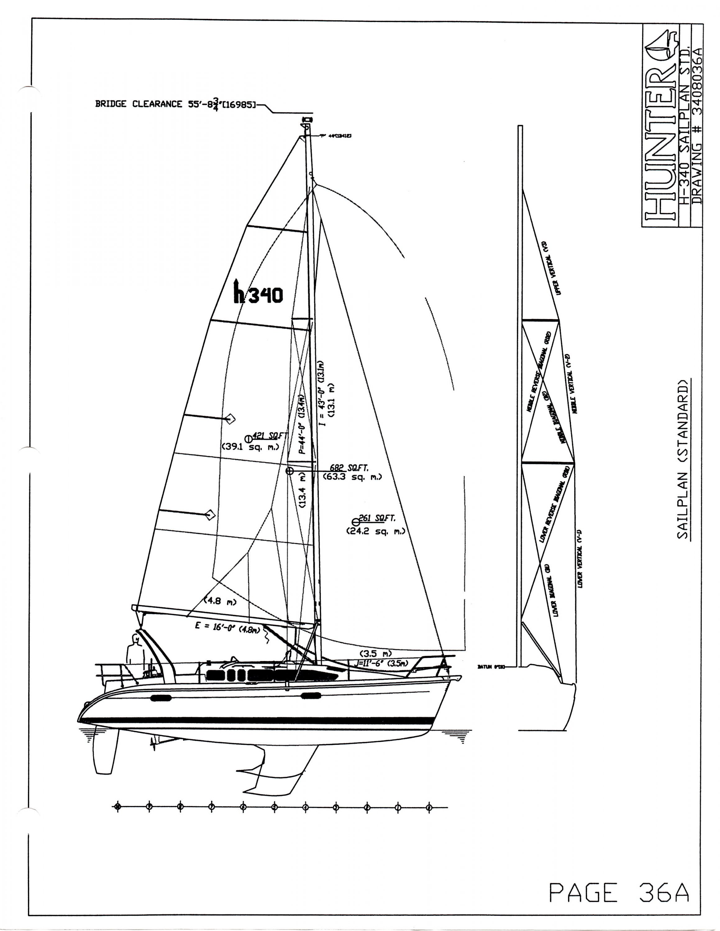

Welcome aboard, and hope you enjoy your H340. Yes, the standard size is a 110% genoa, see the attached page from the owner's manual. Our boat still has the original UK sails, although I need to pull the jib off this spring for some repairs and cleaning. Did you get a nice binder with the boat full of useful information like this? :)

I know you'll love your 340, ours has been nothing but great for us. Hunter says the jib is a 110%, my PHRF certificate measured it at 108%. Every sail is probably a little different. I have a new main and jib on order from Quantum, should be in any day, there's a big race this Saturday, wish I had them for it, but we'll make do. I wanted a bigger jib to help balance the boat, Several people from the local loft measured and looked at the boat and said anything bigger would never set right because of the stays and struts of the B & R rig. I got to believe them, they make more money the bigger the sail, or they didn't want to take the risk of several recuts to make it work. They originally quoted a 125% and took about 5% off the invoice because they're only making a 108%. I would love to know if someone has made a bigger jib work on a 340 or 336.

Thank you for the replies. Yes Ed, I did get some paperwork with the boat. After looking through it again I came across a sales brochure that appears to confirm that the 110% jib is the standard equipment. Given what Bill's sail maker said after looking at his rigging,even though I have the furler I think I will play it safe and go no bigger than the 110%.

You CAN'T go bigger than 110. It will run into your standing rigging.
