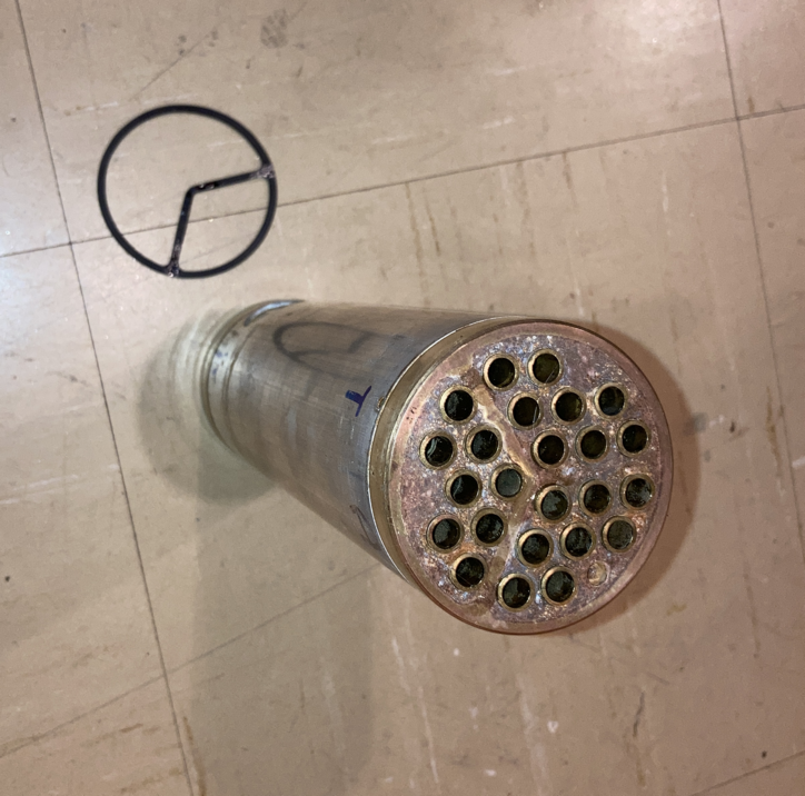

YIPES :yikes: ! You must be running around in battery acid to have it in that bad condition. I pulled and cleaned my 22 YO Yanmar HE and cleaned it with CLR household cleaner. Looked good on the sea water side after cleaning :
Reinstalled it in the housing and gave it an air test for a couple of days with no loss of pressure.
Yanmar has no zincs in the HE.

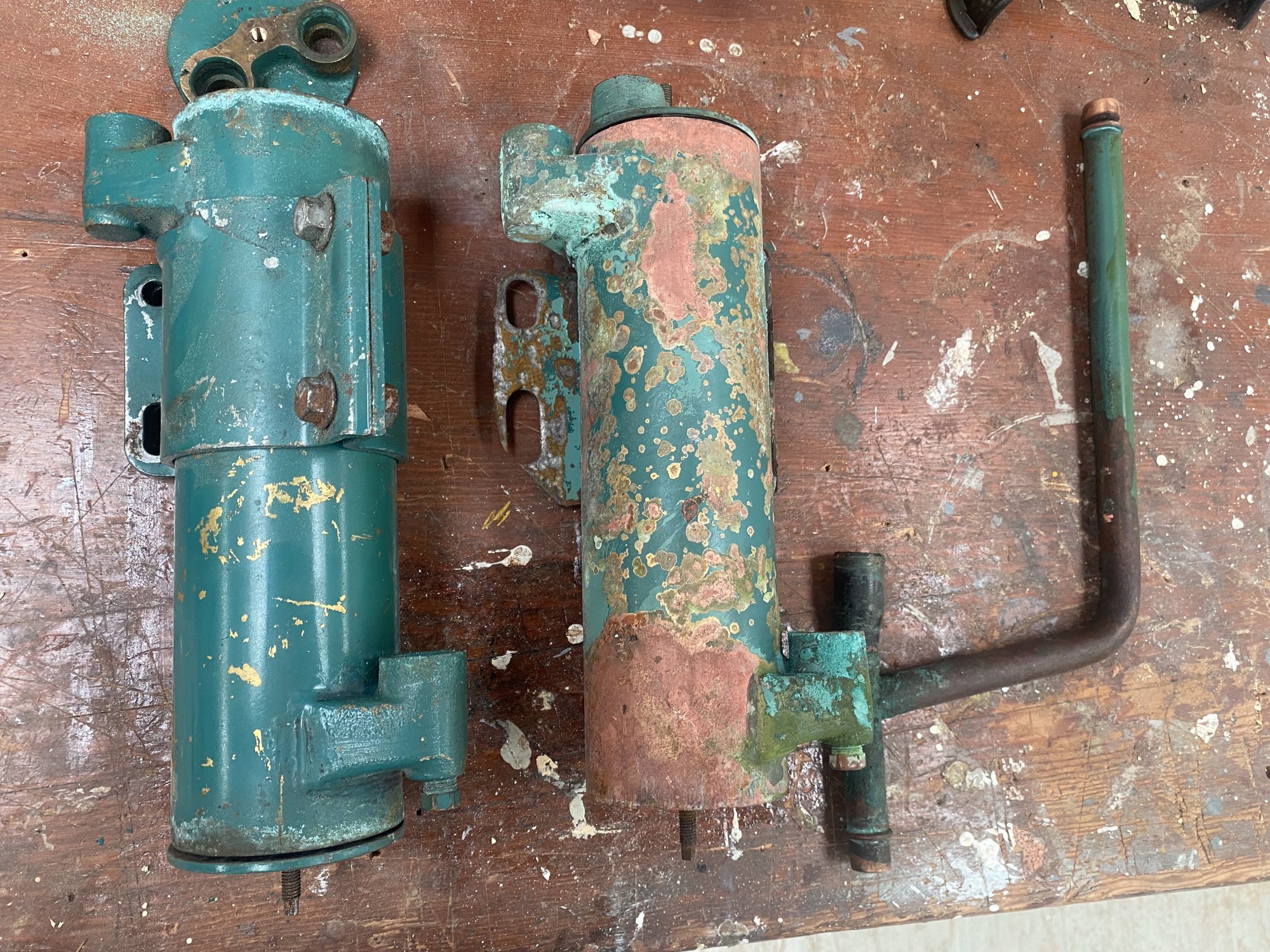

Well, as happens at my age I had a couple of things backwards. I did have a fixed bracket version but with different holes. The spare engine had had a clamp on bracket.
also in hindsight the y pipe may have ended up being bent enough to seem “short”. But one fit nicely and the other one didn’t, so that part may remain a mystery. Also the new installed bracket had one round hole and one slot so no options re positioning.
photo: (L to R)
Clamp bracket version with broken/seized ready rod
My H/E as it came back from the rad shop - even the bracket is partially gone
The “short” Y pipe.. maybe
Anyhow we’re all back together and after at least a half dozen start/run/stop/burp cycles it looks like the system is bled. Started out with a 20 deg C difference across the block front to back, now 2deg.
Test run underway tomorrow
