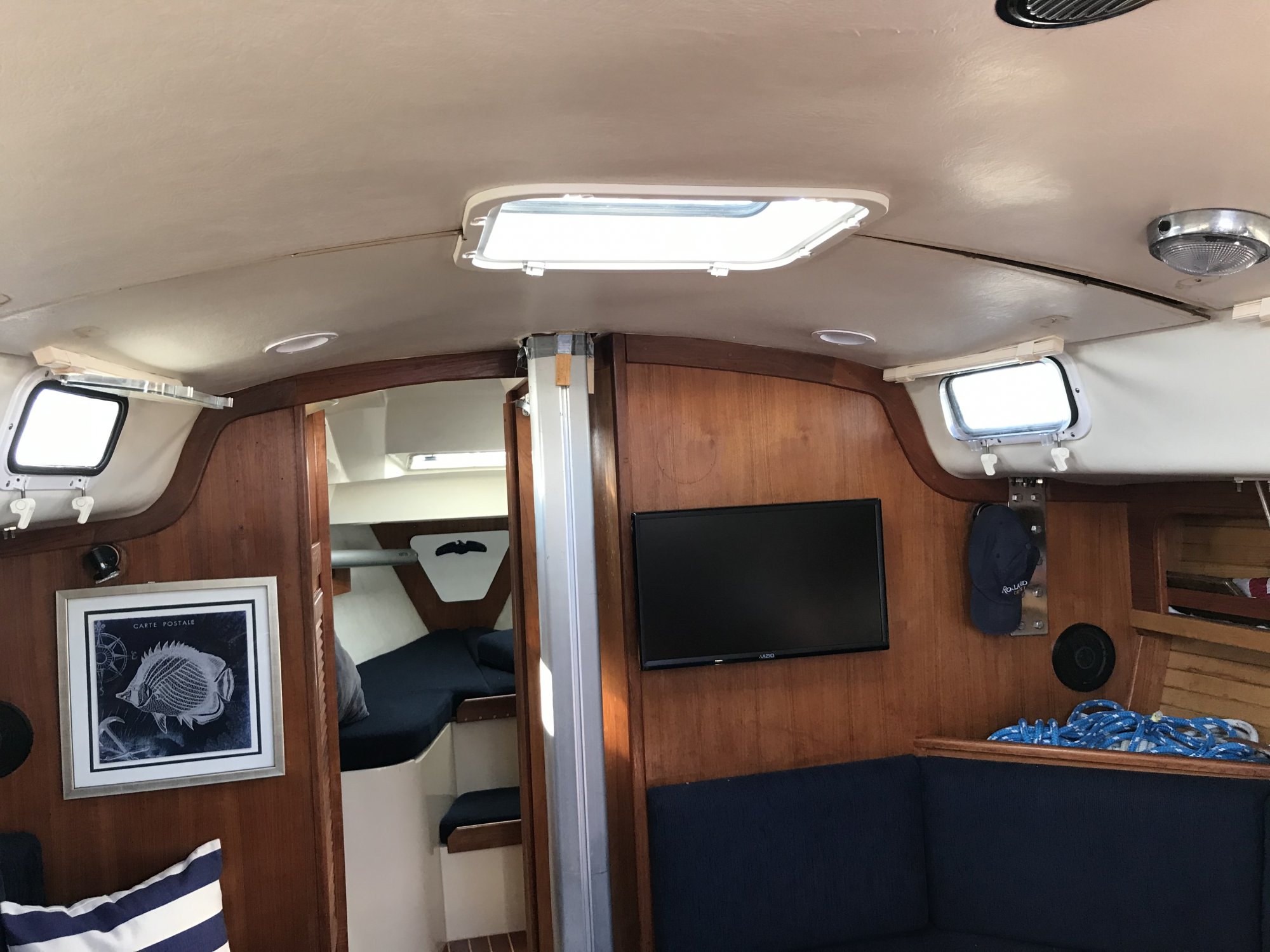

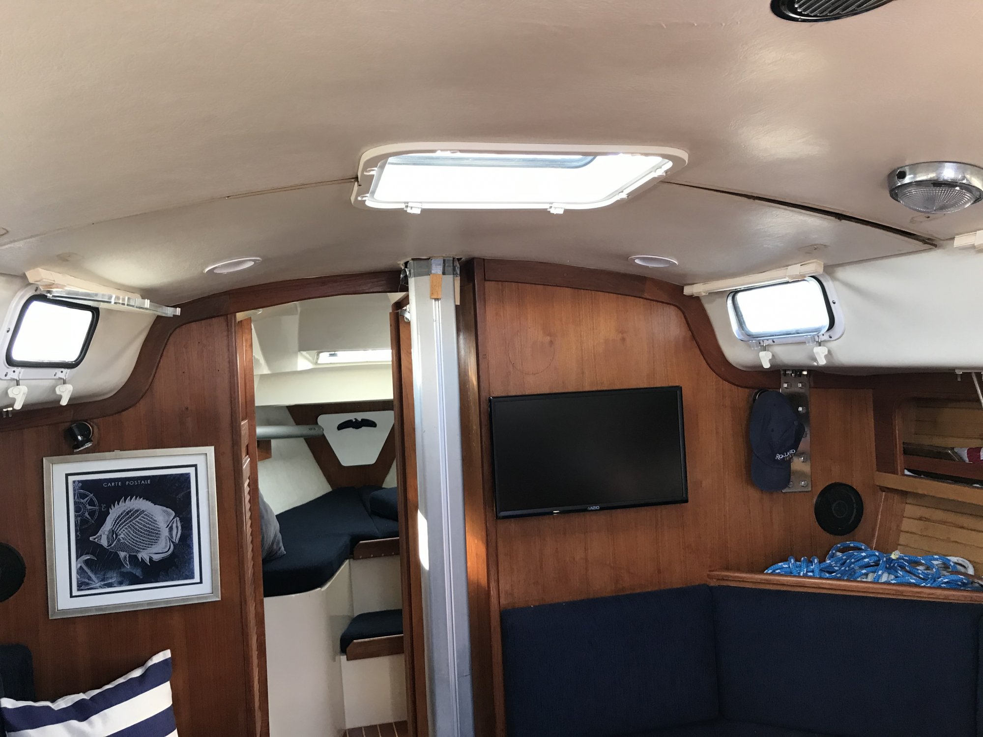

Hi all... I'm sure this has been brought up before, but as ideas and materials progress, I thought to bring it up again. I would like to replace my (leather-like?), zippered and stapled headliner with something fresher, providing better accessibility. What sort of materials are folks using these days. Any pics would be great! Cabin top is probably 12' x 7' at its biggest

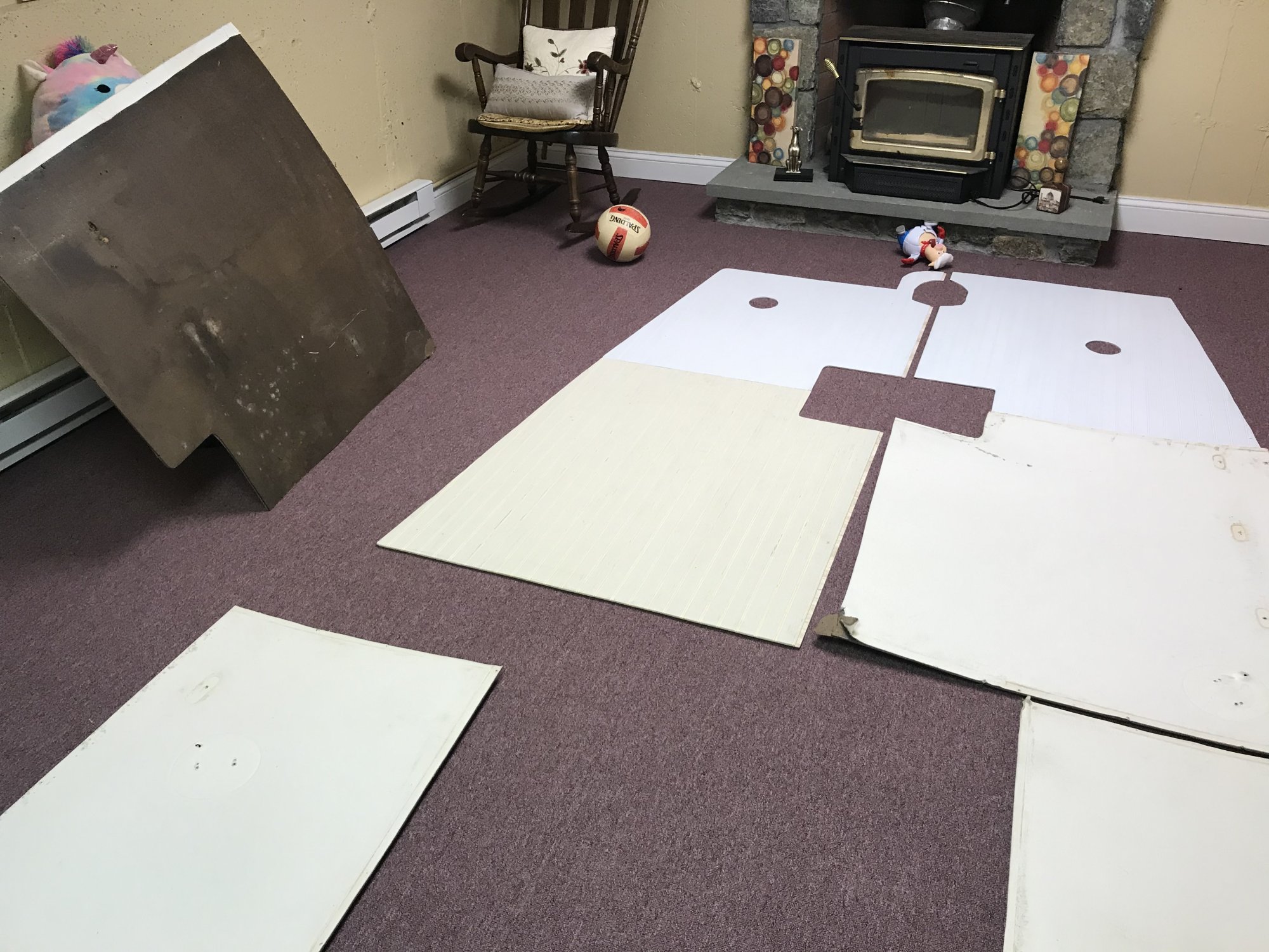

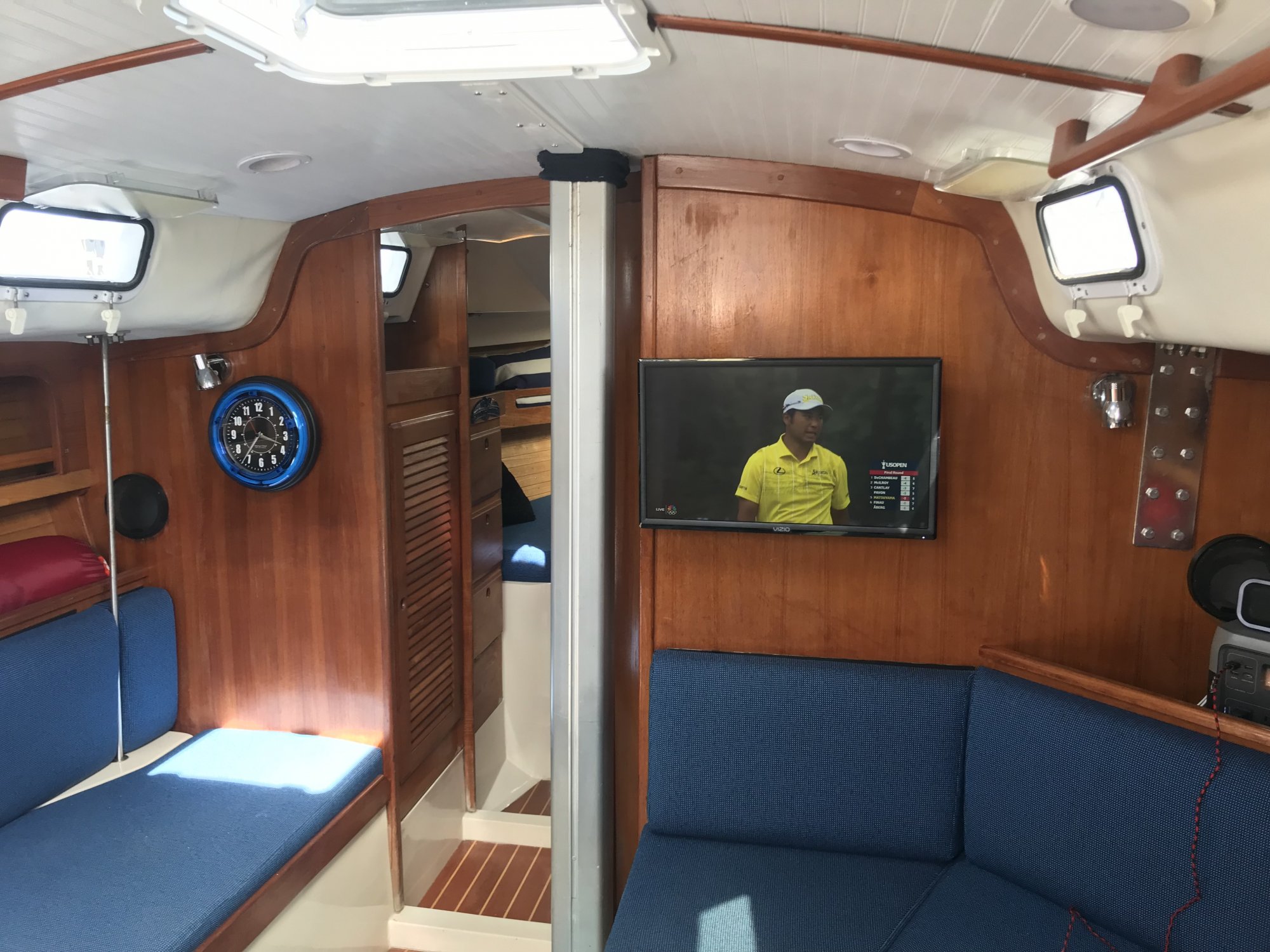

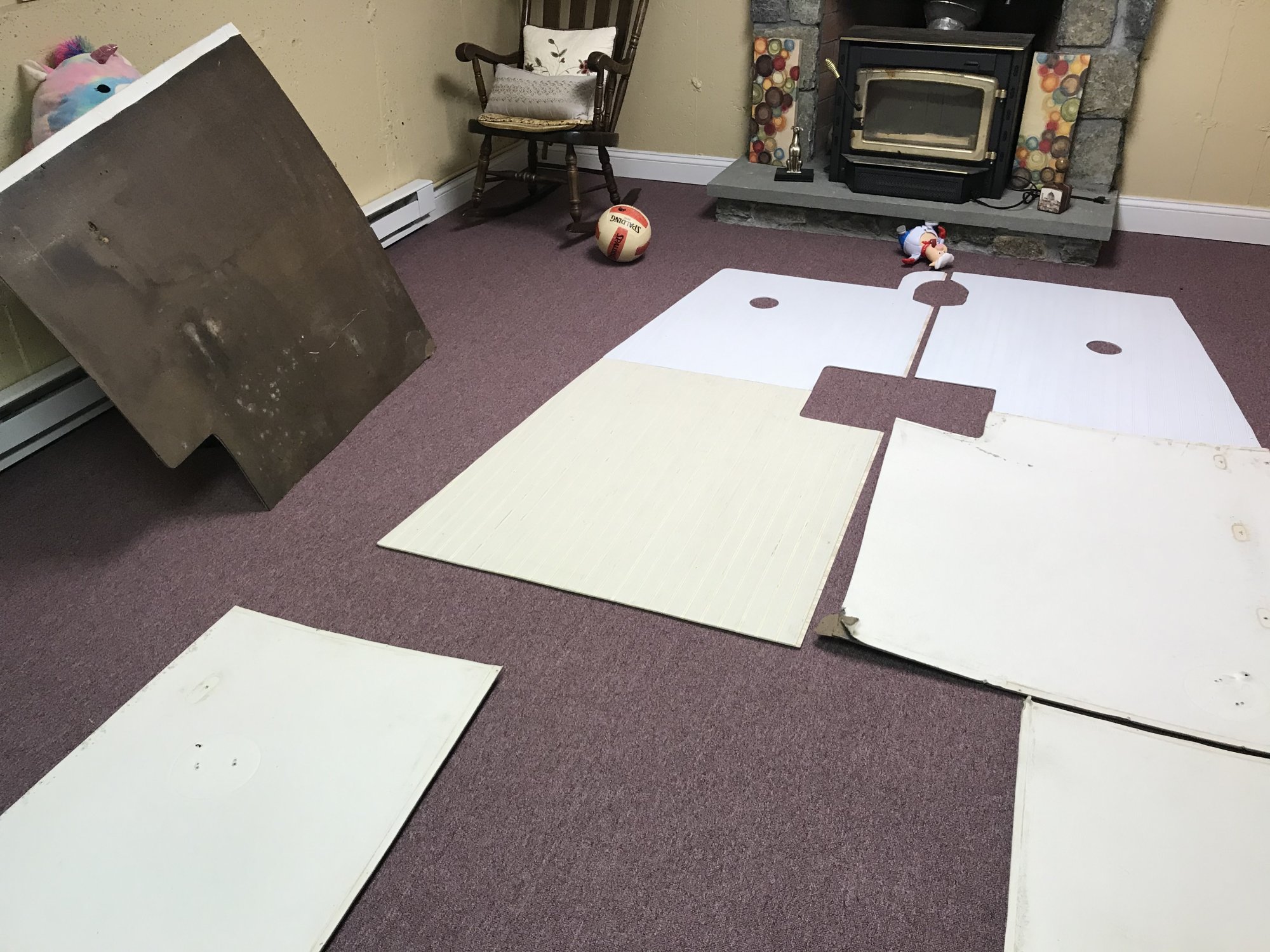

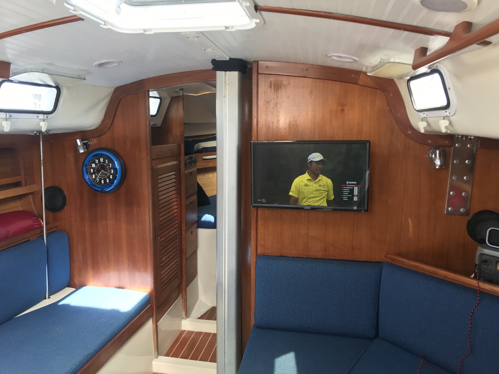

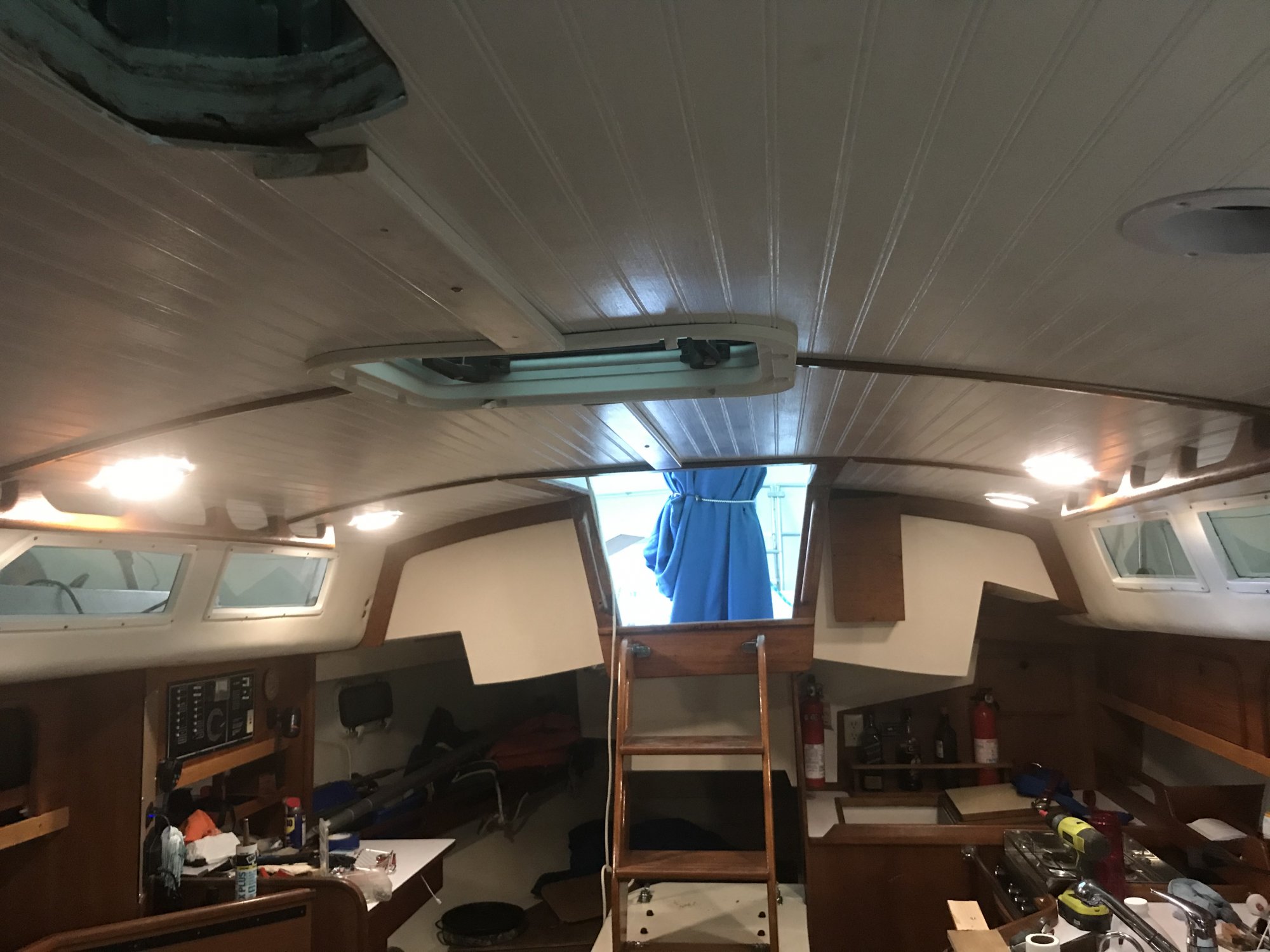

I replaced my vinyl wrapped masonite with wainscoting (bead board) panels painted white & solid teak trim pieces. Big improvement.

I bought 4x8 panels @ lumber yard, used old pieces as template, for stringers I fiberglassed some extra marine 1/2 “ plywood strips I had from another project matched existing stringers, panels are screwed to stringers. I needed more stringers because new headliner has 4 sections instead of original 2. The only thing I would do differently is to do the project sooner….like 20 years ago when I bought the boat.
