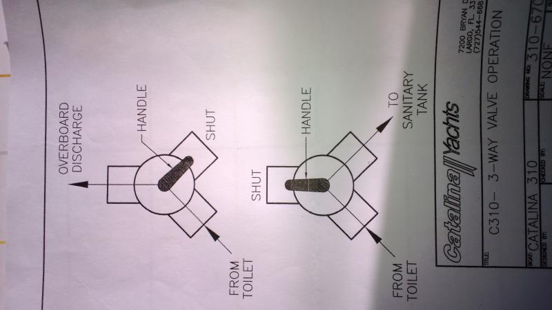

It sounds like you have a non-factory setup. We don't have any Y-valves in this area of the boat. The only Y-valve is under the galley sink and used to select either the refer or the shower sump for pumping out via the shower sump pump.
Our head water comes from a through hull in the little door down near the floor at the stern of the head. The larger through hull is the macerator and the smaller is the water for the head.
Here is the plumbing diagram from the owner's manual.
Maybe some photos of your setup could help?

Thank you Jesse. I too have two through hulls behind that little door. One for macerator
pump and smaller for flush water in head to holding tank. Will look for that head seacock
back in the "garage" area. Thanks for diagram.

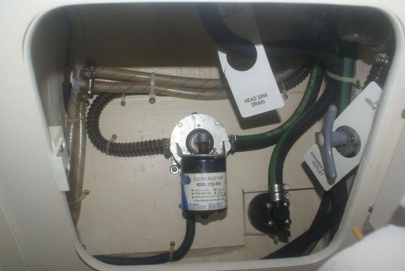

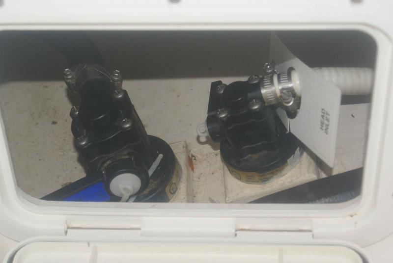

I've uploaded two pictures from my 2005 C-310, sail 307.
First is picture is of the valves under the sink in the head. The Y valve on the right switches between the shower sump drain and the refrigerator drain. The sink drains directly through the seacock on the left.
The second picture is the head valves. The valve on the right is the head inlet (seawater). I never use it, preferring sacrificing fresh water from the shower head to keep sea life from stinking up the place. The valve on the left switches between pumping into the holding tank or using the macerator and pumping overboard.
At least I think that is how it all works (and I'd be happy to be corrected by someone who knows). I'm not a big fan of the diagrams in the book. They could be much clearer.

Ray's right, it is simple.
However, and here comes the BUT: everything has to go through the holding tank. With a macerator, that's no issue to pump out legally.
With the addition of a straight through hull from the head to overboard, with the CHOICE of going to the HT or OB, has always been my favorite.
Your boat, your choice.
The BIG deal is for YOU to figure out how it works on YOUR boat, that's all.
Peggie has written repeatedly, even recently, about how doing this corrupt the hand head pump, since no water is coming in to it.
T into your sink drain for the last flush of the day and use Odorlos.
Head Odors 101.1 - "T" into sink drain: http://c34.org/bbs/index.php/topic,5755.msg38216.html#msg38216

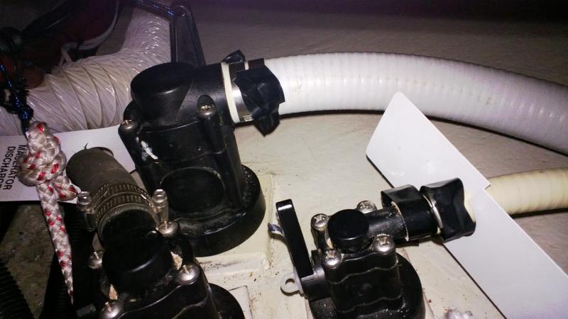

My boat no 149 has the Y-valve, together with 3 thru-hulls (behind that “little door”next to the throne) installed. According to the diagram it appears to be a factory instal.
Y-valve = a) Discharge to sea, b) discharge to tank
Thru-hulls = 1) Sea water flush inlet, 2) Discharge to sea, 3) Discharge from tank? (haven’t tried it). Latter two obviously for open ocean.

The first picture I posted is of the head shower sump pump and Y valve. It is under the head sink.

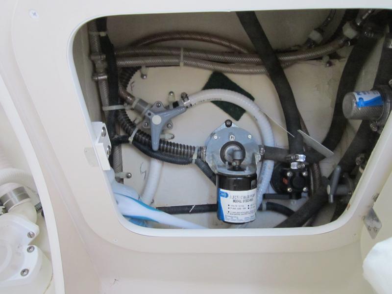

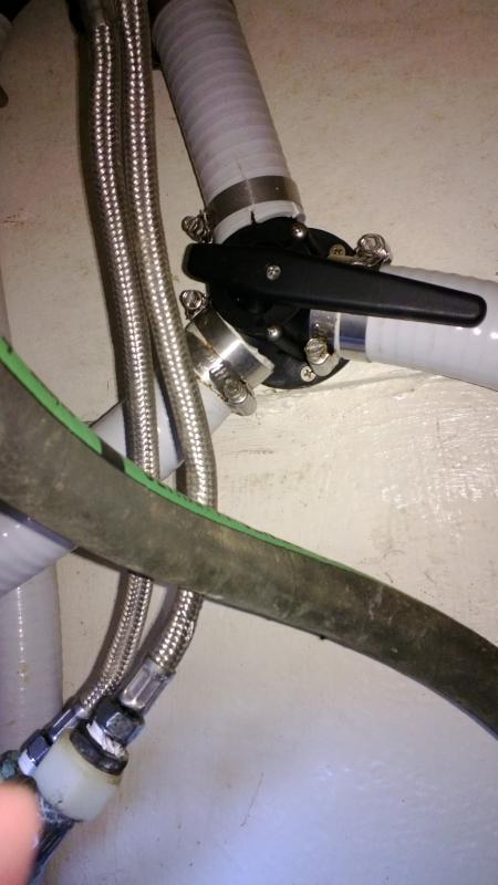

Further checking I too have head intake and marcerator valves behind little door
in bulkhead near the floor stern of the head. Attached photo of two Y valves
and seacock under sink. Seacock drain for head. Y valve on right side
for shower sump and reefer drain (thanks for that info.)
Now question what does Y valve do with two white hoses? Thanks for any
answers. Maybe to shower cockpit area?

If you look at the picture in my post #7, you will see that my boat doesn't have the Y-valve with the white hoses. The white hoses would appear to be the same as those used to connect the head to the water intake source.
My guess (and this is a total guess) is this modification was put in to allow switching from seawater intake to the head and freshwater intake (from the sink). Follow the lines and see where they connect.
