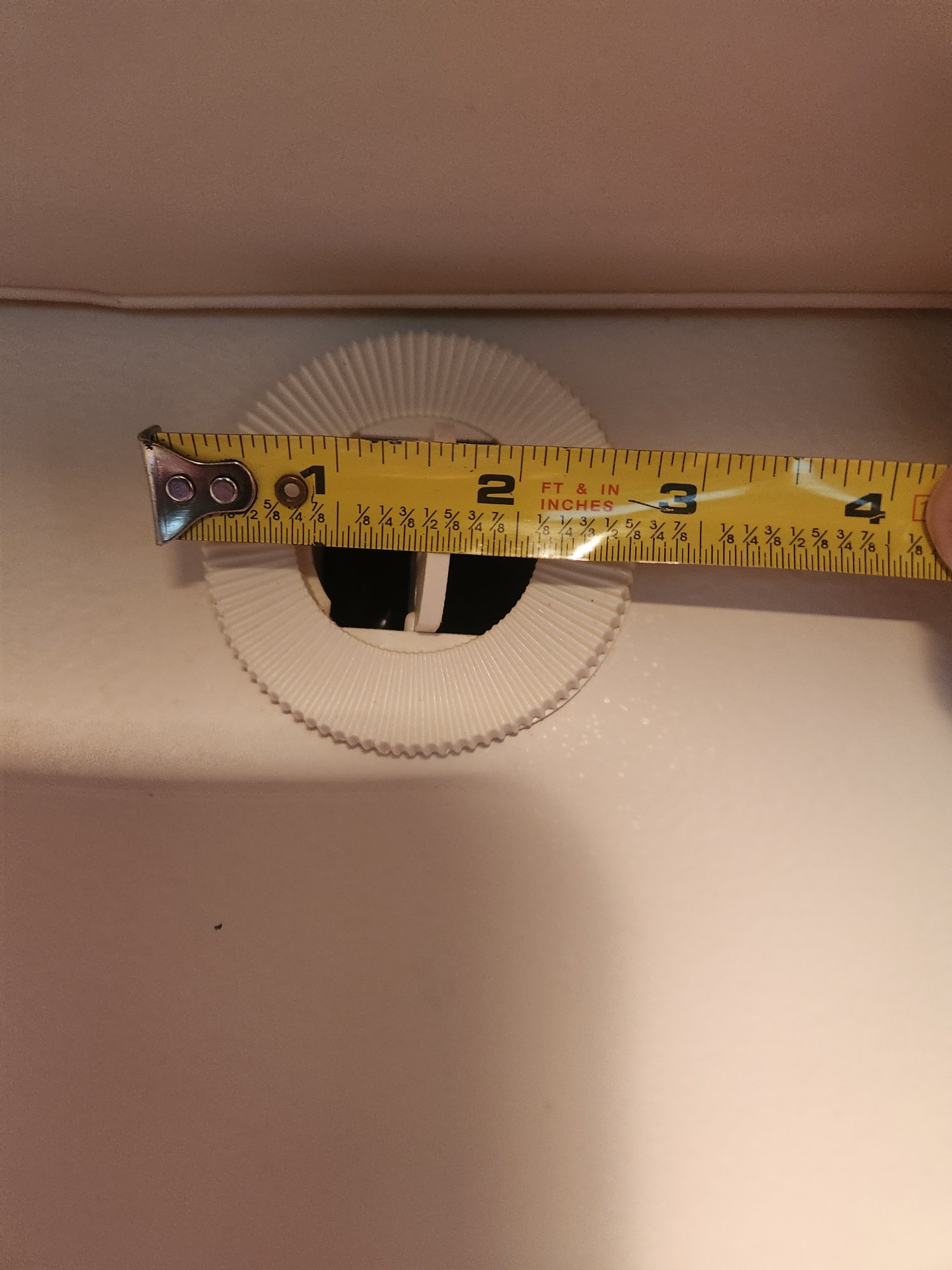

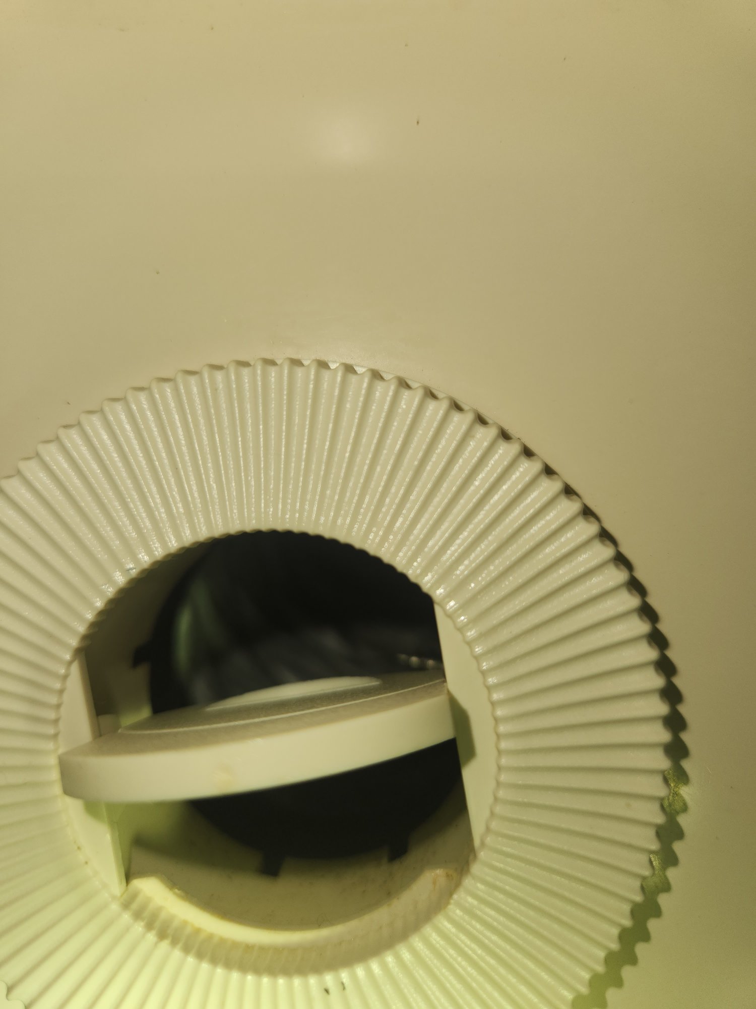

Anyone know what kind & size of duct/hose Hunter used for the small a/c vent both in the head & shower? As I recall, they used a thru hull for the outlet. Any information would be helpful as I need to add a system on my boat, which does not have any a/c to head & shower. I guess it doesn't get hot in Germany.

I see art is back ... he is correct it is a 2 inch diameter looks like dryer vent hose couldn't get a good picture but here is a coujple of shots ... sorry my answer was so slow This is my first day back on the boat if you squint real hard maybe you can see the pipe behind the vent ... the flash didn't show it and the flash light was in the way of the camera
