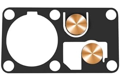

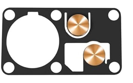

I have experienced this with Jabsco manual pumps. As Peggie suggested the easiest and I will add most reliable solution is to replace the pump.
I have fixed them a few times with varied results. There is a part similar to the attached picture. The little bronze discs get corroded. Quite sure the cam assembly referred to switches the discs. In a pinch you can take the top of the pump off, clean these up and it will work for a while. When reassembling snug the screws evenly, not tight. It is easy to warp or crack the top. Instructions can be found on-line.

PNWE36
Nov 1, 2022
55
Hunter 36e Thunderbird W. Vancouver, BC
My terminology maybe incorrect. The picture in my previous post is correct. Those round bronze things that look like discs corrode. Cleaning them with emery cloth can eliminate the symptoms described. I have never taken the time to analyze it but maybe the corrosion prevents the wet/dry switch from reaching full travel. I looked at the parts drawing on the xylem website but the detail drawing is not clear enough to see how they interact. The "discs" are part of key 21 "Top Valve Gasket" Here is the link. twist-n-lock-parts-list--2008-to-present.pdf
