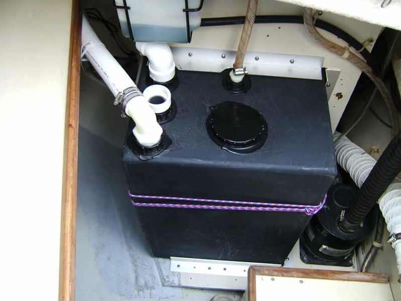

Working on the plan to install a holding tank in our 37C. Intended install will have the head discharge directly into a y-valve. One path goes to a MSD that is lower than the head, so there is no back-fill problem. The other will go to a holding tank that is a foot or so higher than the head. Just replaced the joker valve so that that will help minimize backflow from the uphill discharge.
Anything else need to be done to minimize backflow?
Anyone using a vented loop to minimize the amount of exposure (i.e. 2' of hose verses 8' of hose)?
Or is it not that big of a problem in the real world?
Thanks for input!
