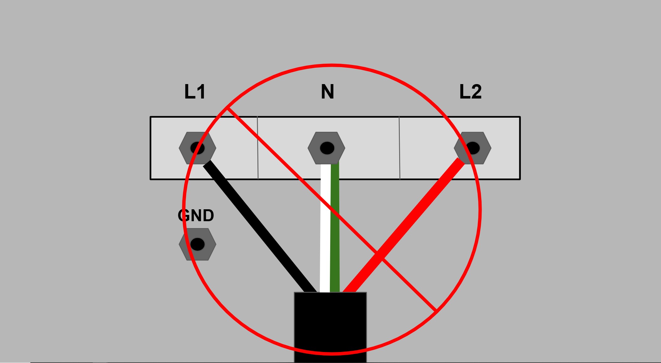

Well, here's a reason to not use ChatGPT. This information is inconsistent with my and others understanding of the AC ground wire. Here's an article that explains why. It does focus on 240v circuits however the explanations hold true for 120v circuits as well. The green ground wire is a safety wire and is not intended to be a current carrying wire except in the case of a fault. Also, they point out connecting the ground and neutral will cause GFCIs to trip (and ELCIs too).
