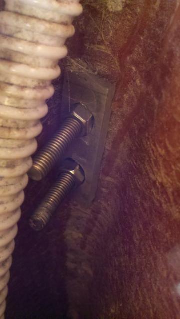

Pulling our 04' h260 onto the trailer last May I noticed the bow eye had moved rather substantially so I began to worry about how well it was installed. last weekend I wedged myself into the bow and crammed my cell phone camera into the access to see how the factory installer had done. Egads!
The holes drilled in the tiny backing plate was so over sized that the nuts(without washers of course) were nearly buried and ready to pull out the back side, and quickly through the bow. I loosened the nuts outside and backed it into the bow where I got my hand down inside and surprisingly, and rather luckily, the nuts spun right off by hand.

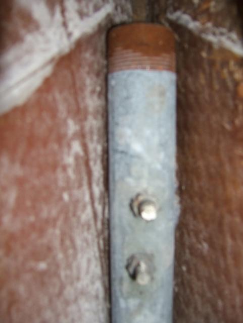

I found a piece of 3/4"x 8" galv pipe, drilled a couple 3/8" holes and rebedded the eye with 3m 5200. All together a pretty easy fix before it became an embarrassingly giant hole in the bow at the ramp while the boat drifts away. 2hrs project at zero cost. I'd highly recommend to all trailer boaters that they have their eyes checked;).

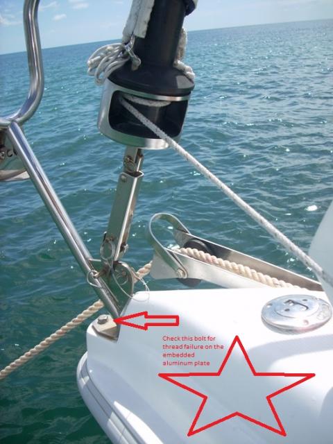

The factory backing plate on the bow eye was a mess and nearly failed. That may not be everybody's problem but why depend on questionably secured hardware. Another rub I have had with hardware is the way it's often attached with inadequate backing plates or worse, using SS bolts simply threaded into embedded aluminum plates. If it's attached w/o nuts and washers, all it takes is a few years of salt or incompatible metal corrosion and we have a completely insufficient connection that will show little sign of imminent failure of critical connections(like my solitary bow pulpit/forestay deck fastener).

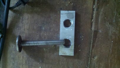

Here's a quick pic of the backing plate from my bow eye. I placed a 3/8" bolt next to it so you can judge how well the installer had done in sizing the hole to fit the bolt. The nuts were both 1/2 way through the plate when I got to it. Not exactly fine craftsmanship. It looks like he used a paddle bit to drill it.
Love the boat but most production lines don't allow for perfection so no matter what vessel you own I'd check those critical connections first and then everything else as time allows.

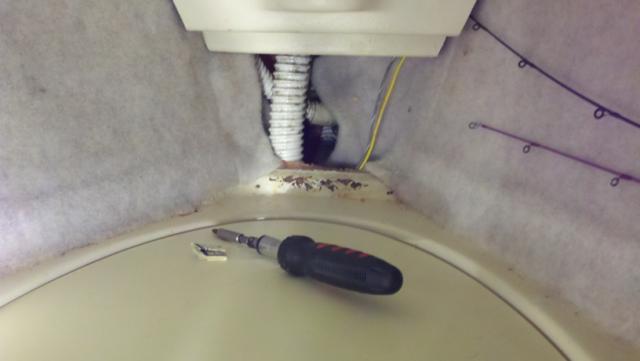

Here's my bow eye fix
I had a loose bow eye the day I brought my H26 home 6 years ago. The backing plate was a thin piece of wood.

John, Thanks for the idea, I knew I'd seen it somewhere. It fixed a hidden problem that would really bite you when you need it to hold fast.
It's all good now, Thanks again for the idea to an easy fix, Mike
