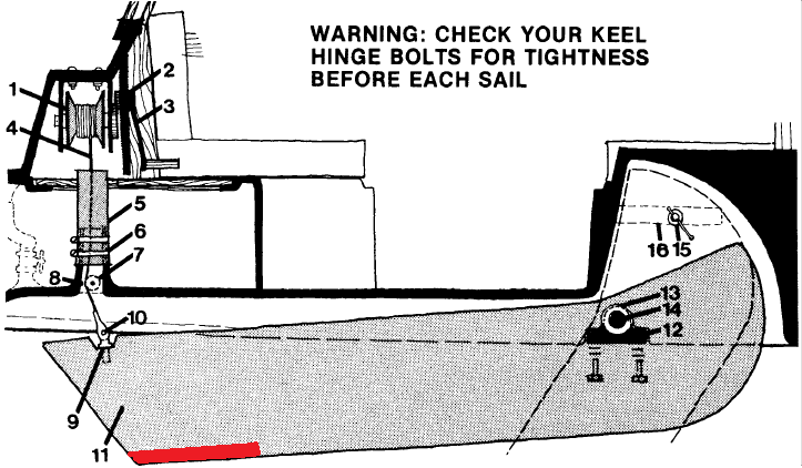

I found this schematic of a Macgregor 25 keel trunk
... and I drew in blue my ideas for two places where zincs could be attached ....
#1 position has the advantage of always being submerged and you could probably even change this zinc out with the boat on the trailer. The disadvantage of position #1 would be that you would have to expose the trailing edge of the keel's steel to weld on a bolt and then you have to close it all up again.
#2 position has the advantage of being easy. A split egg zinc could be attached in about 5 minutes.
The stud for the keel cable is already welded to the keel so no extra work involved. There are some disadvantages though. It is unclear if the zinc would be in the water when the keel is retracted. I guess it would depend on the boat you find. But if you are aware, you could raise the keel to a point where the zinc is just at the water surface, then mark the cable inside the boat. This would be your "slip" level when raising the keel.

I have a decently capable shop, my ide was to order some Zink flat bar stock, and drill a couple thru holes in it.
On the keel, I'd grind a flat and drill/tap 2 corresponding holes to mount it as the leading edge, at the lowest point.
I then mount the bar up, shape it to match the profile of the leading edge with a sanding wheel... then disassemble it all to re paint the keel. $20 will get me a few Monel cap screws big enough for the job.

That seems like a winning design to me.
