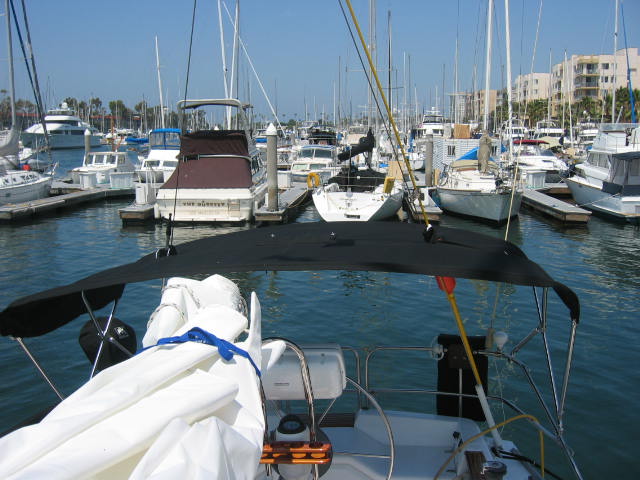

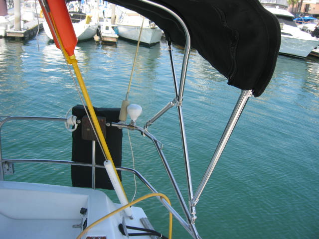

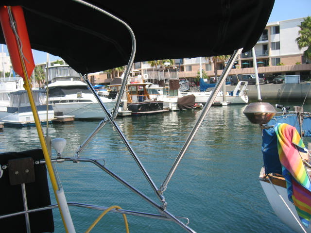

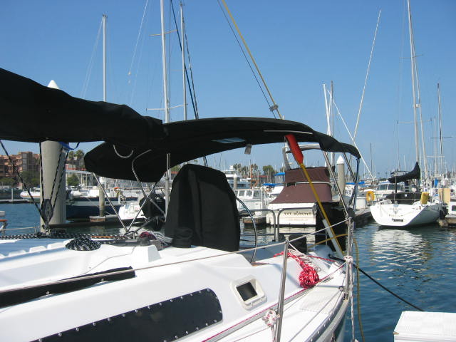

Sorry to find this thread a little late... our bimini for the 34 has a stanless steel frame designed specifically for the 34. The connecting flap and zipper can be added for an additional $40. You'd need someone local to attach the zipper to the dodger.
The Cabela's and other off-the-shelf biminis are basic, stock designs that may not work for your boat or could require substantial mods. You get an aluminum frame and the top is probably not Sunbrella. it probably won't last long. All the frames we offer are designed to accommodate winches, booms, backstays, etc. If some of your deck gear or rigging has been moved or changed, we'll work with you to create a modified frame for your boat.
Attached are photos of a recent H34 bimini we made.
