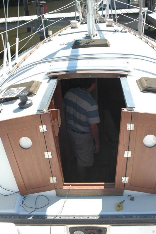

By request, here's a few older photos of my boat's companionway doors (just something I had on the hard drive). I can take better ones if it's helpful.
Because they are mounted on the face of the frame, I can still use the boards or some other insert.
My plan is to make a simple screened insert, so I can keep the doors open and keep the bugs out but still be able to close the doors if I want to. I have a soft screen secured by hook and loop tape, but it seems to always come loose and get dirty. The screened insert could also support a box fan.
I also have an insert I made that holds a small window A/C unit. This helps take the edge off on humid days but is kind of a nuisance to deal with. I don't use it too often...

Nice!
Except now I see yet another difference between the newer and older deck molds - on my boat the wood 'sliders' are recessed back about 3", meaning that the doors would not fold back flat but would stick out at 90 degrees :-(

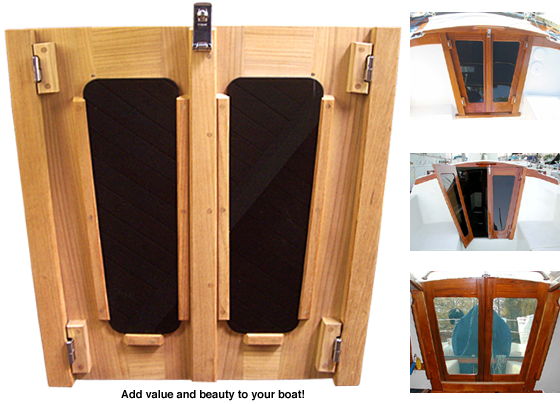

Oct 25, 2008
74
Hunter 37 Cutter, 1980 Solomons, MD
Nice!
Other boats with this same sort of protected companionway or having other obstructions have lift-off hinges, so if you want the doors open but know they will get in the way the door panels would be stowed.
http://www.cruisingconcepts.com/Codoor.htm
