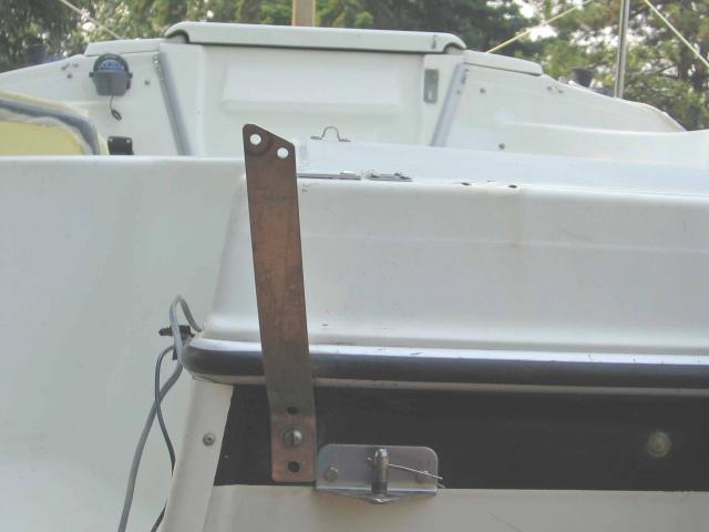

I have another problem. The rear backstay anchor plate is mounted outside the laz. on the portside of the upper rudder mount pin. causing a great deal of mast bounce under sailI. I noticed on your photos that it is mounted inside the Laz. about 20 inches from the starbd side of of the boat, off the center line with only 2 inched of the anchor plate showing. This is where it may have been mounted as there is silicon filling the slot and holes that were there. Why is it off center? Hope you can help

My 26S also has the backstay chainplate inside the lazarette to the starboard side of the rudder post. All of the 26s models I've seen are that way, I've not seen a 26D that close. On the S, and probably the D, the chainplate is offset from the center so it will not interfere with lifting the tiller to open the lazarette. If it is adequately mounted on the port side, with adequate backing, its probably okay; if there is any doubt, I would move it back to the original position. You mention mast bouncing- if your backstay is too loose, tighten it just enough to eliminate the slack when the sail is not loaded. Good luck- I know you will enjoy your boat when you get it fixed up. -Paul

Hi Paul Now I understand. I tried to att. photo hope it worked. This will show you why I got the mast bounce from the external anchor. The Laz door had be altered to open sideways. Messy mod.

Picture is good, Mic. I cannot guess why the PO did this, as I don't see any improvement to the backstay, the lazarette, or the tiller! Certainly that springy chain plate gives little support to the mast until the mast bends enough to straighten the chain plate. Over time, this constant flexing will likely cause a fatigue failure in the chain plate, which could cause damage to your mast. I think I would put it back in the original position.
