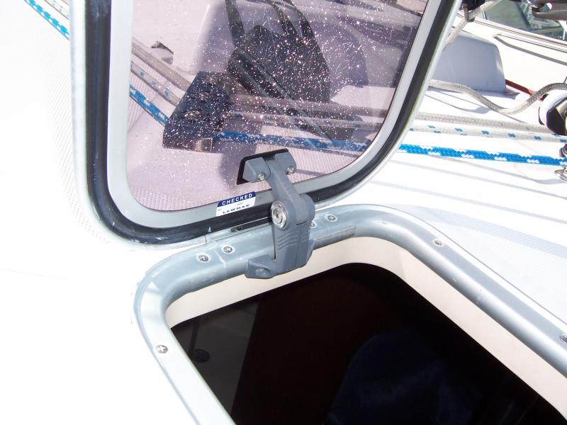

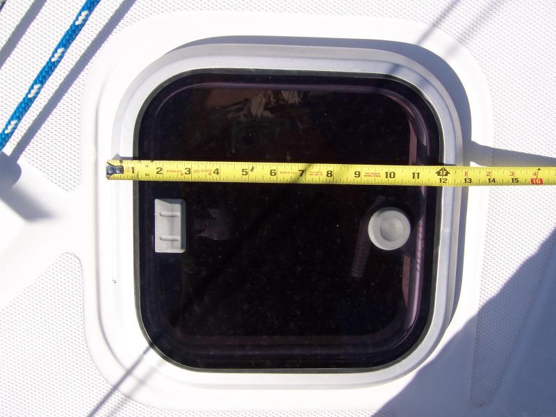

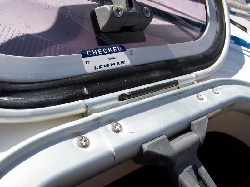

If I understand you correctly, it's the upper part of the hatch that looks like a fish truck refrigeration unit and has to go. Below is a shot of one of my hatches (Lewmar 13 X 13) as I was removing the upper portion in order to replace the lens. The hinges came off quite easily. If you can find the make and model of yours existing hatch, perhaps you can use the top portion only to replace yours and forget removing the frame which is attached to the deck. Often the bottom portion is in good shape as its completely covered and there's no advantage in replacing it if not required.
This goes against my cheaper nature (wasting anything) but it will give you a near perfect job without the work of removing the lower frame.

I want to find that 13"X15" hatch cover out there to make my task as easy as possible.
Lewmar and Bomar are the only common manufacturers that I know of.
Hatch sizes are measured on the outer frame dimensions, which the PO discarded in his infinite wisdom, so are you able to get the correct dimensions of the required hatch ? Just a guess and had to ask.
