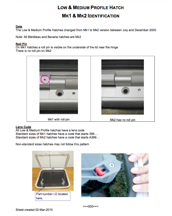

My 310 is a year 2000. This has probably been discussed before on this forum but I need to replace both of my my hatch lens and the gaskets. Has any one replaced theirs? I don't want to send the hatch to Hatch Masters if I don't have to. Does any one know if our hatches are Lewmar? The first thing I need to know if I want to do it myself is if the lens is a low profile MK2 hatch. The second thing, is the replacement difficult to do if the hatch is a Lewmar MK2 Low Profile hatch and I buy a Hatch Masters replacement kit? Also, anyone know if there is a U-Tube video on a Hatch Masters lens replacement?
